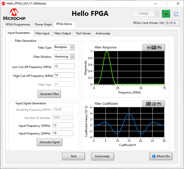

This particular demonstration is actually the first one - the digital signal processing demo which requests the FPGA to generate a challenge signal or sweep, filtered by a DSP filter also generated by the application and implemented in the FPGA, plotting the response.
As far as demonstrations go, this first demonstration is a little underwhelming as the filter is very simple and there really isn't any way to test it based on a dynamic input. While the demonstration does provide a power figure, there seems to be no convenient way to actually measure this.

    Unfortunately, I don't think there is any way to get the signals from the demo as everything is being done in the digital domain. From what I can tell, the demonstration app passes the request to configure the filter and the test frequency to the board as commands over the USB-Serial and then it's down to the FPGA to internally generate the digital samples that would represent the signal (imagine the raw bits you would get from an ADC), perform the FIR filter math on the digital representation and then "measure" the intensity by performing an FFT on the digital representation of the filtered result. The intensity is what is returned back over to the demo, and it's a shame they didn't use units of dB as that would be much more instructive (at least for SDR-tinkering radio folk).
    That being said, if one were to build their own FPGA bitstream through actually designing something in Libero, then perhaps it may be possible to designate some pins to perform a high-rate interface (e.g. SERDES, SPI) to get actual dynamic data in and out of the FPGA. However, the board is probably not made to handle SERDES as that's at a high rate, and the UART to USB converter certainly is going to be a limitation (it's unlikely to work well at rates above 1Mbit/s in general, but I haven't looked into it closely, as it seems to be talking to the PIC32 which is then talking to the FPGA). Otherwise then perhaps you might want to hook your own ADC/DAC to it, but this board isn't ideal for that either - the majority of serious FPGA prototyping boards would use an FMC interface instead as that is designed for the higher-speed differential signalling. Interestingly, this one doesn't seem to have a PMOD connector which is another common expansion interface used with FPGA prototyping boards, but I suppose the Arduino footprint and mikroBUS provide the same functionality for the most part.
    That being said, it could potentially serve quite interesting test applications - e.g. if you use the FPGA to generate signals using direct digital synthesis (DDS) and an off-chip filter, or if you just use it as a programmable variable square-wave clock synthesiser. I have thought about having one of them around, if anything, just to test certain other equipment ... but will I ever find the time?
