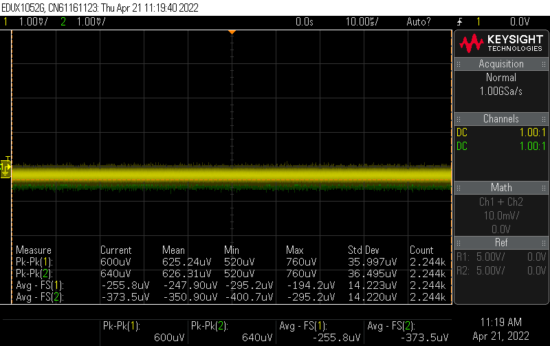

DSO Channel Noise
One thing I noticed when attempting to measure the oscilloscope channel input noise was that I had the input bandwidth limited somehow. It turns out this was a case of not reading the fine-print, as it seems using the lowest vertical scale automatically engages the bandwidth limiting function. Repeating the test at the next-lowest vertical scale provides a more accurate representation of the front-end’s capabilities which is a little bit noisier, but seemingly in the expected ballpark (~625uV p-p at 1:1, which would translate to 6.25mV p-p for 10:1).

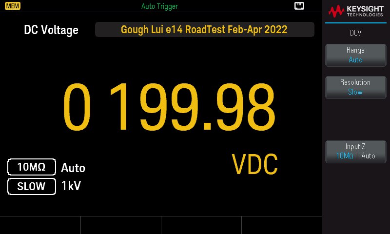

The DMM is the most precise instrument of the suite, and was completely torn apart in my review, so it would be nice to see just if the adventure had ruined the DMM for good, or if I got lucky with my careful tinkering. To do this, I repeated the calibration checks that I performed in the instrument performance test chapter.
image image

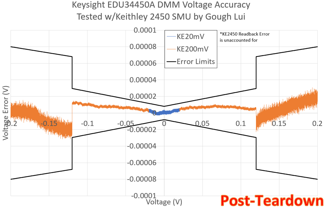

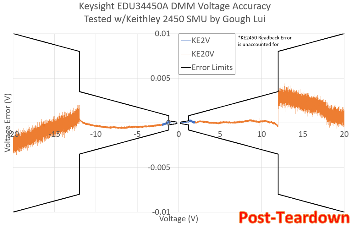

Voltage accuracy appears to be within specifications and is quite similar to the result pre-teardown.
image image

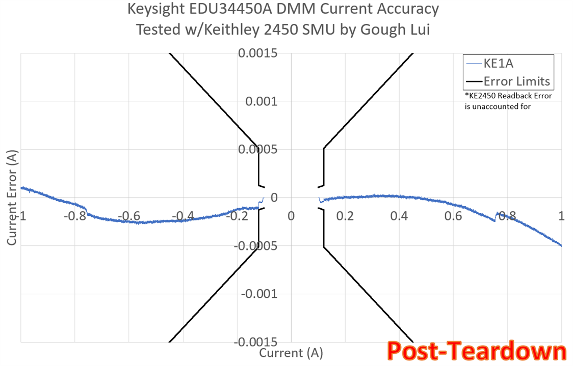

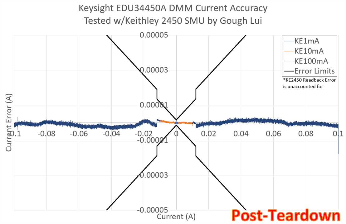

Similarly, current accuracy seems to be well within specifications and is marginally better than before the teardown! Perhaps I managed to improve the meter, or perhaps the slight difference in test temperatures affected the result, but it seems the meter has not really suffered as a result of the teardown.

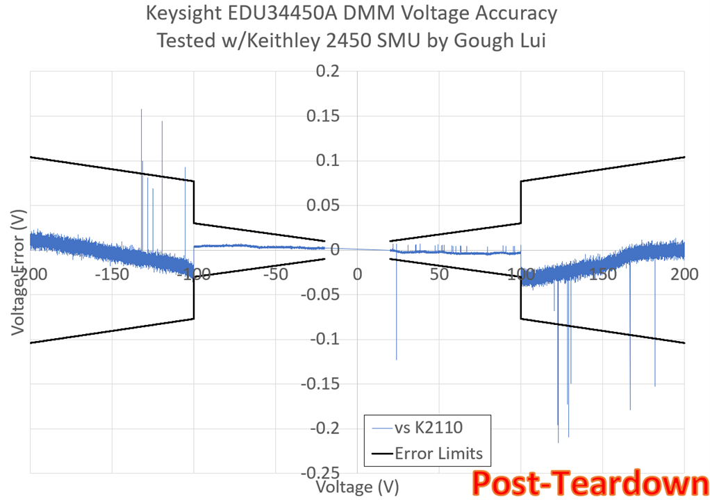

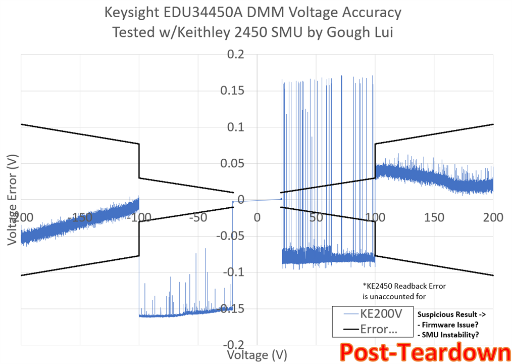

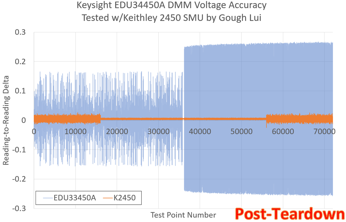

One aspect of the performance and calibration that I did not post about in the original review is that of the 100V/1000V range which I tried to test using the Keithley 2450 SMU as the results appeared anomalous. The first thing I decided to do was to check my code and repeat the experiment post-teardown just to see if the result got any better.

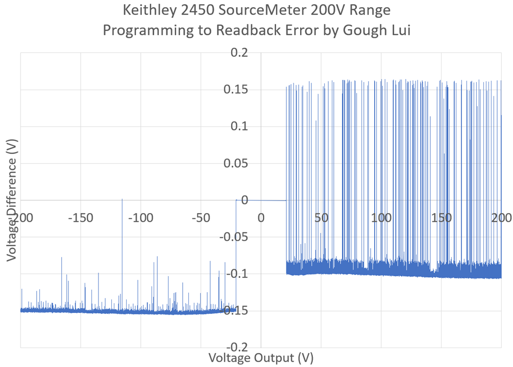

The result I obtained was this noisy and confusing plot which seemed to suggest the reading was very noisy and differs depending on the voltage being positive or negative. However, a quick examination seems to suggest this result is not because of the Keysight EDU34450A.
image image

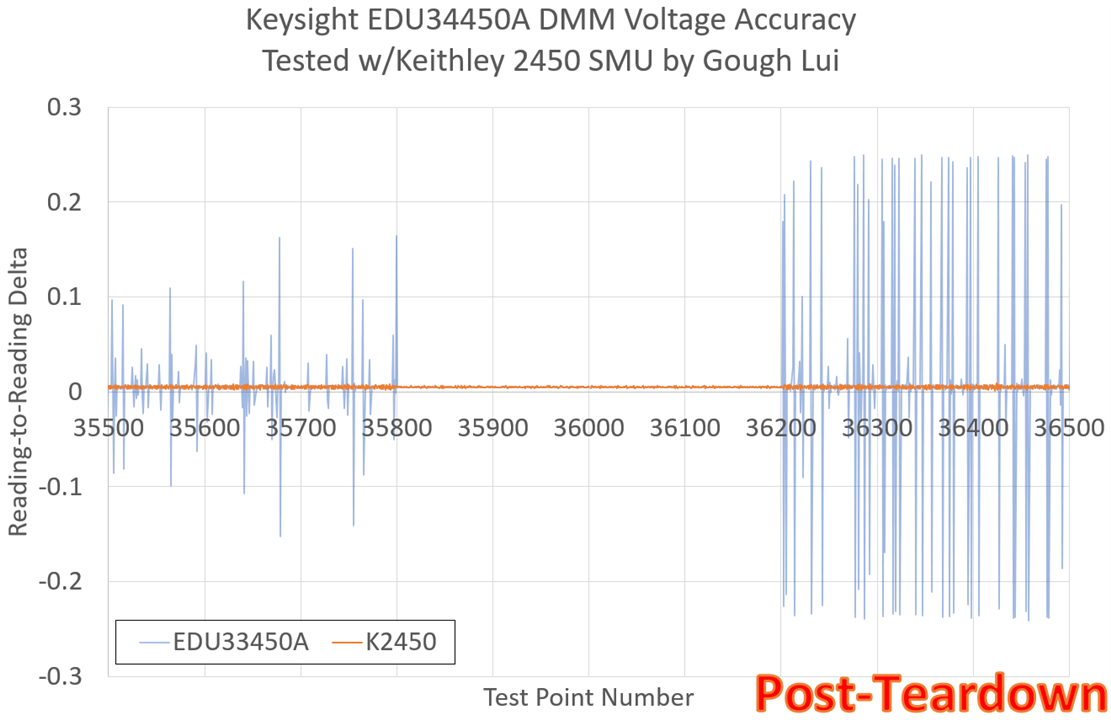

I took the SMU’s read-back values and took the delta between two steps. This should result in a constant value (or very close to it). Instead, it did not, and had a spiky amplitude of about 0.25V in the positive part. Looking into the middle values, it can be seen that the spikes seem to quiet down – this corresponds to the 20V range values, with the spikes appearing in the 200V range data only. Doing the same with the DMM data in orange, showed no such spikes!
Given that I previously had to send the Keithley 2450 SourceMeter back to the USA at my cost for repair and recalibration because of a manufacturing issue, it seems the 200V range on my unit seems prone to be problematic. It’s not even been two years since the repair!
Perhaps this is not fatal, I thought, so I turned off the 2450, let it cool down and switched it back on to re-run the experiment. This time, there were fewer spikes, but the same issue cropped up again.
The strange thing was that the result on the DMM seemed to match the requested value from the SMU, but the SMU was not measuring its output correctly. Perhaps this is a sign that the SMU was unstable and oscillating.
Plotting the programming minus readback value shows just how out-of-whack the SMU’s own metering seems to think it is. But I’m convinced that the output is pretty much correct in-spite of this. I could just plot the EDU34450A’s reading versus the programmed SMU value, but that would not necessarily be correct.
Nevertheless, I decided to give it one more try, but this time I would manually switch the DMM’s and SMU’s ranges rather than letting them auto-range and also bring in the Keithley 2110 5.5-digit DMM as a second-opinion just to be sure.
This time, the same spiky behaviour is seen between 20-100V output, but when the DMMs were manually kicked over to 1000V range, it seems the SMU may have settled down just fine and the values became in-range again.
Comparing the measurements from the EDU34450A and the requested value from the SMU gives a good image showing the readings are within the datasheet specification limits.
Comparing the readings from the EDU34450A and the Keithley 2110 5.5-digit DMM gives a very similar answer – it is pretty much within specification. The reading from the Keithley 2110 does have a few spikes here and there – perhaps the SMU really was oscillating, or the 2+m test leads were picking up some impulse noise.
In the end, the Keysight EDU34450A digital multimeter was just fine after the teardown, and it seems that even up to 200V, the readings are within the specified accuracy. Instead, it discovered that my Keithley 2450 SourceMeter was misbehaving – a regrettable outcome I did not expect. I will need to be more careful of using the 200V range on that unit from now on – it just doesn’t seem to be all that reliable … at least with the metering.

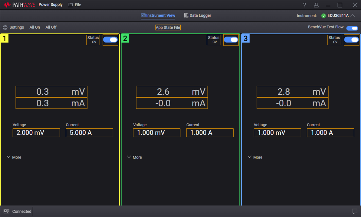

I first tried the Power Supply app which seems to now sport BenchVue TestFlow integration without the need to find it in a “hidden” menu. Now, once enabled, it highlights certain sections of the screen in orange to indicate controls which can be connected to TestFlow. Unfortunately, I was not able to make this connection work – dragging and dropping some blocks allowed them to appear in the flow, but I couldn’t get the output switch blocks to work at all.
image image
Attempting to run the flow also results in an error connecting to the instrument. Perhaps somehow my BenchVue and PathWave BenchVue just can’t talk to one another … but I don’t believe I have anything specific to my installation that would stop it (e.g. a firewall).
There was a subtle change to the green “tick” icon when an instrument is connected, although this is mostly inconsequential. The graphing module apparently has been improved too, but I still find it awkward to use.

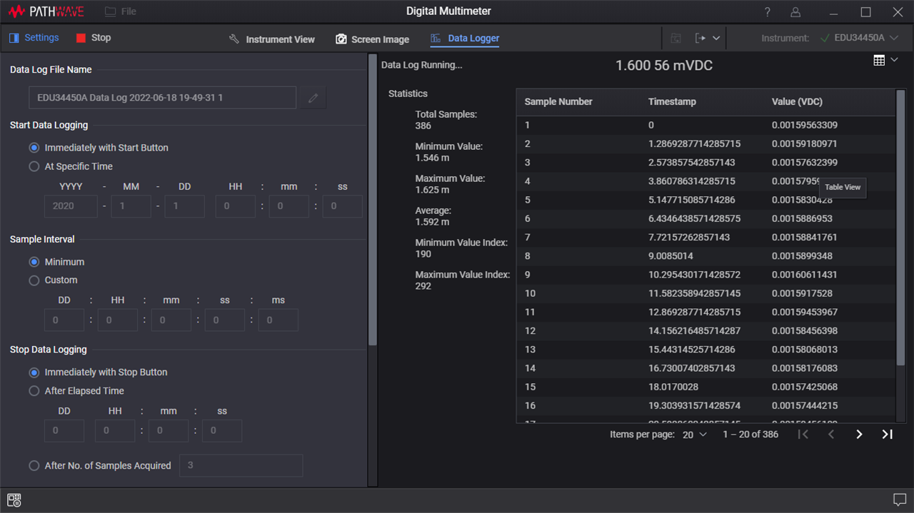

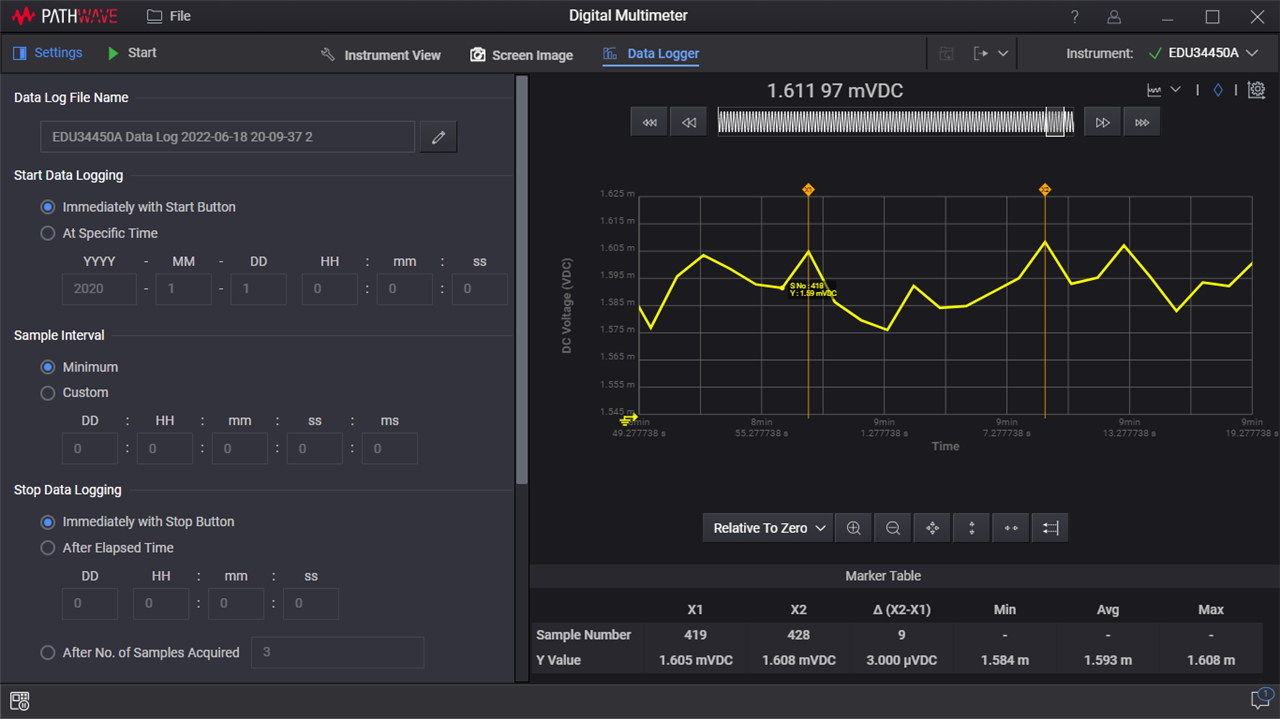

The Digital Multimeter app looks pretty similar – perhaps I missed it before but it seems there is a data table option. Unfortunately, using the graphing while it is logging is still relatively slow and the timing figures seem to dance around for the existing datapoints which are already logged, which doesn’t make sense to me.
image image
Perhaps a new improvement is the cursors, but I still find the graphing to be relatively tricky to navigate and use effectively compared to exporting data for a third-party tool to analyse. It doesn’t seem BenchVue TestFlow integration has made it to the Digital Multimeter app just yet.
One thing I did notice if I ever used the data-logging functionality on the DMM was that the data doesn’t seem to be able to be cleared from the instrument, so the MEM indicator stays on the screen.
Unfortunately, the BenchVue app doesn’t seem to interact with the memory on the DMM, and there is no web-based SCPI terminal, so the only way to clear it is to issue DATA:DEL NVMEM from the I/O Suite or a VISA program of your own.
