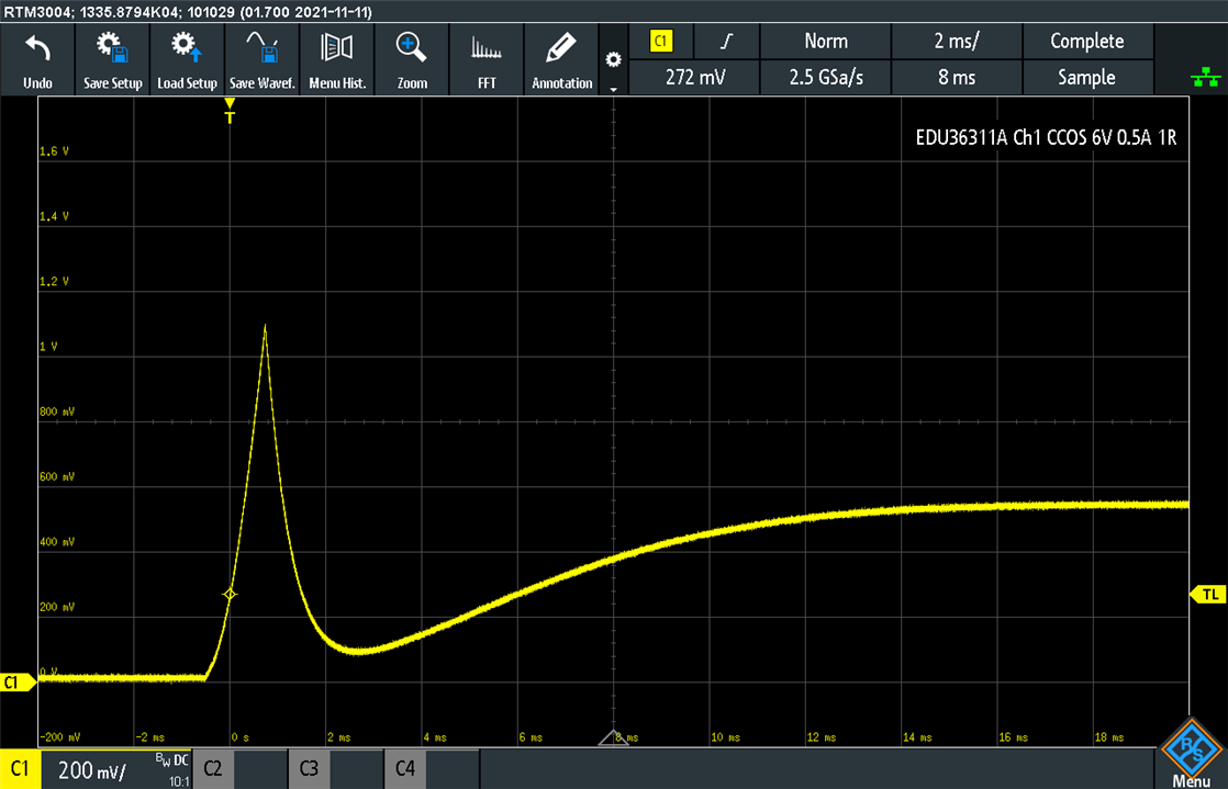

Overshoot into CC
Powering up a channel into a load which you expect to be regulated in constant current mode is a good test of the regulation performance of a power supply and gives an idea of the likelihood that the supply may inadvertently cause damage to current-sensitive components with poorly chosen voltages.
For this test, I chose to use a non-inductive 1-ohm resistor with a current setpoint of 0.5A which we would expect to operate around 0.5V. The voltage is set to the maximum for the range to provoke overshoot behaviour, if present.
Testing Channel 1, it seems that overshoot is present, reaching a peak of 1.1A and having a transient above 0.5V of about 1.2ms. It seems the regulation loop is a little “behind” at the power up, but it falls into regulation by about 16ms after channel activation. This is not ideal behaviour, but there are much worse examples for power supplies in this class, so I’d have to give it a pass.
The other two channels seem to be much better tuned, smoothly coming up to the load without any overshoot. I suppose with a more limited current range, it can be a bit more conservative with rise time which allows enough time for the regulation loop to smoothly adjust the output. This is what I would expect from a good power supply – so if students are doing experiments with LEDs, perhaps using Channel 2 or Channel 3 is advisable.

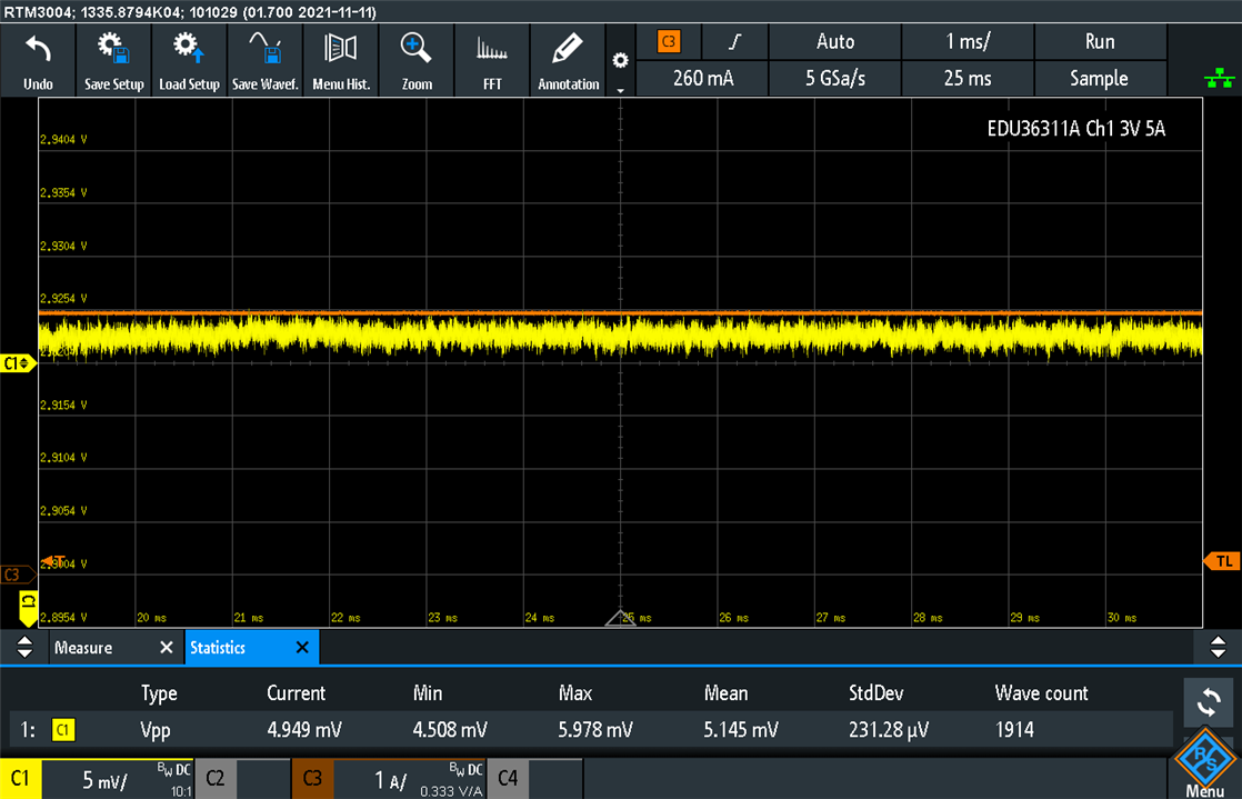

Ripple and Noise
Ripple and noise was measured with a constant-current load of the maximum rating for the channel, at half the rated channel voltage, generated from the B&K Precision Model 8600 DC Electronic Load. Measurements were made using a passive 10:1 probe on the Rohde & Schwarz RTM3004 Oscilloscope with 20MHz bandwidth limit engaged.
The ripple and noise figure measured for Channel 1 an average of 5.145mV peak-to-peak which is good and is fairly close to the noise floor of the channel input. This is practically spot-on with the 5mV peak-to-peak rating in the datasheet.
Repeating the same for Channel 2 resulted in an average of 5.831mV peak-to-peak, which is again a good result and fairly close to the noise floor of the equipment. It is very much within the same ballpark as the 5mV peak-to-peak claim in the datasheet – the discrepancy may be due to the frequency range of the datasheet measurement (20Hz – 20MHz) as this includes the DC “drift” element as well (0Hz – 20MHz).

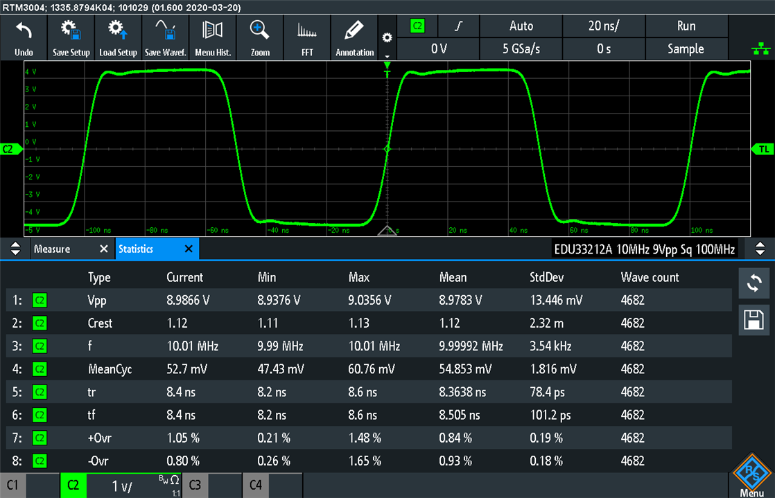

Time-Domain Parameters
An easy test of a waveform generator is simply to hook it up to an oscilloscope and look at the quality of its output. I tested a few things with the Rohde & Schwarz RTM3004 Oscilloscope before moving onto more stringent tests.
Asking the EDU33212A to generate a 20MHz (maximum) sine wave with an amplitude of 9.5V peak-to-peak (near the maximum of 10V) into a 50-ohm termination of the oscilloscope is just about the worst-case scenario. Regardless, the output seemed nice and stable and the measured parameters are within range, especially considering both the EDU33212A and RTM3004’s accuracy specifications.
A more challenging test is to generate a square wave. The EDU33212A limits this to 10MHz, but the resulting waveform is still pleasingly near-square without significant ringing at the transitions. I think this is a pretty good result overall.
I also tested the synchronisation between channels – the RTM3004 said they were within about 1.09° or 303.8ps, well within the <800ps specification.

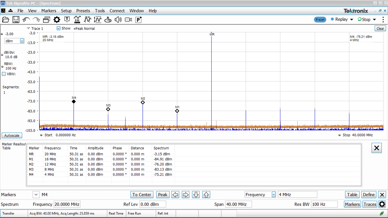

Harmonic/Noise Emissions
To test harmonic and non-harmonic noise emissions, I first tested the background noise with the AWG powered down.
The spectra reads about -99dBm across the range and is relatively flat.
image image
Generating a sine wave at 20MHz, the (sub-)harmonic components were measured at 4MHz intervals, peaking about -72dBc which is very good and slightly better than the specifications would imply.
Non-harmonic components were identified and were at an even lower level of about -85dBc which is excellent.

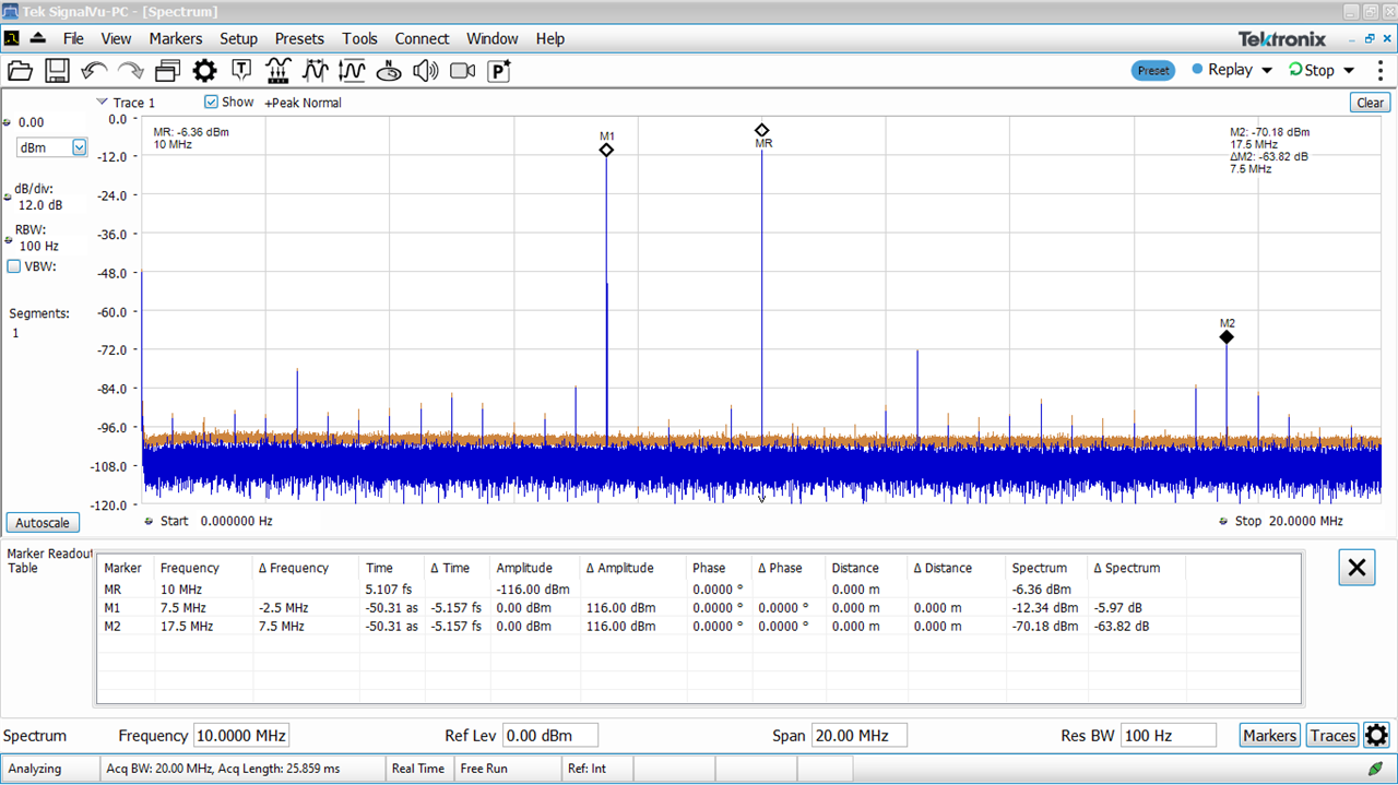

Intermodulation Test
I tested intermodulation by having a 10MHz sine wave and a 7.5MHz sine wave generated by the two channels using the combine mode.
The output looked as above, with the highest spurious measurement at 17.5MHz measuring about -64dBc. This is not as impressive, but given the equipment I am measuring with, still suggests good performance overall from the AWG.
