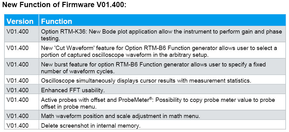

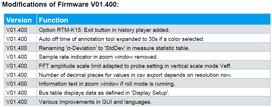

According to the changelog document, the new firmware includes the following changes:
Some of the changes do directly address the issues I had identified, although the lack of detail in the changelog (e.g. “Various improvements in GUI and languages”) makes it a little difficult to identify precisely what had been done. The biggest issues in my opinion relate to those labelled “firmware blocker” which caused the unit to lock-up when those operations were performed.

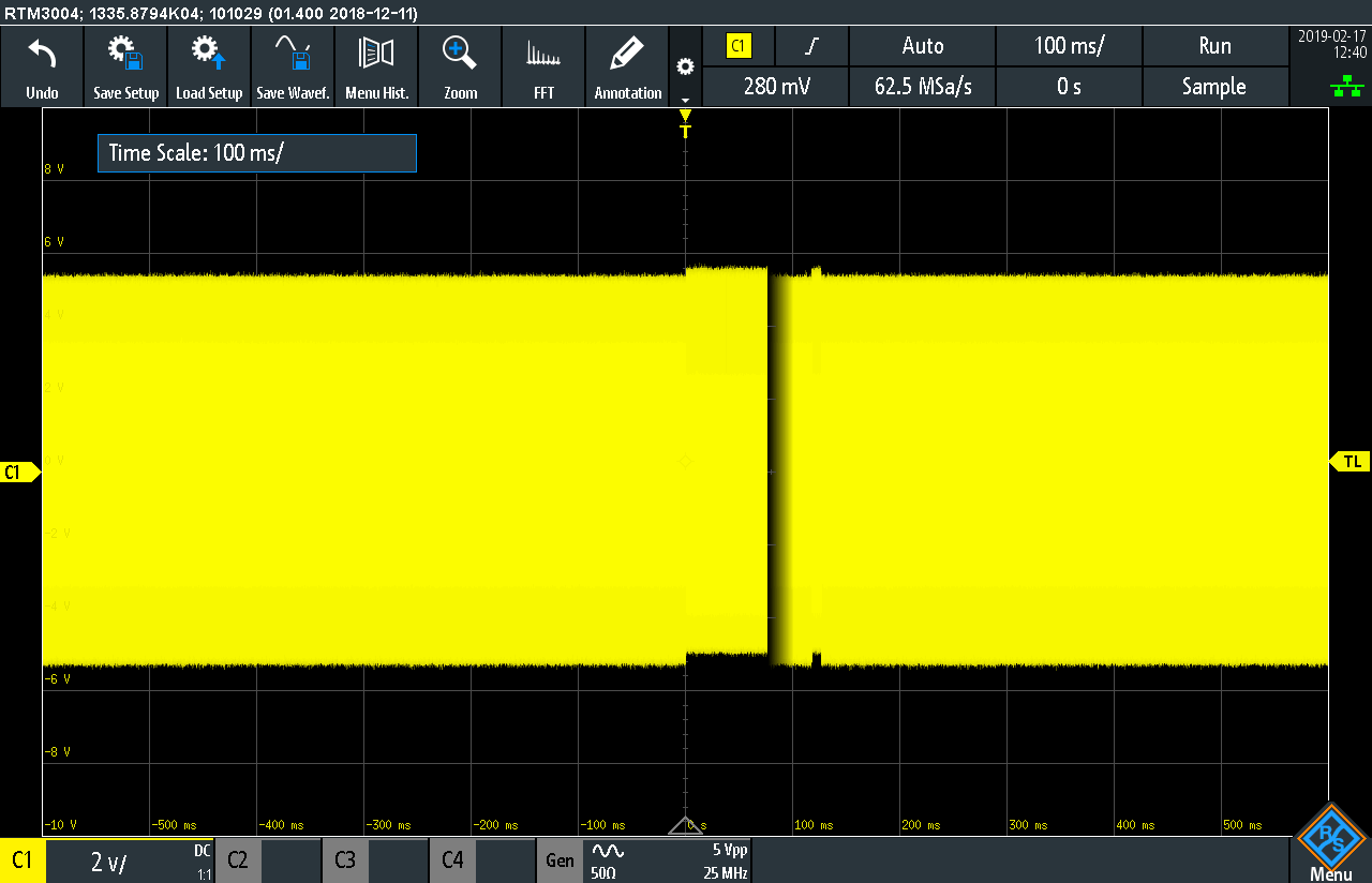

  • Aliasing would occur at longer timebases with a high-frequency signal even with sufficient sampling rate or using peak-detect modes – now fixed and displays the right result.

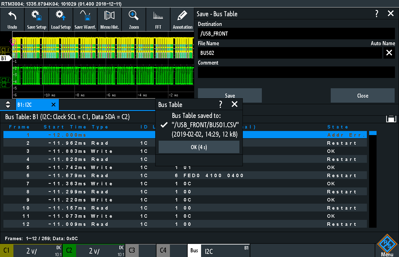

  • Exporting Visible Channels or Bus Table export with more than one line would cause lock-up – now fixed and improved with a save progress containing estimated time.

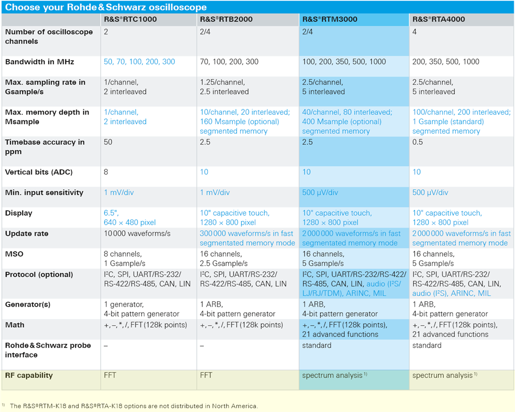

Unfortunately, it seems that access to the K18 Spectrum Analysis feature is still restricted in North American markets according to the current brochure.

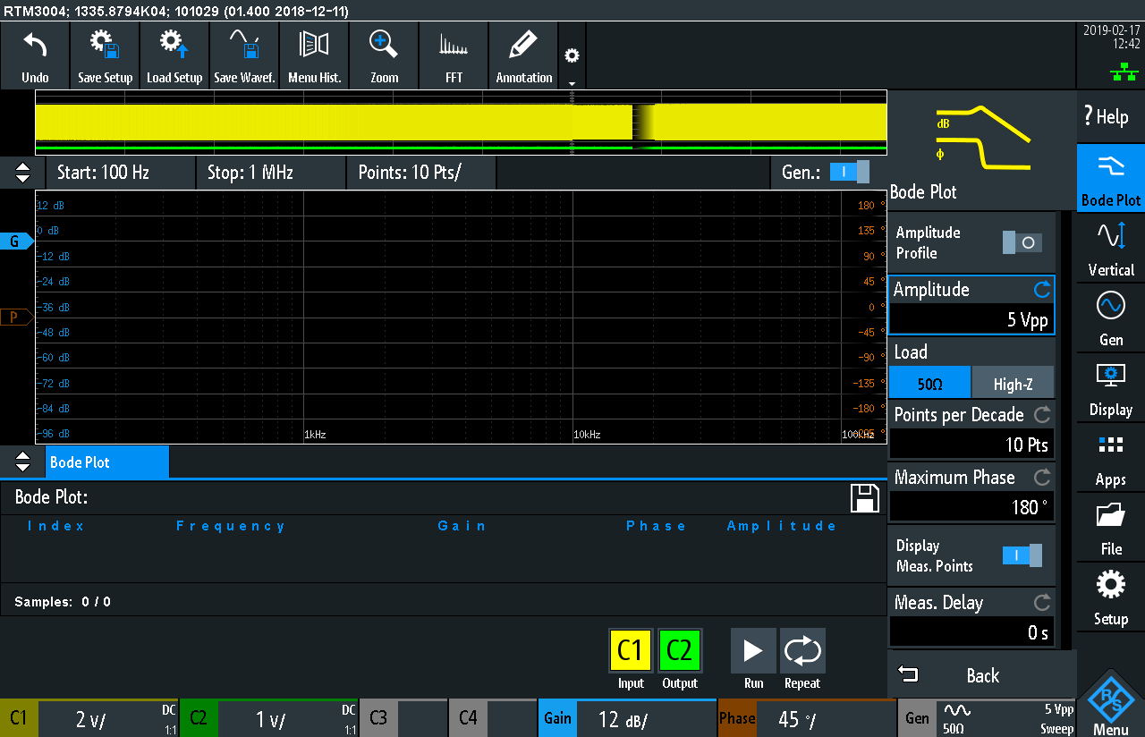

Configuration
The bode plot module has a number of configuration options which are relatively self-explanatory.
By default, the bode plot can be run in fixed amplitude mode. The load option controls the signal generator settings, with the points-per-decade being configurable to provide a test-speed/plot-detail trade-off. The maximum phase is configurable, along with a measurement delay. The start and stop frequencies can be configured by tapping on the fields above the bode plot.
If the amplitude profile option is turned on, up to 16 profile points can be defined as pairs of frequency and amplitude for more fine-grained control of testing parameters.
Tests can be run from the screen or via network remote front panel control (as above). The plot is drawn as the test runs, with a progress bar in the top right giving a good indication as to test progress.

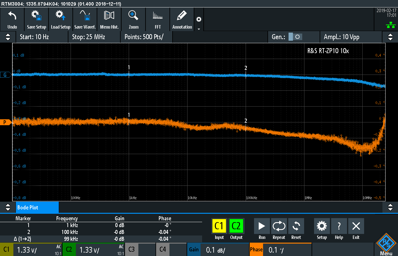

The second check was to see what the result of a direct connection of C1 and C2 is – using the two passive probes (if properly compensated) should show a flat profile in amplitude and phase.
While it’s not completely flat, the amplitude deviation between the two probes is <0.1dB and the phase deviation is about 0.2°. That is a lot better than the claimed <1dB and <5°, thus giving me a bit more confidence in the results.

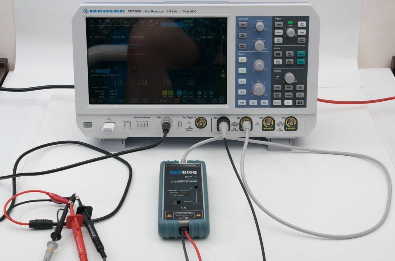

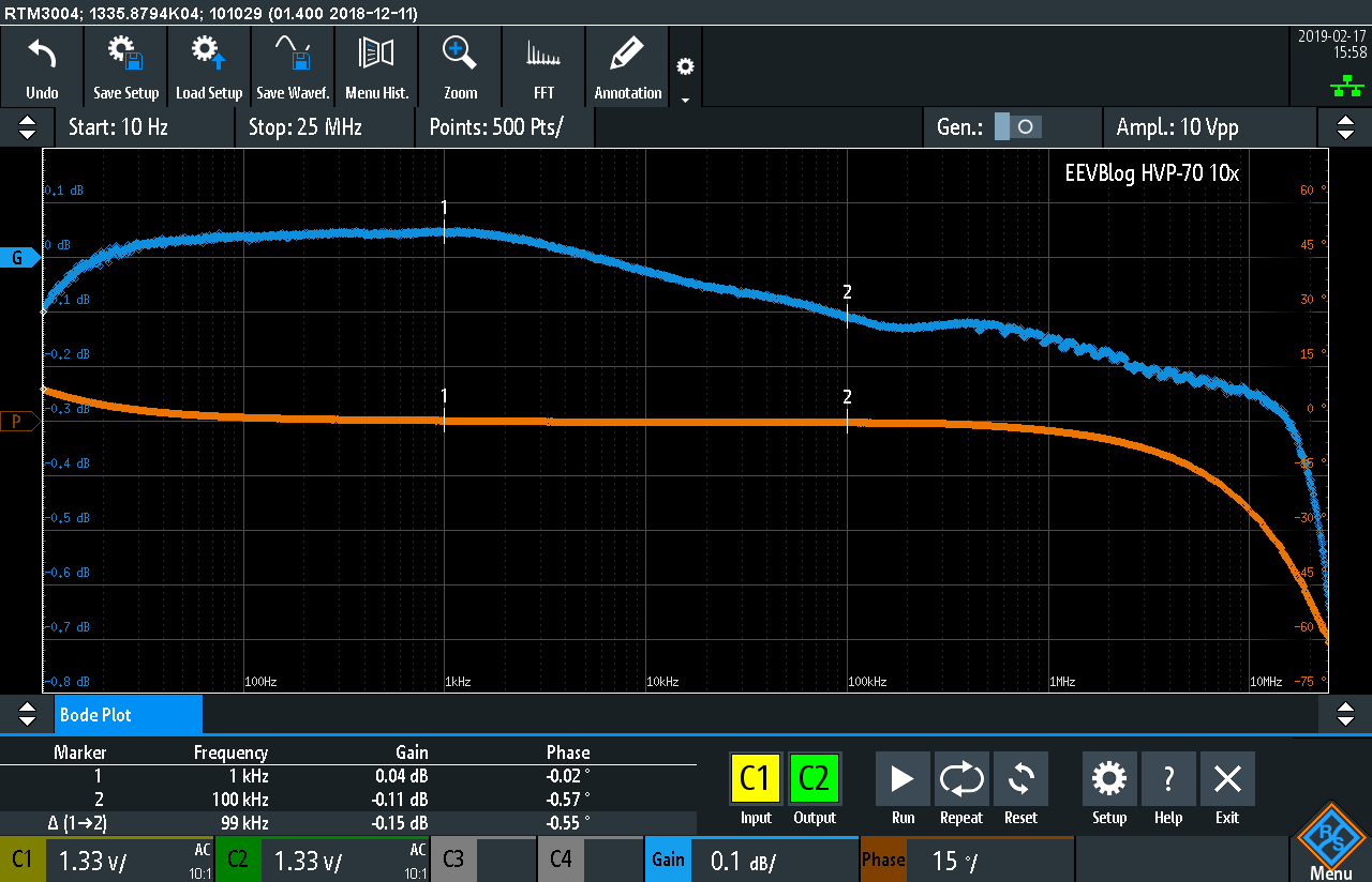

I recently acquired two high-voltage differential probes and did some basic testing for a review. One thing I did not test was the frequency response. While the HVP-70 claims 70Mhz and the Micsig DP10013 claims 100Mhz which are both far in excess of the 25Mhz capability of the K36 option, I still thought it would be good to test their frequency response characteristics anyway.

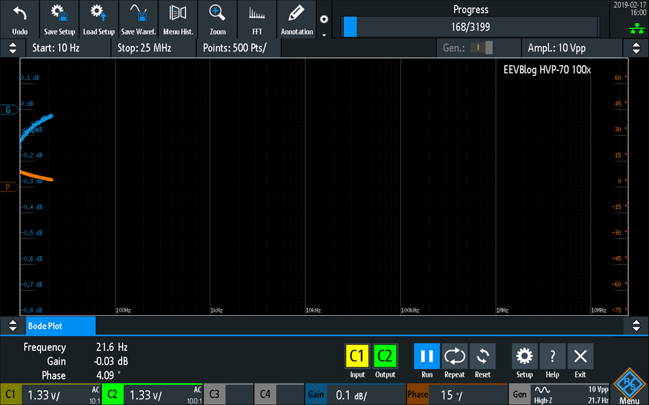

With the EEVBlog HVP-70 in the 10x position, the frequency response is generally quite good, measuring within around 0.1dB up to 100kHz, deviating by <1dB up to 25MHz. The phase is mostly around 0, deviating above 1Mhz. This might not be too surprising as the HVP-70 was similar in design to a 25Mhz unit from Sapphire.
At 100x, the performance was a little less consistent, deviating by a maximum around 1.2dB, but this is still well within expectations and still mostly smaller than the claimed margins of gain error.

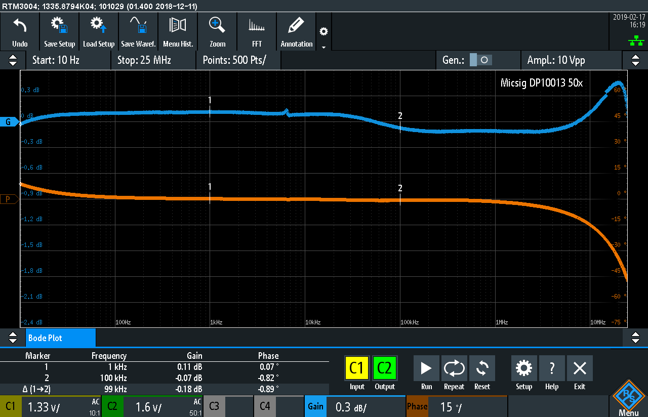

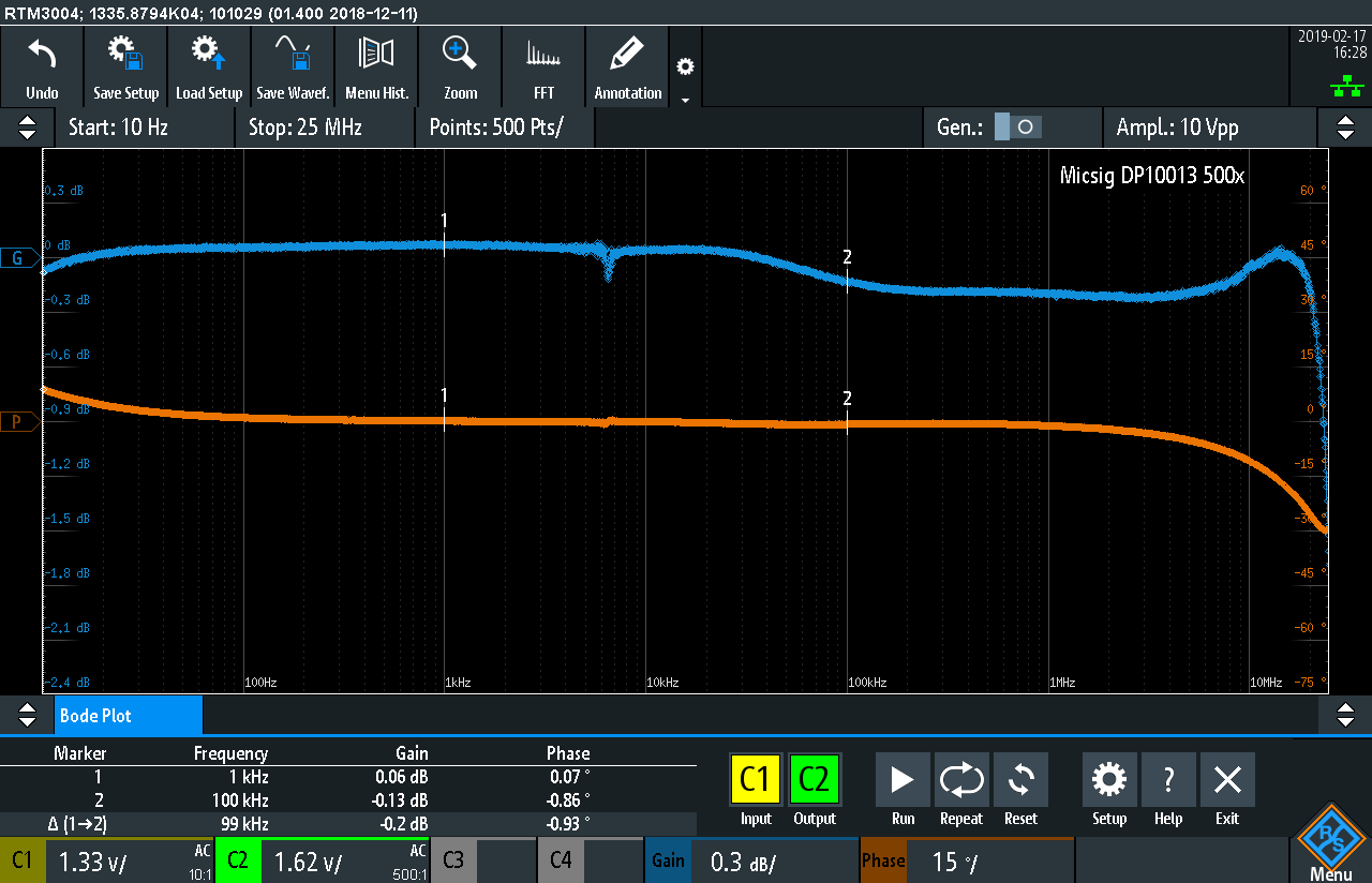

The Micsig was much more interesting, while attempting to be flat, there is actually quite a bit of deviation upwards at higher frequencies as if it’s an attempt to boost the upper frequencies.
At 500x, the bump is less pronounced, although the response deviation seems a little greater. I’m not sure why but the horizontal grid-lines disappeared from this screenshot.

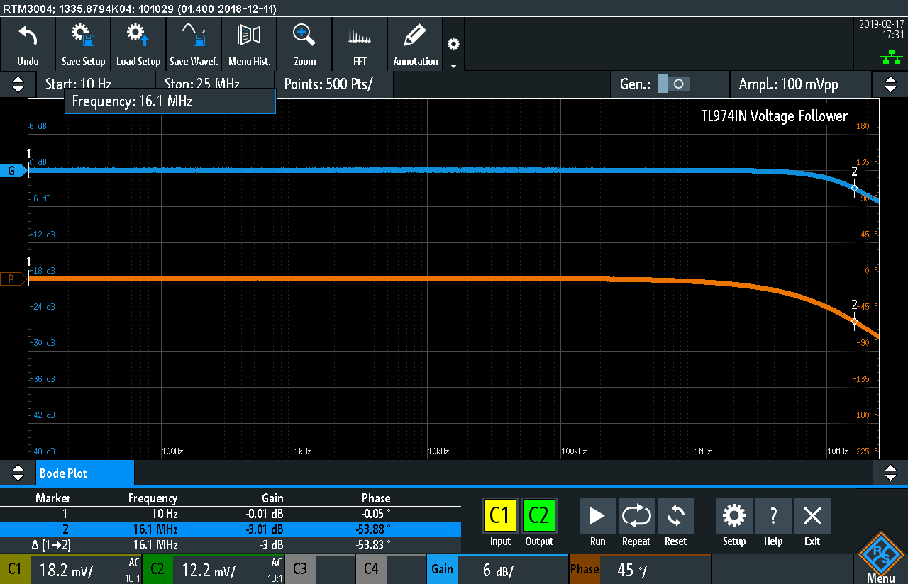

Speaking of which, I decided to give a quick test of a Texas Instruments TL974INTL974IN opamp configured as a voltage follower to attempt to measure the gain-bandwidth product directly.
As the opamp is a rail-to-rail type, I powered it from a single ended 0-5V supply. To properly drive this, a virtual ‘ground’ needs to be established, but instead of doing so, the easier way to be to input a signal with an offset of 2.5V to centre it within the supply range. While not obvious, you can call up the “Gen” menu and set the offset which will be retained during the bode plot test – this allows you to have an AC signal on a DC bias as the test source.
In the case of the above, the voltage follower drops off before even 1MHz. Why? Well, it’s slew rate limited by the 3.3V p-p signal it’s attempting to follow.
Dropping the signal to 0.1V p-p, the 3dB point is 16.1MHz which is quite respectable. The unit is expected to measure around 12MHz “typical”.

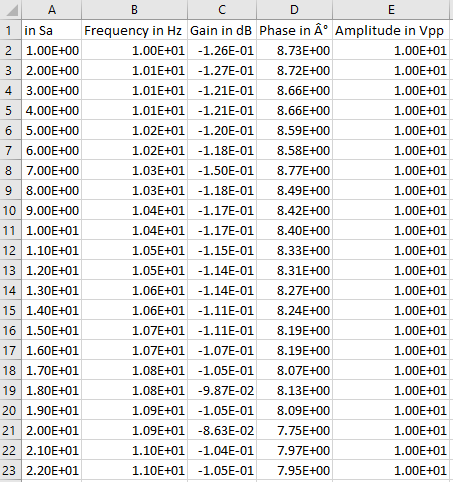

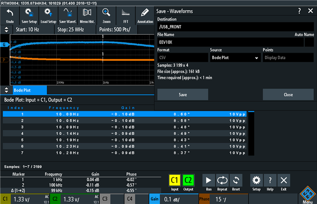

Data Export
The bode plot data can be saved into a .csv file for further analysis.
The exported format appears as below:

It remains to be seen if or when the North American RTM3000/RTA4000-series oscilloscopes get the K18 Spectrum Analysis features, as it still appears to be unavailable at this stage.

    By the way, whilst chatting to the customer support guys I got a little more info on the K18 option. I've always wondered why it wasn't available in the US and apparently it's down to patents. No more news on when a US version is likely.
  • Gough Lui
    Gough Lui over 7 years ago in reply to Fred27
    Interesting, as I never really ended up with a straight answer myself - I thought it may have been regulatory in nature, but indications pointed to other issues aside from patents. Regardless, it is a potential loss to NA customers who may need more than just the FFT ability.

    The disappearance of the grid lines in the Micsig DP10013 500x plot was because I selected an input channel (C2) rather than the gain/phase channels thus activating a trace that is in the collapsed top section. D'oh on my part.
