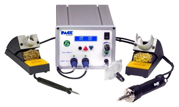

PACE
I have nothing against PACE as a company, but I do have troubles with the de-soldering stations we have at work.
We have earlier versions and the newer models.
While the control side has changed, the basic principle and 'hot' end hasn't really changed much.
The large part contains the power supply, temperature control and vacuum (or blow) pump, and this model has a controllable soldering iron.
   photo stolen from Farnell

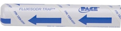

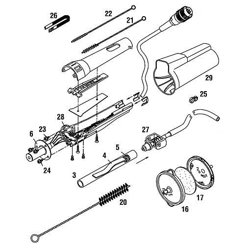

The handpiece contains the switch along with the heated end and a collection tube to hold the recovered solder.
     photo from JENSEN Tools + Supply | Products and Services for Electronics Manufacture, Assembly, Diagnosis, and Repair
The tube (3) holds a bent piece of aluminium (4) to collect the solder and a filter (5) at the end to trap solder particles and most of the flux.
A secondary filter was fitted at the end of the vacuum tube to ensure no particles went through the pump. (17)
Earlier containers were glass, with a rubber end that fitted around the end of the tip.
The clear tube allowed the amount of solder collected to be viewed, and the rubber end made a good seal to ensure all the vacuum went via the tip.
For some reason the glass tube got replaced by a cardboard tube.
They are cheaper, but you only ever broke the tube by rough handling or WAY too much solder causing localised overheating.
However there is this Health and Safety in the workplace and it could be this that has resulted in our work using these instead.
They are more difficult to clean out since you can't stick something in the other end to push out the bent aluminium 'catcher'.
Perhaps they aren't designed to be cleaned out.
What this picture is not showing is the end is rounded and pushed back on itself to form a rounded end that goes around the end of the tip.
The glass tube seemed to seal better around the end of the tip.

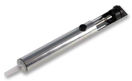

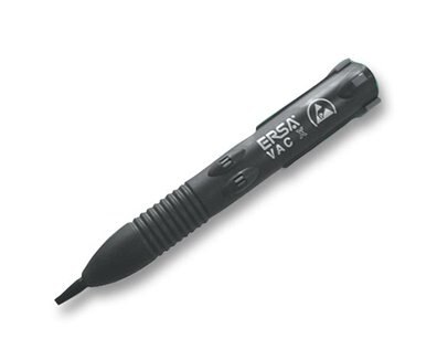

You can use a hand held De-Soldering Pump to suck the solder out.
These work well on one or two joints, but can be a pain to use.
To use them, you press down the plunger to compress the spring.
Heat up the joint and bring the nozzle as close as you can, then press the release button.
As the plunger is released it sucks the hot solder up inside the pump.
Obviously the closer the nozzle is to the joint, the more effective it is.
One little trick with any de-solder pump/plunger is that you can stretch the spring.
Make sure the O-Ring is clean and lubricated and check the nozzle is not damaged, and it should perform well.
The best model I have is a Phillips branded version that is slightly smaller than others, and utilises a smaller nozzle.
This means you're not fighting the soldering iron for the same space, and the suction velocity is higher.
I should have brought three or four at the time, because they aren't available that I can find, so I'm looking after mine.
Something to watch for is models where the nozzle is inserted from the outside.
When you push the plunger down fully, it protrudes through the nozzle to clean out any solder lodged on the sides.
With the external insertion type nozzle, they can be pushed out.
Models with softish nozzles can deform rather than clean out properly ...
I prefer the screw together models. I've seen the other 'twist lock' style versions fly around the room at the most inopportune moment.

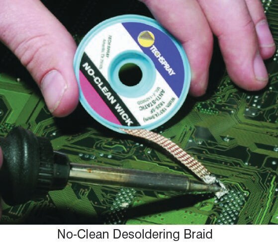

De-Solder Braid/Wick
I've heard people swear by this, and I've heard people swear.
It works for surface mount, but isn't very useful on thru hole components.
It is very useful for cleaning up holes .... but then so is the solder pump.
Don't be fooled, they come in different widths, and the cheap stuff may not work as well.

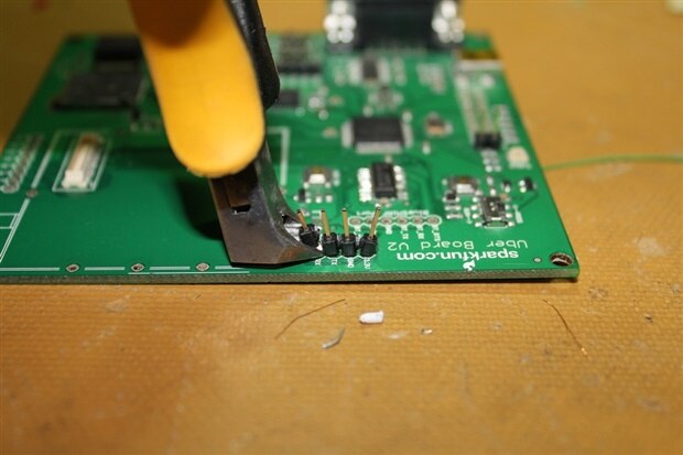

The last thing you want to do is damage the board.
It may be worth sacrificing the $1 component by cutting off the legs and then removing each leg seperately.
This works well for ICs, and is a must for header pins or other sockets.
   photo https://www.sparkfun.com/tutorials/97
Personally I'd use sidecutters to nip each leg, rather than risk cutting the board.
For headers or sockets you need to be careful not to damage the platethru part of the hole.
Generally the hole is snug, so it's important to seperate the pins.
   photo https://www.sparkfun.com/tutorials/339
Step 1, cut the pins
Step 2, heat and remove each pin.

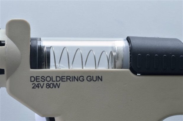

DURATOOL D00672
I can only find them on the cpc site http://cpc.farnell.com/duratool/d00672/desoldering-station-uk-eu-plug/dp/SD01384
Along with the station we decided a spare handpiece, tips and filters would be useful.
Luckily I didn't have any desoldering jobs to do, so it sat under the workbench waiting for that special day.
When I powered it up to use it, I had some issues with a distinct lack of suction.
As it was new I had no reference point, so a process of elimination began.
The suction pump worked, and there was suction at the collection tube.
The tip was clean and free with no restrictions.
The collection tube has a filter inside, plus an end plate that floats, and I thought it might be blocking the end.
As you applied suction and blocked the flow, the pump note changed to a deeper 'growl' but when it was assembled it sounded like it had flow.
Unlike the PACE models, the output of the pump ends inside the unit, so you don't get a 'blow' port to check.
By now you will be assuming that I opened up the manual ...... but that would be cheating !.
BTW I have since checked the instruction manual, and it inlcudes a diagram that doesn't match the collection tube, but no other useful information that would help.

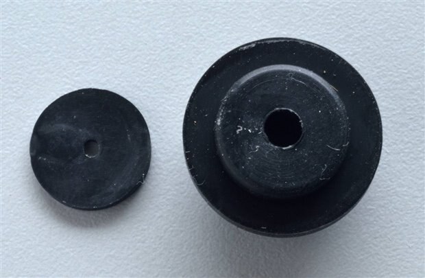

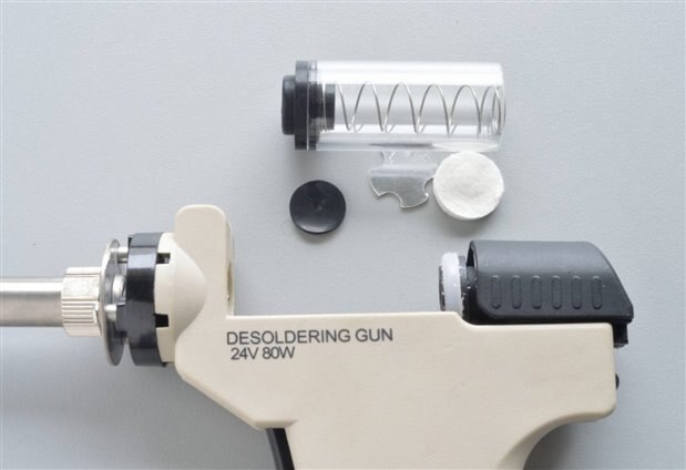

Collection tube
The tube on this is similar to the Denon and PACE. It fits between the tip and the suction line.
except this one contains loose bits....the photo below shows what I mean.

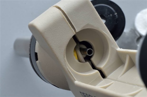

When I first opened the handpiece to see the collection tube, the various bits came out.
The aluminium disc is supposed to catch the solder, and the holes around the outside allow the air to flow.
The issue is nothing is tight in the tube, so as you return the collection tube to the handpiece any suction wants to take the path of least resistance.
At the front there are two rubber like seals. The larger one fits the tube, but the smaller one was just floating.
In the end I fitted the smaller seal over the end of the protruding tip.
I figured it was either going to smell bad as the material cooked, or it would seal around the tip.
My later assumption was correct and it sealed the 'leak'.
So this unit now sucks very well, and easily cleaned up the solder joints.

    I think we're comparing apples with apples.
    Here's a picture of my desoldering gun accompanied with a solder stalagmite from its filter.
    The momentum of the solder makes it collide into the centre of the metal filter cover forming an elongated stalagmite over time.
    The suction comes from the four open edges of this filter cover.
    jw0752 over 9 years ago in reply to COMPACT
    Hi Compact,
    Actually I agree, we are comparing Apples to Apples. For an experiment I set up a replacement element for this gun and put 15 watts of power on it and let it stabilize. I then used a Fluke IR temp sensor to read the temperatures on different positions of the element. As you can see the bulk of the heat is concentrated at the interface to the tip. The temperature gradient is near 200 degrees F from the tip to the exit into the solder capture chamber. Incidentally the temperatures are all displayed in Fahrenheit. If you want to convert to C the formula is C = (F-32)/1.8.  Keep in mind I am applying 5 volts at about 3 Amps to the element and the temperatures generated are for illustration only and may not match normal operational temps. A further observation on why I may be having occasional blockages and you may not is that I have had my unit for over a year and I frequently salvage older circuit boards. I believe there has been some pitting of the inside of the stainless tube by salts or other chemicals in the different fluxes that have been pulled through. This pitting combined with the lower temperatures down tube cause a constriction that eventually clogs. Your use and application of your unit hopefully may not ever have this problem. Below are the picture that I took of the temperature gradient down the side of the heater.
