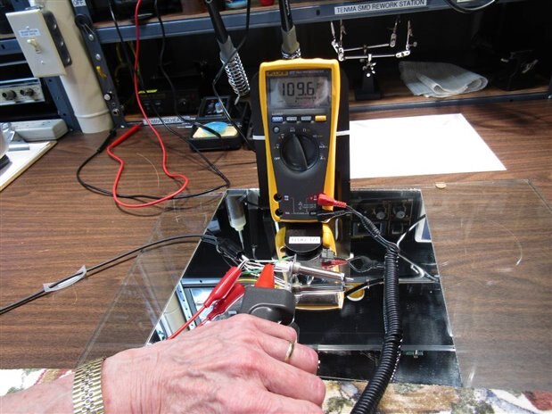

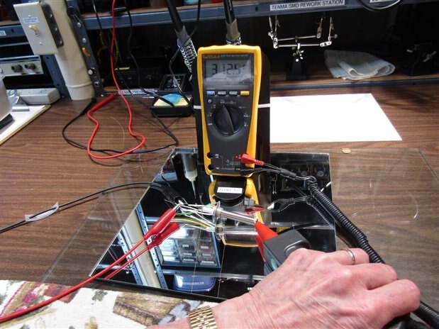

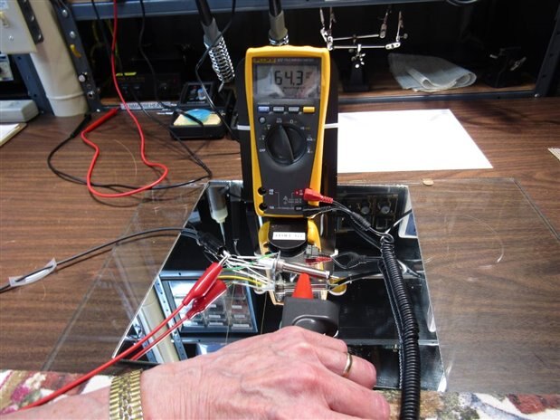

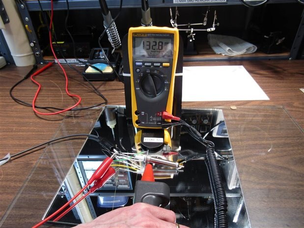

    jw0752 over 9 years ago
    Hi Mark,
    I have a desoldering station that is the same as the one you describe in the last part of your blog. Here are a couple tips I have discovered to make it work better.
    I put a light coating of talcum powder on the black front seal so that the chamber doesn't stick to it and pull it out when I remove the solder collection chamber.
    I have had the stainless central tube become clogged when solder is drawn in early in the operation. The stainless wires that are provided to clean out the solder do not work well as they do not conduct heat to the clog. I have taken a piece of 14 gauge copper wire and used that to clear the tube. The heat travels down the copper wire and melts the clog making the clearing process quick and easy.
    I made quite a few modifications to my unit and I am very pleased with how well it works now.

    jw0752 over 9 years ago in reply to COMPACT
    Hi Compact,
    Actually I agree, we are comparing Apples to Apples. For an experiment I set up a replacement element for this gun and put 15 watts of power on it and let it stabilize. I then used a Fluke IR temp sensor to read the temperatures on different positions of the element. As you can see the bulk of the heat is concentrated at the interface to the tip. The temperature gradient is near 200 degrees F from the tip to the exit into the solder capture chamber. Incidentally the temperatures are all displayed in Fahrenheit. If you want to convert to C the formula is C = (F-32)/1.8.  Keep in mind I am applying 5 volts at about 3 Amps to the element and the temperatures generated are for illustration only and may not match normal operational temps. A further observation on why I may be having occasional blockages and you may not is that I have had my unit for over a year and I frequently salvage older circuit boards. I believe there has been some pitting of the inside of the stainless tube by salts or other chemicals in the different fluxes that have been pulled through. This pitting combined with the lower temperatures down tube cause a constriction that eventually clogs. Your use and application of your unit hopefully may not ever have this problem. Below are the picture that I took of the temperature gradient down the side of the heater.
