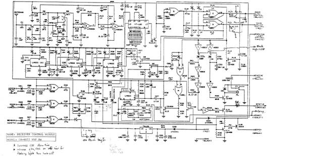

I've scanned the circuit diagram, and there is lots of options to tweak values.

It becomes fairly clear that there is very little capacity to reduce this units current consumption.
I can make some educated guess'es about the function of the other IC's, without looking underneath.
IC4 is to drive the relays for the integrated central locking.
IC3 is to store the codes or the options selected when you program it.
IC1 looks like a regulator, and the screen printing shows a TO220 style (1A LM7805LM7805 ) but it has a TO-92 fitted ( 100mA 78L0578L05)
