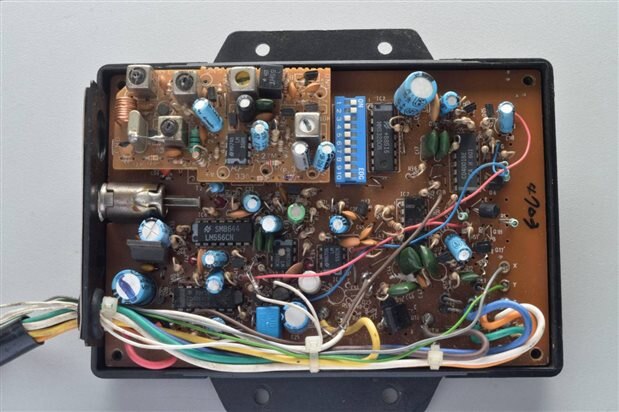

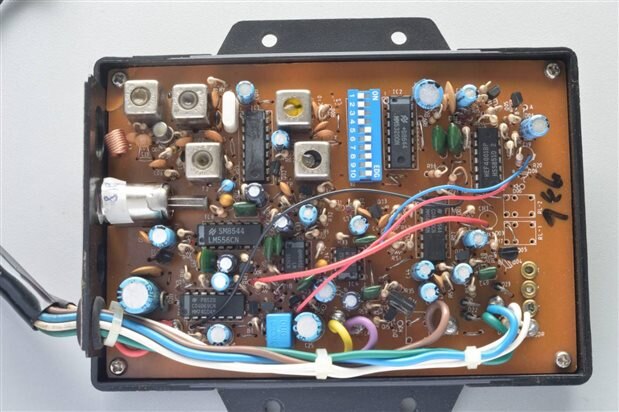

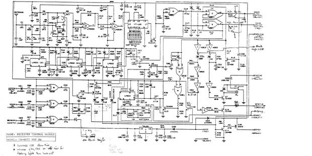

I've managed to find all the information about my fitted alarm unit.
In my digging around I even found the spare in it's box, along with about 4 others I had for repair/modification.
     source 3 minions (me, myself and I)
As the photo shows, these are old school with lots of discrete components, some CMOS chips and there is two different versions.
From what I recall both are 49MHz receivers, it's simply that one is much better.
However there does seem to be space for two relays, and I'm guessing that the one on the right might have had the ability to do the central locking without the extra unit.
I'm very happy the old unit has withstood the test of time, along flat batteries, massive voltage spikes and whatever else has been thrown at it.
BUT it does need to go on a diet and eat less joules.
I've scanned the circuit diagram, and there is lots of options to tweak values.

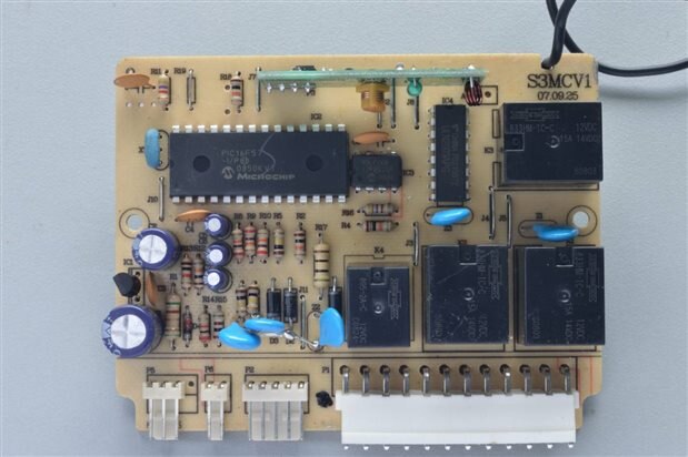

As a comparison this is the other unit I'm looking at.
It becomes fairly clear that there is very little capacity to reduce this units current consumption.
I can make some educated guess'es about the function of the other IC's, without looking underneath.
IC4 is to drive the relays for the integrated central locking.
IC3 is to store the codes or the options selected when you program it.
IC1 looks like a regulator, and the screen printing shows a TO220 style (1A LM7805LM7805 ) but it has a TO-92 fitted ( 100mA 78L0578L05)
The board standing up is a 305MHz receiver, and will be using a SAW type filter https://en.wikipedia.org/wiki/Surface_acoustic_wave

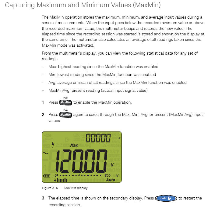

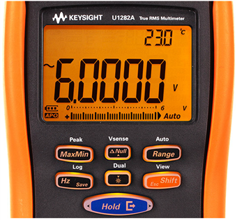

Luckily I was able to Road Test a Keysight  U1282AU1282A back in 2016 RoadTest the Keysight U1282A Digital Multimeter - Review
What wasn't indicated during the testing was the ability to view the max and min values, along with the average.
So despite the display changing, it's easy to get the figures.
Fitted Alarm
The current consumption is 65 mA in it's idle state.
This was lower than I imagined, but none the less quite high.
Most of the time the alarm isn't set but since it's powering a LED via a 1K resistor it could provide 9 mA when flashing.

So how many hours?
65mA is 0.065A.
90 AH / 0.065 = 1384 hours, which equates to 57.666 days until there is no capacity left.
If you expect to start the vehicle, you need some capacity, so it's not hard to see why this is going flat.
