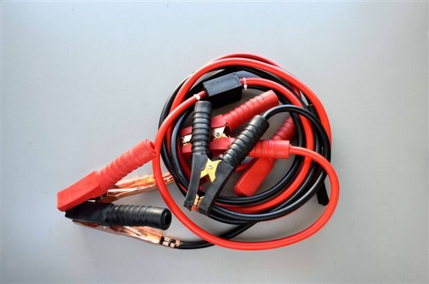

Jumper Leads
All of my vehicles have a set of jumper leads, for that day when you accidently leave the lights on, or someone else that needs a bit of spare energy.
The leads are usually purchased from the local retailer "where everyone gets a bargin" and are less than $20 and in a bag so that they keep the car clean.
I'm well aware that the insulation looks like it's designed for 1,000,00 volts, but bigger size always means better ... right image
I know they aren't high quality but the other day I found out they were a little high in the resistance department.

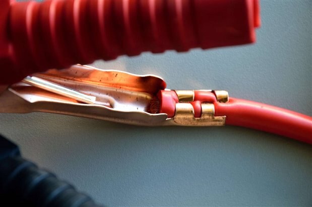

I know that these cheap jumper leads have more insulation than wire, but I wasn't ready for the quite warm clips at each end of the leads.
High Resistance
We've discussed how the current through a resistor results in a voltage.
Voltage x Current equals Watts, which produces heat across the resistance, so for the clips to get hot, there had to be resistance.

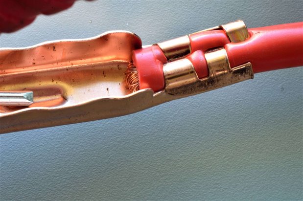

I checked the grip end was making good contact and a bit more checking showed the heat was closer to the junction of the cable.
The photo shows why there was a high resistance
Rather than properly crimping the wire, they have simply folded it underneath and crimped the insulation, and hoped that the wire makes contact.

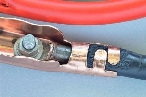

The first job was to extract the wire from the clip.
A bit of prising and a pair of pliers helped open up the bent parts.
I measured the wire as 4mm diameter, and found some crimp lugs that the wire would fit into.
My smaller crimp tool is the old style where it forces a piece into the lug, while the newer version are hexagonal and squeeze the whole lug.
I decided that two punches would be the idea and regardless it was better than the original method.
The alternative is soldering, but this creates a hard transistion point, and when heated the joint can change and then the resistance increases.
After they were crimped, a quick brush with a wire brush made sure that any oxidation on the mating surface was removed.
I had to drill a 5mm hole in each clip, and then a 5mm screw, washer, lock washer and nut completed the task of fastening the lug to the clip.

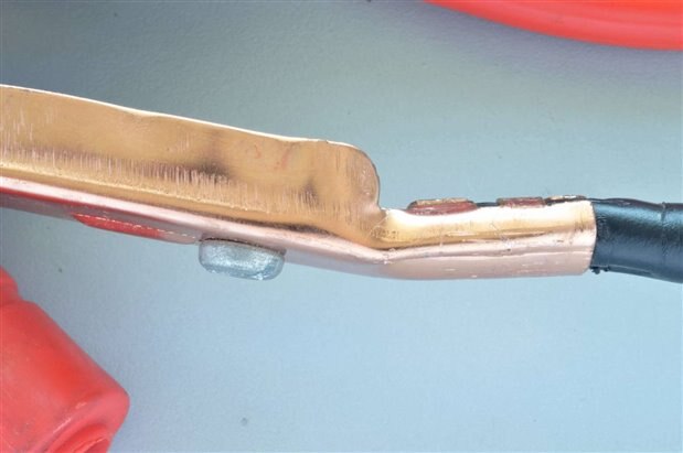

This shows how little wire there is in the cable, and the marks from the origianl crimp method.
