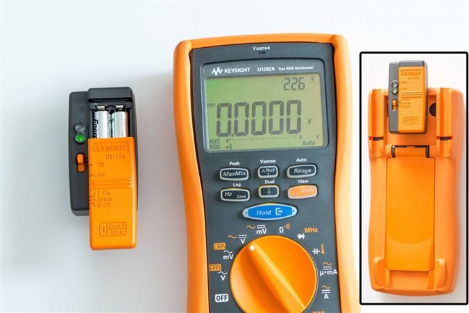

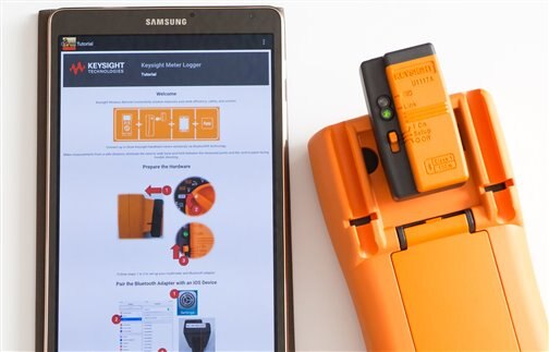

Bluetooth Connectivity
It is not always easy to have a PC nearby, so to make things convenient there are a couple of IR-to-Bluetooth adapters available for the  U1282A.U1282A. One has a 10m range and the other has a 100m range. The 10m range Bluetooth adapter10m range Bluetooth adapter is very low cost, and so could be an easy decision to automatically add to the purchase if you’re buying the multimeter. In the end I went with the 100m range Bluetooth adapter100m range Bluetooth adapter; I may never need such a range but the multimeter will give many years of service and I cannot predict future needs.
If you also have earlier U1200 series devices then the same IR-to-Bluetooth adapters are compatible with them too. The U1240 series multimeters do need a U1179A bracketU1179A bracket though.
The IR-to-Bluetooth unit is well constructed but not rubberized. If the multimeter and IR-to-Bluetooth adapter were to fall off the desk possibly they might disconnect but I doubt any damage would occur. Besides the  U1177AU1177A is quite low cost and wouldn’t be too painful to self-fix or replace or have repaired. It comes with two AAA batteries and these are expected to provide power for 20 hours before they need replacing.
The unit can be used with the same software that is used with the IR-to-USB cable that comes with the  U1282A,U1282A, and there is free mobile software too(search for Keysight Meter Logger in the Android or Apple app stores.
The PC and mobile software is similar but the feature set isn’t entirely the same. The mobile version is missing high speed logging (it instead logs once per second) but benefits from a ‘math mode’ which the PC software doesn’t have (described later).
To cut a long story short, I was deeply impressed with the mobile software. Functionality-wise it does everything I would need it to do. It looks after logs captured, and I can view them again at any time using the software, and can immediately export to CSV or PDF format or obtain images and save them or share them via e-mail, Twitter or whatever. Basically complete integration with other mobile apps through the sharing capability that exists in Android.
Performance-wise I’d love to see the high speed logging capability appear. The  U1282AU1282A series is new though so it is probably on their feature-request list(I’ve asked Keysight, will update here when I find out). The other small changes I’d like to see are related to the Math Mode. This is a neat yet simple feature to allow arbitrary equations to be executed on the captured data and then plotted to the screen. It is extremely powerful. For maximum usability I’d like to see exponentials (today I have to type 0.000001 for example rather than represent it as an exponential) and an ability to store equations within the software (the workaround is to copy-and-paste to a notepad inside your mobile device); It is not too big of a deal. More on equations later, but first I wanted to do something simple: check the car battery voltage during starts!

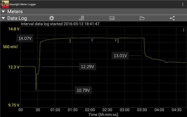

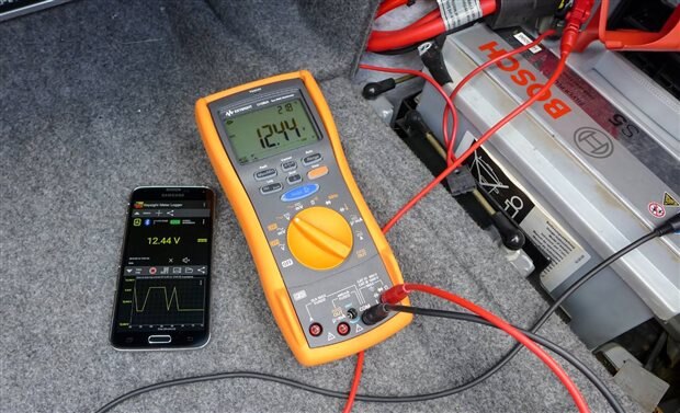

Car Battery Measurements
My car battery is in the rear boot (trunk). It was easy to clip directly onto the car battery and leave the multimeter placed in the boot, close it and then sit in the driver seat to conduct the tests! Bluetooth is great (incidentally these croc clipsthese croc clips are also great. I use them for electronics work (they can grip thin wire strands) but they also easily fit around car battery clip screw threads).
Don’t forget to set the range to 600V (so that it doesn’t auto-range during the test).
The car battery is a Bosch one, from Halfords, but I’ve had the same model previously from Halfords too and it failed within a couple of years. I have had this battery for about a year and it is not particularly healthy.
By running the Meter Logger software on the tablet, I had two free hands to start up the car as usual and observe what was going on with the battery voltage. This test verified the car battery voltage with the engine switched off, the voltage during engine startup and the voltage while the alternator was running. I could not have done this easily without the multimeter – I do not have a portable oscilloscope, nor would I have wanted to carry a full-size oscilloscope out to the car, power it from mains and then set up a suitable trigger just to run a quick battery test.
Now that I have the information captured I can quickly save the screen capture to my mobile phone all ready to compare it when I rerun the test during the winter. So simple! I love that I can use this multimeter for such vehicle applications It will not replace an oscilloscope and of course will miss all high speed signals but as mentioned, realistically I would not have used an oscilloscope in the vehicle unless I really needed to. The  U1282AU1282A and a cheap OBDII device are my two main vehicle diagnostic tools now. I’ll be even happier when the 10 captures per second capability can be introduced to the mobile app.

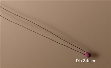

Temperature
The handy Betatherm thermistorBetatherm thermistor can provide an easy temperature measurement, provided the following formula is entered into the Meter Logger software. The non-linear resistance to temperature relationship of the thermistor is taken care of in the formula. Set the meter to Ohms, apply the formula and the entire system provides a very accurate temperature measurement solution.
(1/7(0.0007987407898+(0.0002125901507*ln(MA))+((0.00000007077938365)*(ln(MA)^3))))-273.15

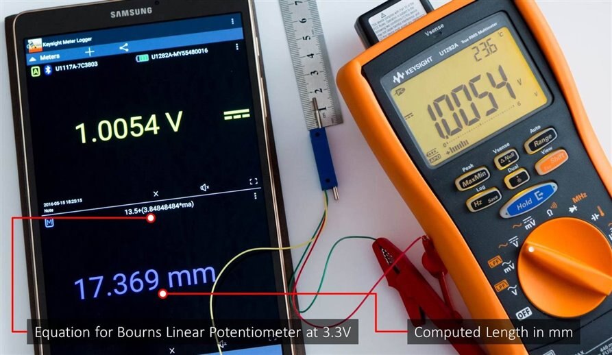

Linear Travel
As another example, if a machine needed aligning it could be easier to have a measurement in millimetres rather than a voltage from a sensor. If the machine had a linear potentiometerlinear potentiometer fitted, then this is not a problem!

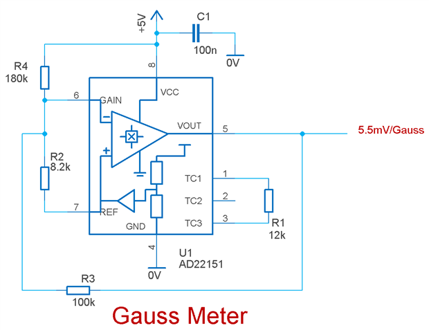

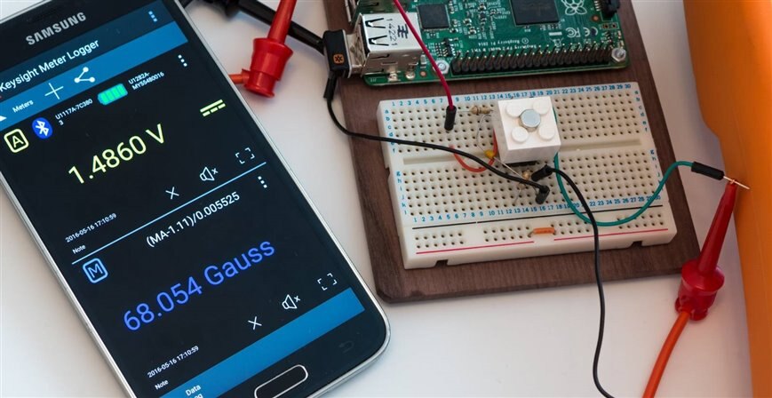

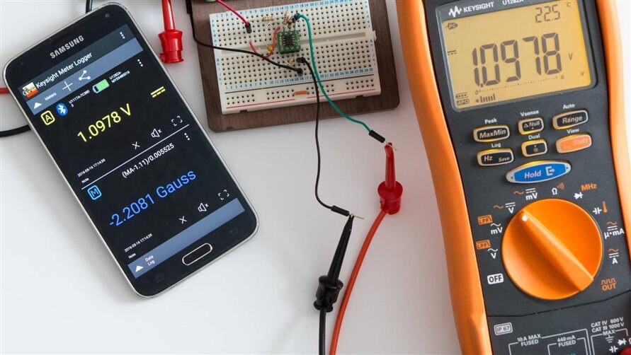

Magnetic Flux Density
A magnetic flux density (Gauss or Tesla)-meter was constructed using a hall sensor device, and by plugging in the relevant formula it was possible to see that it was performing as expected (incidentally, the Analog Devices AD22151 appears to be fairly accurate from what I can tell.
It was refined by accurately measuring each component in the circuit using the multimeter and adjusting the equation accordingly. I didn’t have an easy way to confirm, but I got Gauss values very close to the expected ballpark when using a small magnet placed on top of the industry standard 9.6mm (well, Lego Industry standard i.e. a Lego brick height). There is an excellent magnet calculator here.

    mcb1 over 10 years ago in reply to shabaz
    Very interesting that it states that if the battery is discharged below 12.1V it can become very difficult to recover its normal performance.
    Calcium batteries also tend to swell when they are flat.
    Calcium have the advantage of very low self discharge, but I don't know of one single car that doesn't draw power just sitting there, so I suspect they get more energy from less lead.
    My friend owns an automotive electrical repair business and he had to recharge one of mine once.
    They usually stick another battery across it to bring it up while they charge it.
    The loading might show up something, but I suspect it's the lower output that is not helping.
    I'd do some checking to see if there is a higher voltage regulator for that alternator.
    Most internal regulator alternators have two wires. The output which is large and the other lights the dash lamp and provides the reference voltage.
    You could try fooling it by adding a diode in series with the small wire. This will reduce the voltage fed back and should raise the output by 0.6v.
    Pity the testing didn't also log the temperature ....
    shabaz over 10 years ago in reply to mcb1
    Hi Mark,
    It is fantastic being able to record these results with the mobile phone isn't it.
    Interesting results. I've been checking online and it looks like for my car 13.5-14.3V is considered normal range, and the regulator is set to 14.3V apparently. I can't be sure though, I've not consulted a garage.
    According to the doc you found the Bosch S5 should have the voltage limited to 14.4V during constant voltage charge but I couldn't find the minimum recommended limit. Very interesting that it states that if the battery is discharged below 12.1V it can become very difficult to recover its normal performance.
    I have not had a chance to try it under significant load but will try that in the next few days.
    check what the expected output is supposed to be from a genuine BMW alternator and regulator
    Given the age of yours, I'd suspect that 14v is the spec.
    I couldn't recall what model it was but the forums had some info on xyz having issues.
    The Jag site was even more particular that they were only ever designed for lead acid batteries. !!
    I should have some figures tonight from a couple of my vehicles.
    In the meantime you might want to load the electrics and see what it produces.
    Hi Mark,
    Great analysis. The alternator could well be it. When it died a few years ago, it was replaced with a so-called 'rebuilt' one which while a fraction of the cost of a new one, could be providing a lower emf. The Halfords advice on battery selection doesn't go into enough detail to know if a calcium battery is always appropriate or not. I'll have to get a friend with a diagnostics database to check what the expected output is supposed to be from a genuine BMW alternator and regulator. I don't think I've got any OBDII errors, but it has been a while since I checked (and not sure how accurately it would measure it anyway). It will be great to see your output, since you have a new vehicle and battery and the comparison between old and new would be interesting.
