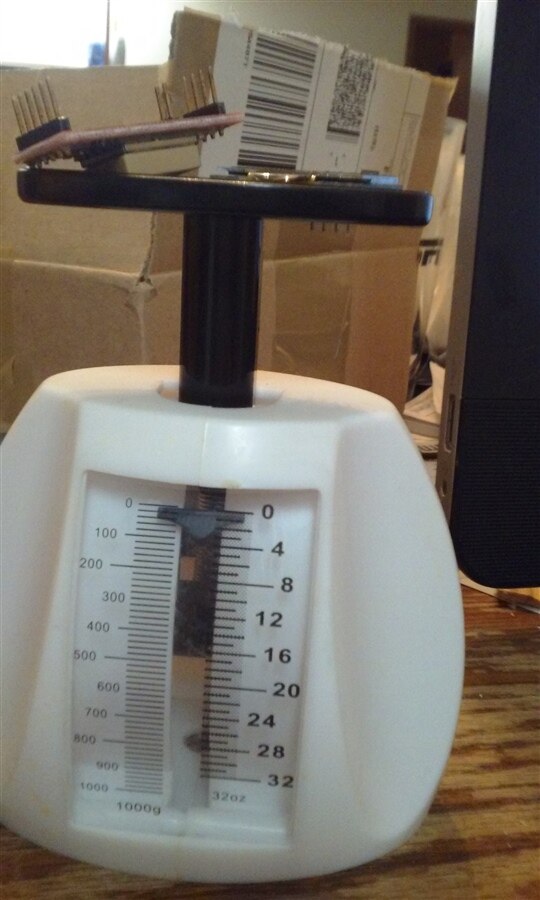

Naturally I choose the GPS unit.  However, as Makers we can all tell that this is something we can make ourselves.
The prefab unit is $100, lets see if we can do better.
The hardware
I have two options I am considering.  Both use the Microstack GPS.
Option 1
I plan to use an Arduino Pro Mini Clone.  I have found a version that at $1.85USD it works perfectly.
I will also use an monochrome OLED.  This is a 120X96 resolution.
I'll need a few tactile buttons.
I'll need a 3.3V and 5V regulator, and I chose the AMS1117 linear regulator in both voltages.
Option 2
I have a clone TFT LCD clone that costs mea few $.  It needs an Arduino UNO to function, as it is in the form of a
shield.  This Screen also has a SD card which is nice for storing GPS data.
I wont need any buttons as it is a touch screen.  I will still need a 3.3V regulator for the GPS unless I decide to
use the one onboard the UNO.
Comparison
Option 1
Weight is < 1/2 oz.
Total cost (rounded):
PartCost (USD)
Arduino Mini (5V)$2
GPS$25
OLED$4
AMS1117 (3.3V)$.10
AMS1117 (5V)$.10
MISC$5
Total$37-$40
Option 2
Weight is about 2 oz
PartCost (USD)
Arduino UNO$10
GPS$25
TFT LCD$5
AMS1117 (3.3V)$.10
AMS1117 (5V)$.10
Misc$5
Total$45-$48
The MISC budget is just for items like buttons, connectors etc.  For a case I will just be using blue core foam.
Either option is good, and the price is right which makes it a good project instead of buying a prefab unit.

Calculating Velocity
I could use some input here but my thoughts are pretty simple.  The GPS give the coordinates and I have a function called "DistanceBetween" that gives the arc length between two GPS points.  This function ignores altitude and assumes you are on the surface of the earth.  The speed is just the distance travelled over the time lapsed.  The unit will display the moving average of the speed over the last 3 measurements.  This will help smooth out the jumps from the lack of resolution of the GPS for the small distances an RC aircraft travels.
A similar calculation is done for altitude.  The change in altitude divided by the times lapsed gives the climb or dive rate.  The absolute value of this is then just added to the ground speed.
If we have a calculated ground speed of 100 MPH and we happen to also climb 20 feet in the last second (13.64 MPH) then our total speed is 113.61 MPH.  Does that seem correct?
I plan to start this project in full force next week and have it working in a few days there after.
