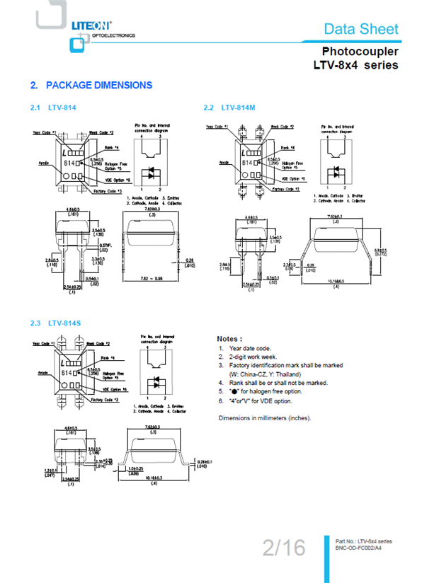

I was working on a circuit board for a Midmark Sterilizer when I came across the LTV 814 Opto Coupler.
This Opto coupler has two opposite polarity LEDs on the input and a photo transistor on the output.

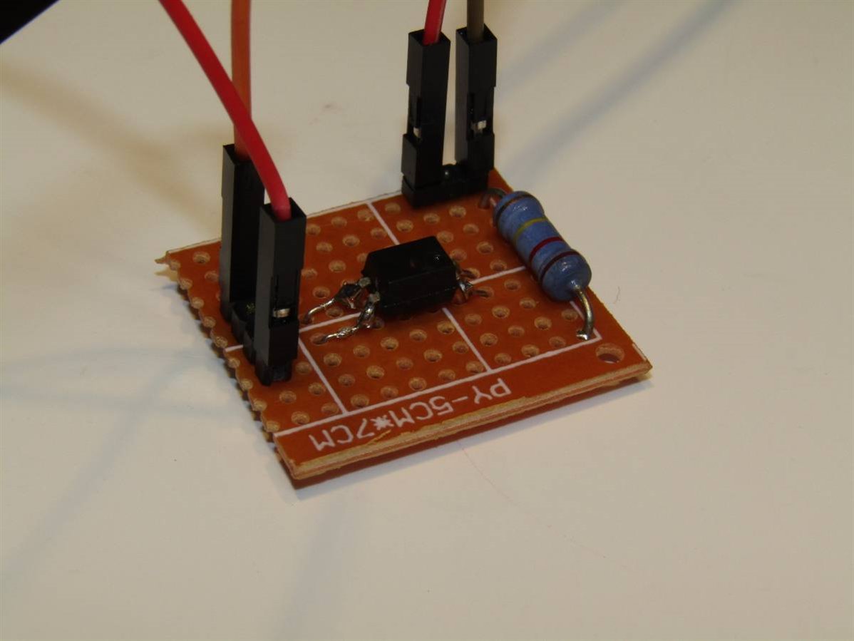

I salvaged one of the opto couplers from a scrap board and decided to experiment with it a little bit. The LEDs on the input have a voltage drop across their junctions of about 2 volts. The sterilizer board was using a 120 K Ohm 1 Watt resistor in series with the input to limit the current to the LEDs. 115 volts RMS divided by 120 K Ohms leaves us with slightly less than one milliamp of current. I had to adapt the SMD LTV 814 to through the hole for my experiment and I mounted it on a small piece of proto board. Of course the AC current would vary with time and the 1 mA was just the effective average current.
Here is the experimental board:

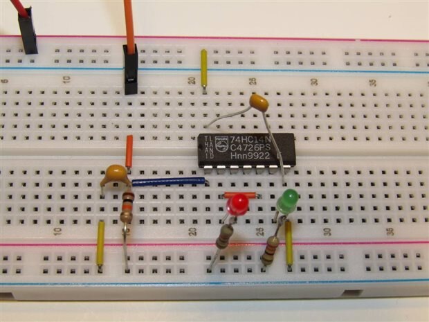

In order to see the effect of the whether there was AC on the input of the opto coupler or not I put together this circuit:
I put the photo transistor of the opto coupler in series with a 10 K resistor and connected the common point to the input of a 74HC14 Hex Schmitt Trigger IC. The Red LED is on the output of this first Schmitt Trigger. I also connected the output of this first section to the input of a second Schmitt trigger. The Green LED is on the output of the second Schmitt trigger. Since the Schmitt triggers invert we should see that the Red LED is lit when the AC power is off and the Green LED should light when the AC power is applied to the Opto Coupler. The capacitor across the 7414 is a decoupling capacitor and the other capacitor is a 10 uF ceramic that is being used to take the 120 Hz pulse out of the input to the Schmitt trigger. Since our input to the optocoupler is AC, 120 times each second the voltage on the LEDs is zero volts and this turns off the Schmitt trigger. The 10 uF capacitor stores the voltage during these off times and keeps the Schmitt trigger active. Once the power is turned off the voltage on the capacitor quickly drops due to the circuit through the 10K resistor and the Schmitt trigger goes low on the input.
I made a short video of the experiment in action:

    Had not realized that there was an AC version of optocoupler, I've used the DC versions before but didn't think of using one of these to make the input polarity insensitive as Shabaz suggested.
    What surprised me was that it was not obvious from the data sheet that this was an AC input part other than in the package diagrams(the sheet that you included).
