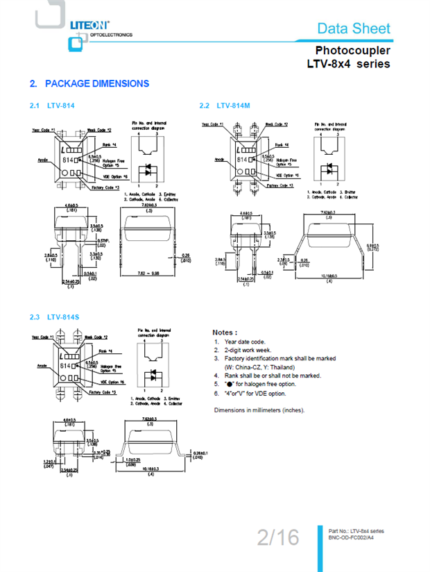

I was working on a circuit board for a Midmark Sterilizer when I came across the LTV 814 Opto Coupler.
This Opto coupler has two opposite polarity LEDs on the input and a photo transistor on the output.
The sterilizer has a door switch that is in a 115 volt AC circuit as well as an over temperature cut out switch that is also part of a 115 volt AC circuit. The open or closed status of both of these switches needed to be monitored by the sterilizer's logic circuits. In this case the designer's choice had been to use the LTV814 AC opto coupler to convey the status of these switches to the logic circuits.
I salvaged one of the opto couplers from a scrap board and decided to experiment with it a little bit. The LEDs on the input have a voltage drop across their junctions of about 2 volts. The sterilizer board was using a 120 K Ohm 1 Watt resistor in series with the input to limit the current to the LEDs. 115 volts RMS divided by 120 K Ohms leaves us with slightly less than one milliamp of current. I had to adapt the SMD LTV 814 to through the hole for my experiment and I mounted it on a small piece of proto board. Of course the AC current would vary with time and the 1 mA was just the effective average current.
