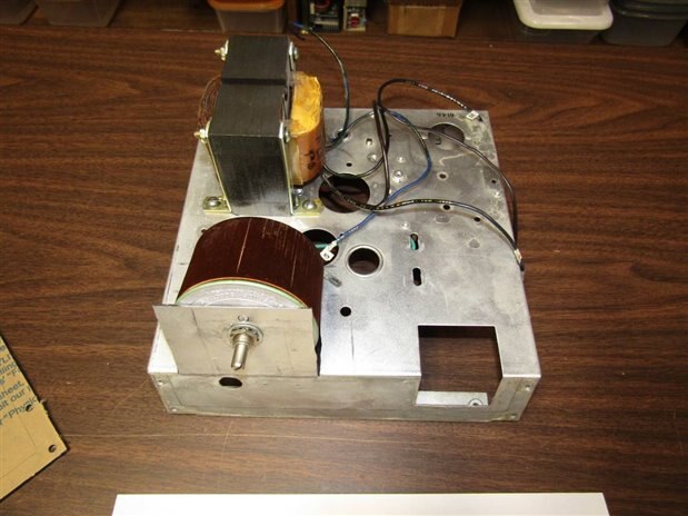

This will be the isolation transformer. I can put 115 volts on the primary and it will have 130 volts on the secondary. This will drive the small Variac pictured below.

The chassis has had some modifications. The metal that the variac is mounted to was originally part of the chassis deck but it has been cut and folded up to provide additional support for the relatively heavy variac. The cut out on the right side of the chassis came with the original piece of equipment. Anomalies like this often dictate where components and controls need to be placed. In this case it will be the recess needed to allow the mounting of an AC line Output jack on the front panel.

    You are correct I have a problem with the electronic logic on my AC voltmeter. I will have to see what I can do about that after the meter arrives. The Ammeter uses a sense coil so that one should stay isolated OK. I may have to put a small one to one isolation transformer on the output and feed its secondary to the meter's sense and ground. I am not sure I want to tie one of the output leads to the meter ground. I will have to think about that and run some empirical tests to satisfy my doubts. I am always happy when you look at the electronic designs that I propose as your experience shines light in the dark corners of what I am trying to do.

    My personal feeling was that you really didn't have to have a second isolated output for the panel meters, but if you did, tying one of the legs of the transformer to the Variac to make a common "neutral" reference on the secondary side doesn't seem like a big issue? My main reason for thinking this is that even if you common a leg, the secondary side is still completely isolated from the incoming mains, thus shouldn't present any added danger. In the present configuration that doesn't really work, I also had a feeling that the meter became the "isolation" between two isolated parts which would perhaps be unwise depending on the quality of the insulation on the meter.
    If you really must ensure that the meters absolutely could not ever become live, then perhaps it might be worth incorporating a step-down transformer as the isolation and compensate for the step down in the metering configuration. This will have the advantage of having the meter being low voltage and meter input perhaps also low voltage - a wet hand touching the meter shouldn't be unsafe. In the same vein, perhaps rather than relying on an ammeter "shunt" which is still referred directly to the output mains, perhaps you might consider a current transformer (i.e. similar to how a clamp meter works). This would again add insulation between the metering and the output - but perhaps at the cost of accuracy in both cases.
    Another thing I thought of, depending on your Variac, perhaps some form of soft-start inrush limiting (NTC?) would be a nice additional feature, along with an input suppression network of sorts (X-caps, Y-caps, choke) which might be good to take out the occasional mains switching spike. If not that, perhaps a MOV would be enough to take out the biggest of surge spikes on the input side - we don't want to see it reflected in the output and frying stuff under test! You might also want to add a switch on the output (assuming US sockets don't have inbuilt switches) so you save plugging/unplugging items from test or arcing at the plug terminals.

    The Ammeter comes with a current transformer. This will still need some modification as the meter - transformer configuration is for 100 A which is much to high for my expected range of 0 to 3 Amps. I figure I can wind 10 loops of the line through the current transformer and that should turn it into a 10 Amp full scale. I will then either move the decimal point or designate the meter as "divide by 10".
    After looking more closely at the meters I see that I do not need to produce a DC supply for them either. I haven't decided whether I will use this short cut or not.
