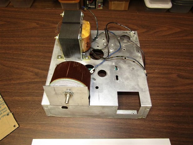

This will be the isolation transformer. I can put 115 volts on the primary and it will have 130 volts on the secondary. This will drive the small Variac pictured below.
The case will be from an old Dental Cavitron Scaler. I have used this same style case before to build a Bench Power Supply and a DC Electronic Load.
The Plexiglas blank control panel was cut a couple years ago in anticipation of an application for this case. The case as seen in this picture it still needs a cleaning and a coat of paint.
The case has been painted and I have the tentative control panel layout on the sheet of paper next to the case.
The chassis has had some modifications. The metal that the variac is mounted to was originally part of the chassis deck but it has been cut and folded up to provide additional support for the relatively heavy variac. The cut out on the right side of the chassis came with the original piece of equipment. Anomalies like this often dictate where components and controls need to be placed. In this case it will be the recess needed to allow the mounting of an AC line Output jack on the front panel.

    Here are a couple pictures of the installed wiper sensor.
    Wiper is away and the orange switch button is in the open position.
    The wiper is in the off position and the orange microswitch button has been depressed. I built an epoxy ramp on the back of the wiper so that the switch would smoothly actuate as the wiper slid under it.
