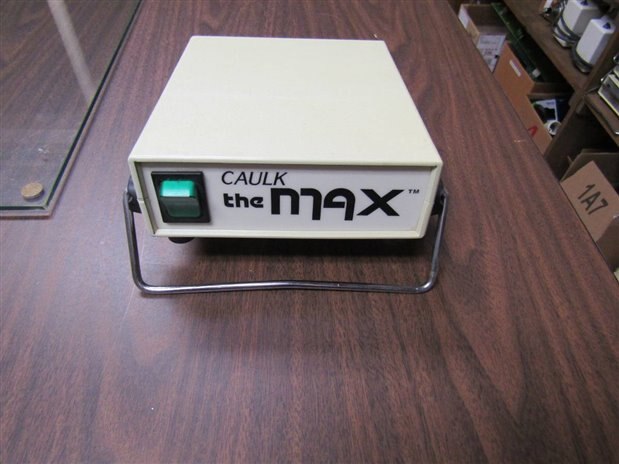

I began by looking through my grave yard for a suitable sized enclosure and a suitably sized power supply. The unit that seemed most appropriate began life as a Dental Cure light. If you want more information on what exactly a Dental Cure Light is here is a link to a previous blog where I gave some background: ( You can skip back here after the brief preliminary explanation of what a cure light is.)
https://www.element14.com/community/people/jw0752/blog/2016/06/25/tsl-230-light-to-frequency-converter
Here is what the original control looks like without the power cord and light attachment:

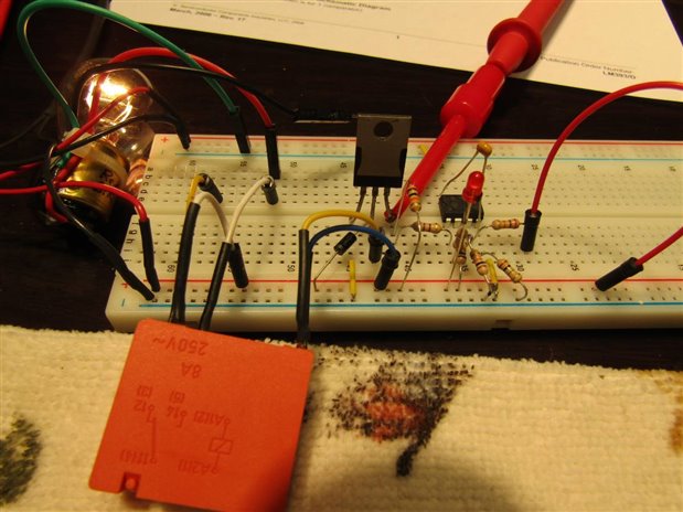

I simultaneously was bread boarding and developing a control circuit that would look at the sensors that were discussed in Chapter 2 and trip an alarm and the solenoid to close the water valve. Here is a picture of the bread board circuit under development:

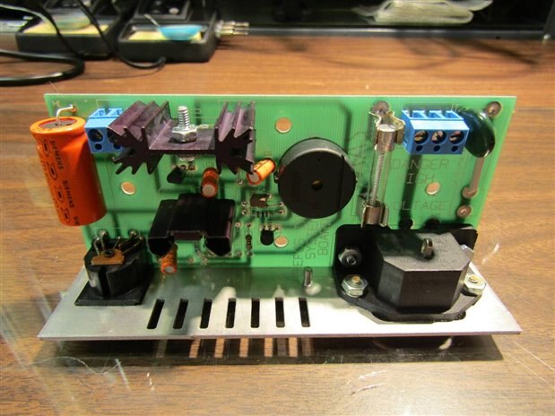

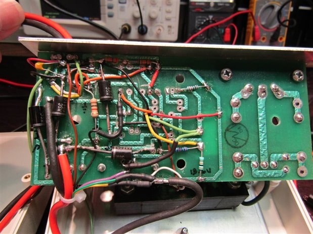

Now the fun part begins. You have probably been asking yourself by now; Didn't he say something about Frankenstein in the title of the blog? Yes I did. For this project I decided to fore go the usual construction of the control circuitry on a piece of clean prototype board. Just like the famous Dr. Frankenstein I have decided to remove all the parts of this Cure Light Control that do not suit me and put in on the same circuit board, using the same pads and traces, the parts that I need to make an Automatic Water Shut Off. Here is a picture of the circuit board as it looked originally and after the old components were removed.

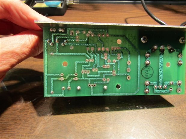

We might as well throw in a picture of the reverse side of the board too as this is where most of the new work will be done.

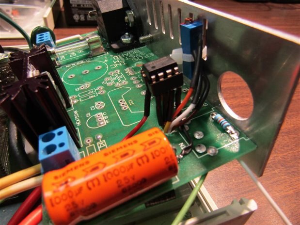

What I am doing with this board, I will call it Frankensteining, is only possible for me because I am working with very simple circuits like the one in the schematic above. The procedure involves a careful study of the layout of the existing traces and a careful, planned positioning of the new parts. Frequently it is necessary to cut traces and occasionally it is necessary to jumper traces. Pads for connecting components can be made with sections of the original traces. You will see unconventional structures like OpAmp Pillars and Comparator Pillars in this build. They are the results of necessity and convenience. This circuitry will work as it is all low frequency or linear in nature. This type of build would quickly fail if we were dealing with higher frequencies. Inductive and Capacitive coupling would interfere and our build would never rise from his slab. Skipping ahead here are a couple pictures of the completed transformation:

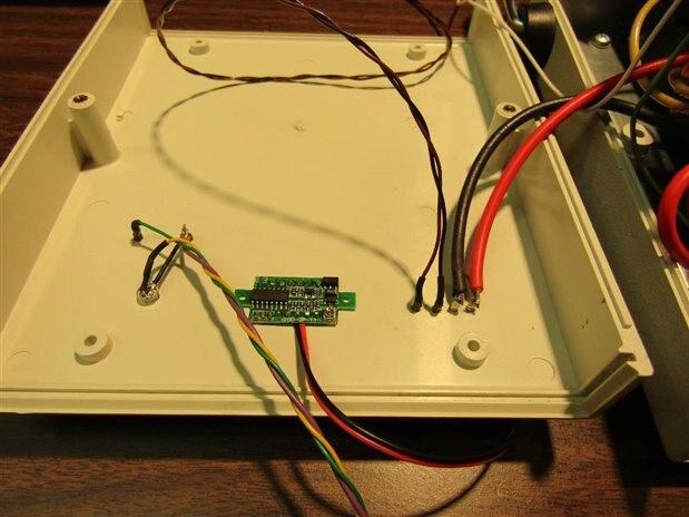

The controls, some of the terminal I/O, and the system volt meter were mounted to the original cover.

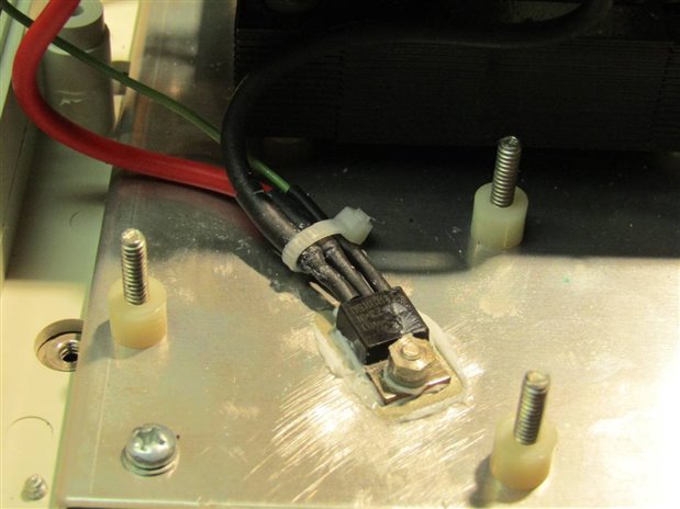

The power supply MOSFET was attached to an Aluminum base plate in the unit and the relay trigger MOSFET was mounted on a heat sink left from the original cure light circuit.
The trigger MOSFET is mounted on the black heat sink on the left side of the picture. This is a picture of the board before the rest of the sensor/trigger circuitry was installed but it gives the best picture of the OPAMP pillar that I referenced before. The blue ten turn trimmer is the voltage control for the unit.

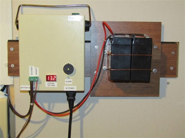

This is a picture of the completed unit mounted with its battery pack on the wall alongside the mechanical mechanism that closes the water valve.

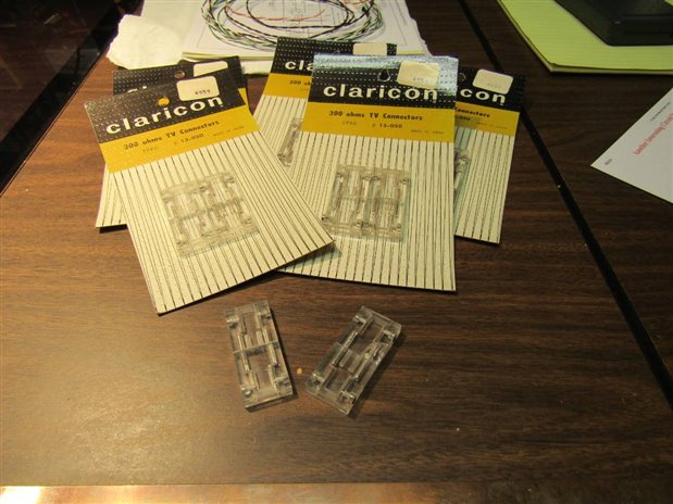

With the control built, tested and installed next to the mechanical system it was time to add the sensors. One of my goals when planning for connection of the sensors was to have them easily removed for purposes of replacement or testing. I needed a simple low voltage 2 conductor connector. I also wanted it to be cheap. I remembered years ago there was a nice inline connector that was used for 300 ohm TV / FM antenna cable. A call to my local retro electronic parts store had the owner digging. I think I made his day when he found and I bought these little beauties:
Well at $1 per card of two maybe I didn't make his day but it sure made mine.

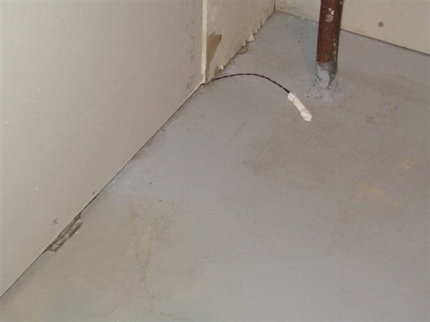

Here is a picture of the sensor that is at the water main entrance of the house. You can see the 2 pin 300 ohm inline connector tucked under the wall board.
