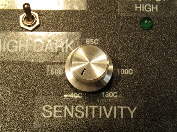

I am using a DPDT toggle switch on the unit to give me the flexibility to transition from High output to Low output on the Interface in either direction, Light to Dark, or Dark to Light. The LED tells the state of the output and the potentiometer allows the operator to adjust the sensitivity to fit local light conditions.

Since I was still in the mood to upgrade the Interface I also made a Thermistor Sensor for it. The thermistor was chosen to work with the Interface in the range of 40 C to 130 C as I guessed that this might be a range that would be usable for me. Now I will be able to monitor and time processes that involve things that gradually heat up or cool down.
The sensitivity control was labeled with approximate transition temperatures for future use of the thermistor sensor.
