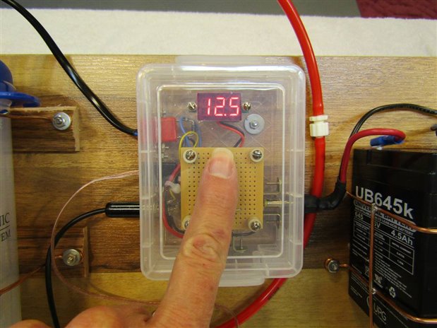

A small Volt Meter circuit was incorporated in the control box so I could check the level of the battery and recharge it when needed.
Control Box Picture
The control box is very simple with the Volt Meter and a momentary switch to activate it, a single P Channel MOSFET, Jacks for: Batteries, Charger, Pump, Solenoid, and actuation switch.
Pictures on inside the Control Box
