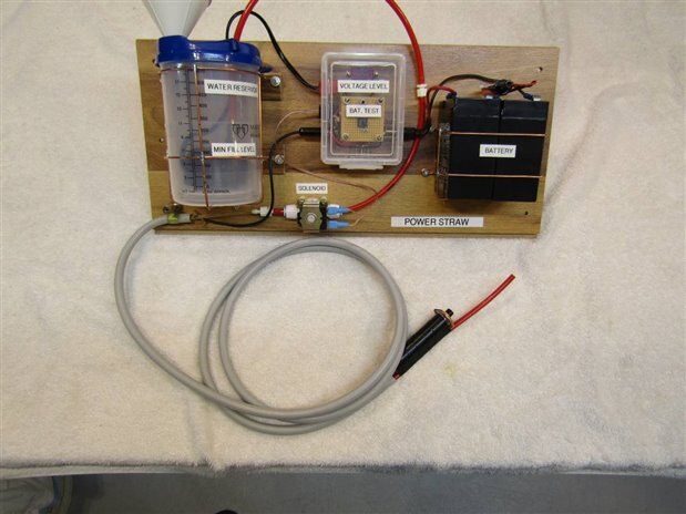

Recently on her bad days she has been too weak to draw the thickened water she has to drink up a straw. This causes her to become dehydrated and quickly affects her health. She is very stubborn and will not allow herself to be fed by other than by herself. To help her in the days that she is too weak to drink through a straw  I have constructed this little device to assist her. I call it a Power Straw. It is very light on electronics so perhaps it does not have much application to our electronics site but since I had published previous projects I though a few of the guys would be interested.
Here is a schematic of the project:

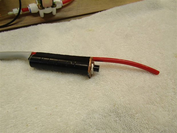

I began the project by collecting a variety of potential components. My Goal was to draw her thickened water from a reservoir and pump it up a line and into her mouth. She is accustomed to using a push button call switch when she needs help from an attendant so I decided to use a very similar switch to actuate the pump.
The water line would run axially with the switch and its wiring. The switch could be held in her hand and the water feed line would continue past the switch by about 4 inches.
Picture of Hand Switch

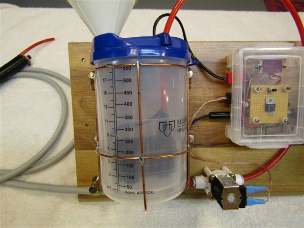

I decided to try a small 12 volt water pump, that is usually used in small fountains, to pump the water from the reservoir.
Picture of Pump in the Reservoir
My first prototype did not include an in line solenoid. This created a problem if the cord accidentally fell to the floor as gravity would siphon the water from the reservoir and create a big mess on the floor. My final prototype needed a solenoid.
Solenoid Picture

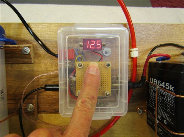

A small Volt Meter circuit was incorporated in the control box so I could check the level of the battery and recharge it when needed.
Control Box Picture
The control box is very simple with the Volt Meter and a momentary switch to activate it, a single P Channel MOSFET, Jacks for: Batteries, Charger, Pump, Solenoid, and actuation switch.

The Reservoir is an lightly insulated hospital drinking cup that I brought home after a past overnight adventure.
Picture of the Reservoir.
Here is a picture of the finished project before I took it to Mom's room and nylon strapped it to the back of her wheel chair.
Picture of completed assembly
I can see room for many improvements. The parts that I ordered and received did not meet my imagined specifications. For example the pump could have a little more power and the solenoid draws too much current. While the batteries will be heavy enough to deal with the present solenoid, ideally, I should be able to find one that uses 200 mA or less instead of the current 400+ mA. I have made the reservoir and hand cord easy to disassemble for cleaning but improvements can be made. The plugs that were used on the pump and the solenoid were not polarized. While this will not affect the solenoid it is important the the pump spin in the correct direction for maximum efficiency. I have marked the non-polarized plugs but someone other than me might miss this detail. For the time being however Mom is happy and after the newness wears off she too will have some good suggestions for her sonny boy on how he can make it better.

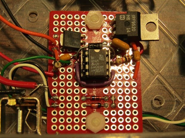

    I was watching for this problem when I ran the tests on the bread board. If there was a reset delay it was not detectable by human time standards. As quickly as I could release the trigger and push it again another full power boost to the motor was available. It is really pretty cool that we got such an elegant solution. Anytime a fix can be made with three parts that still fit onto the original circuit board without extensive redesign I am very happy.
    dougw over 10 years ago in reply to jw0752

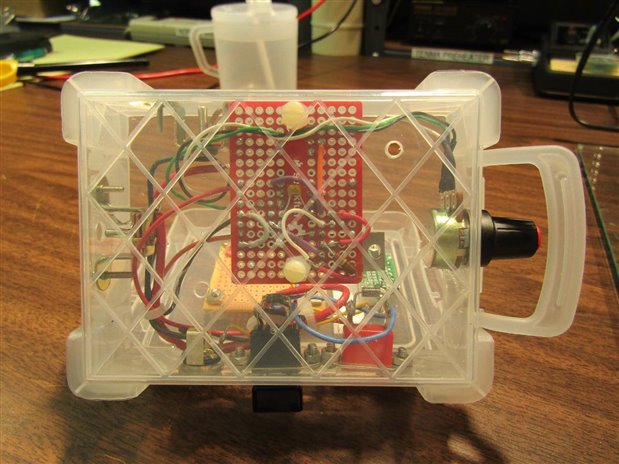

    I just thought of something... the circuit may not be able to restart quickly, because the new capacitor might still be charged.
    If this is a problem, a diode across the 220K resistor will discharge the cap as the rail goes down.
    jw0752 over 10 years ago
    I found room on the existing board to add the dougw 3 part modification using a P Ch MOSFET, a 1 uF cap and a 220K resistor. Here are pictures of the modified circuit:
    The IRF9520 in the upper right corner is the P Ch MOSFET and the capacitor is also pictured here. The resistor is mounted to the reverse side of the board.
    Sorry I remounted the board before I thought to take the picture. The resistor in question is in the lower right hand corner of the board. After modification the unit was tested and it dependably gave an approximate 1 second full voltage boost to the peristaltic pump before settling to the PWM setting. Now I can reinstall it into the test machine in Mom's room and see what the next bump in the road turns out to be. Once again thanks to Doug and Jan for their valuable recommendations that have made this improvement possible.
