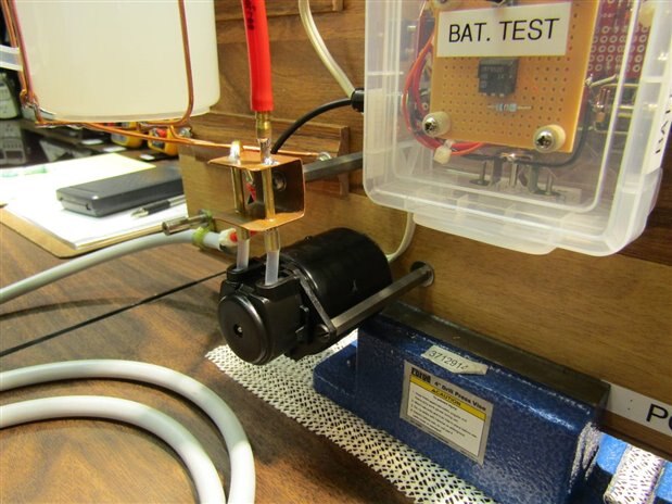

    Here is the next iteration of the prototype using a peristaltic pump.
    The first thing to note is that the reservoir holder has been changed so that it will accommodate the standard drinking cup that is used in Mom's nursing home. Rather than messing with pouring the thickened water that she has to drink into a separate reservoir all the staff has to do is replace one cup with another and insert the red hose into the straw hole. I mentioned thickened water. I never realized this but if one is not able to swallow properly water of regular consistency can pose a greater danger of choking. For this reason they give Mom a special thickened water that is easier to swallow.

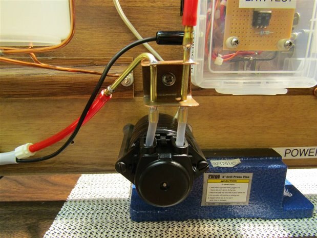

    Here is a detail picture of the cup holder:
    The red hose from the cup goes to the inlet of the peristaltic pump. The pump itself is controlled by a variable pulse width modulation generator in the control box. I was very pleased with the small peristaltic pump as it is capable of moving 75 milliliter of the thickened water per minute when the pump is running at 12 volts. Since the control box (See Red Capped Knob on top of the control) allows me to control the PWM 0% to 100% I can reduce the output of the pump as needed so as not to over run Mom's ability to swallow. Here is a detail of the peristaltic pump and the manifold that I built to interface with the feed from the cup and the line to drinking tube.

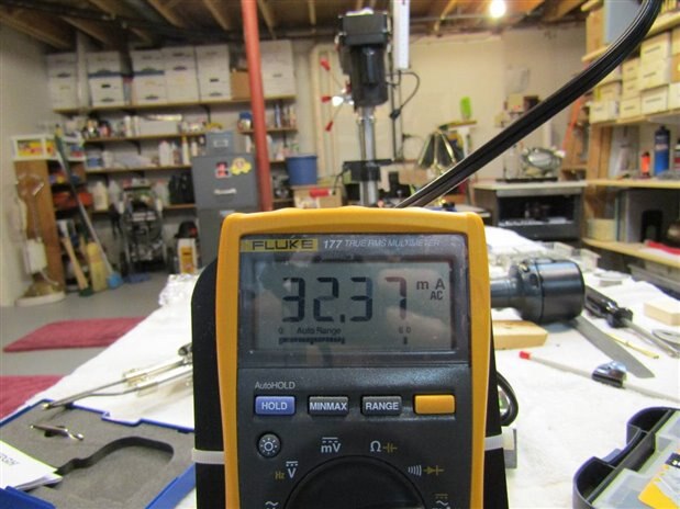

    One of the very pleasant surprises was that the peristaltic pump only drew 32  mA at the full 100 % PMW level. This is more than a magnitude reduction from the 500 mA + current needed for the first prototype. Current calculations suggest that the battery should be able to run the unit for a couple weeks at a time without recharging.  Since the Peristaltic pump pinches the line continuously there is also no need for a solenoid to prevent siphoning. Check out the ammeter reading for the pump.
    For the fun of it I made a video of the pump in action. Check it out.
    The unit is now back attached to Mom's wheel chair and she has been using it for a day. We will be watching for other problems and opportunities to improve it in the coming days.
