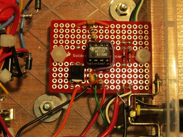

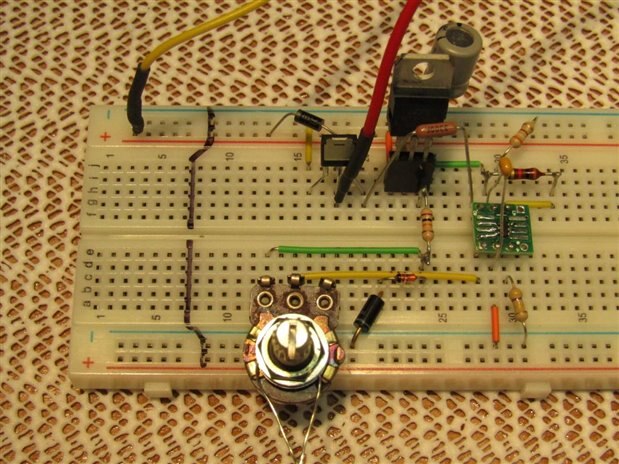

    I have begun the process to make improvements to the Power Straw. While I wait for the Peristaltic Pump, recommended by  dougw , which should arrive in two days, I have busied myself redesigning the control box. I want to control the dosing rate of the peristaltic pump so that the proper amount of water can be dispensed. Jan Cumps  had a good idea that I should use the LTC6992 voltage controlled PWM chip that I reviewed a couple weeks ago. I bread boarded this circuit last night and had it working very satisfactorily. Unfortunately the max voltage for the LTC6992 is 5.5 volts. Since I am running the Powered Straw from a 12 volt battery it was necessary to incorporate a 7805 regulator and related components. Here is what the LTC6992 circuit looked like.
    To simplify I decided to go back to my old standard NE555 circuit driving an NTD4906 N Channel MOSFET. The 555 will run directly off the 12 volt battery which eliminates the need for a regulator and for this application I do not need the precision of the LTC6992. Here is a modified schematic for the Power Straw in this iteration and a picture of the completed and installed circuit upgrade to the control box.
    It is easy to see the simplicity and component reduction using the NE555 as opposed to the LTC6992. Here is a wider shot of the inside of the control box so that it can be compared with the pictures in the body of the blog.

    jw0752 over 10 years ago in reply to Jan Cumps
    Hi Jan,
    You are right, I will have to look into using that chip. Too often I investigate the new chips and then when it is time to make something I go back to the old ways. Frankly I was thinking 555 and the new chip would be much better. It's good I have you guys to keep me headed in the right direction.
    Thanks John
