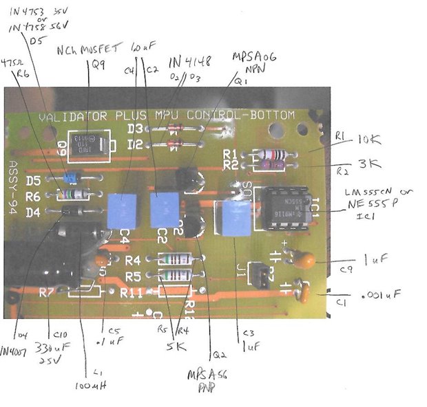

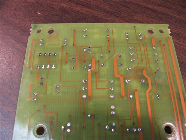

My interest had however been captivated by the small group of components on one end of the board that was responsible for taking  +12 and  + 5 volt input supplies and outputting 24 volts and 40 volts to be used in the OLED display circuitry. Here is a picture of the board of interest and a closeup of the section responsible for the voltage conversion. At this time I had not yet realized that I was dealing with two distinct converters.
Over View of Display driver board
Closeup of 24V and 40V synthesis section
Back side of the board. This is a two layer board fortunately.
My first step to reverse engineering the circuit was to identify each of the components and to label a layout of the board. Fortunately I found that none of the components were OEM and that all were common and available in the shop parts supply. Where appropriate to understanding the circuit, Data Sheets were accessed. Here is the parts layout with labels.

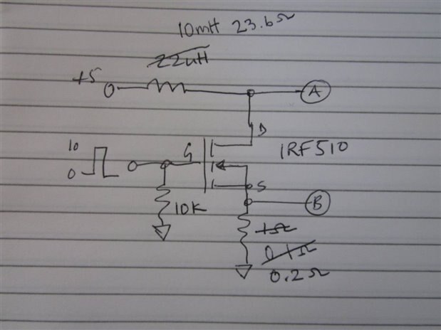

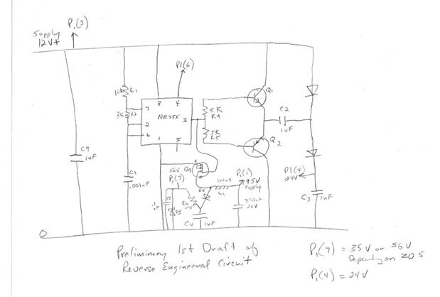

The next step in the reverse engineering process is to create a schematic. This involves getting the component symbols on paper and determining their interconnections. For me this means a lot of time flipping the circuit board back and forth from front to back, visually tracing the the traces and vias, and using the ohm meter to verify connections. After a while, a rough draft of the schematic is produced by hand. A close inspection of the schematic and application of circuit logic often forces me back to the board to make sense of the circuit and to correct obvious gaps.
While it is possible to work off a crude schematic like this I always like to clean up the work and make a CAD schematic. Obviously, I got into a little trouble in the lower center of the hand produced schematic and we will clean up this section in the CAD production. Drawing freehand while reverse engineering a board usually leads to a messy first draft. Here is a CAD rendition.

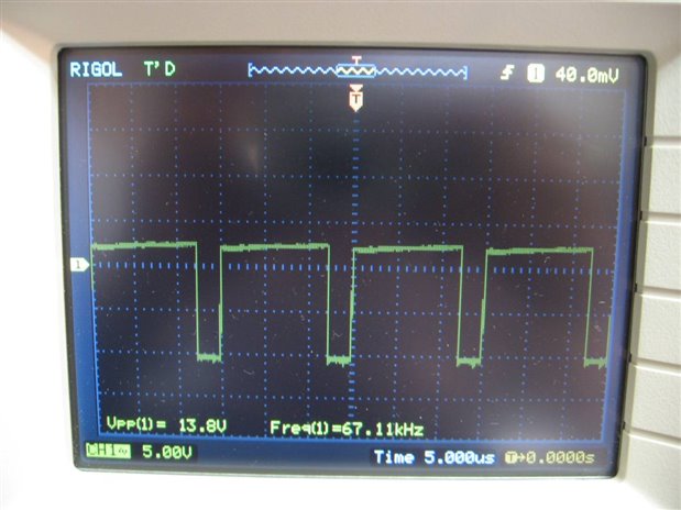

With the schematic in hand it became clear that we actually had two converters on this board working off a single astable multivibrator. The 555 timer in this case is providing a 67 kHz 12 volt square wave. The section of the circuit that produces the 24 volt output uses this signal to drive a push pull set of NPN PNP general purpose transistors. The transistors in turn drive a voltage doubler with a 24 volt output. The 40 volt output is produce by driving an N Ch MOSFET with the 555 signal. The input voltage for this section is only 5 volts. When the MOSFET is in saturation energy is stored in the 100 uH inductor L1. When the MOSFET turns off this energy is released through diode D4 and stored in capacitor C4. Since the impedance is quite high the voltage is also quite high. Resistor R6 limits the current to Zener diode D5 which serves as a voltage regulator. Output in this case 40 volts is taken from the point in the circuit marked P1(7). C5 helps to decouple transients and noise from the output. C10 provides a reserve of current to L1 when the MOSFET turns on.

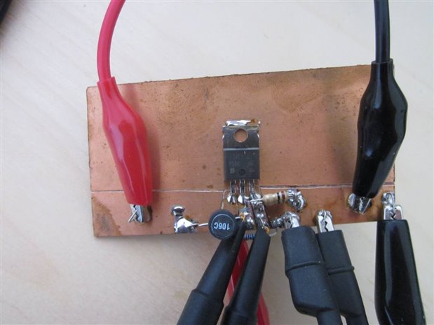

Now that we have the schematic the fun begins as we will bread board the circuit from the schematic to see if it will work as hoped. Here is a picture of the circuit bread boarded. Fortunately, except for the Zener, I had all the correct value components in the bins so I did not have to place an order.

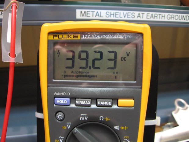

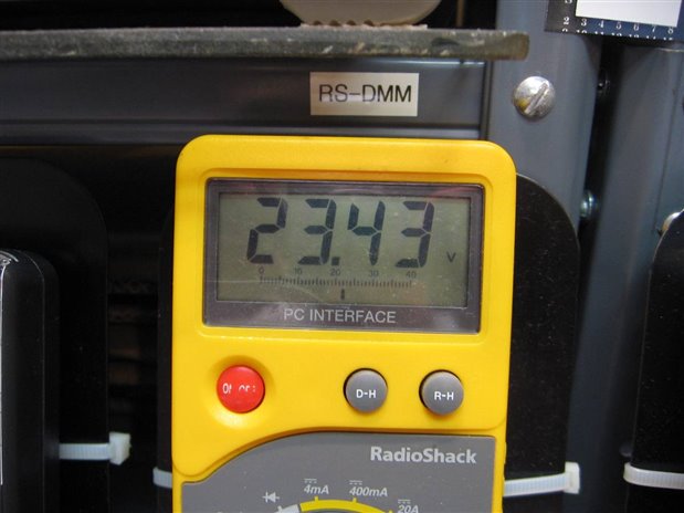

For my initial test I have supplied +12 volts to the main rail and +5 volts to the MOSFET section of the circuit. I have an oscilloscope monitoring the output of the 555 astable multivibrator and I have DVMs on the 24 volt and 40 volt outputs. This is very unusual for me but it actually worked the first time. No Smoke, No Fire!  Here are the outputs as displayed by the test instruments.
Sorry for the poor image. I was too lazy to export the image and just took a picture of it.
This is my 40 volt output point. Since I am using 2 Zeners in series and probably do not have them in their optimal operation mA range I feel the 39.23 V is acceptable.
The regulation of this output is tied to the regulation of the 12 volt input of the circuit and I am very pleased with how close it came to 24 volts. The circuits that are using these voltage supplies are not precision and can tolerate a range of voltage.
The last thing that I did was to load the 40 volt circuit with a 10 K resistor and measured the voltage drop. The 10 K load produced a 2.39 Volt drop. Calculations indicated that the supply has an approximate 650 ohm ESR. At least 475 ohms of this ESR is the series current limiting resistor. I have left the test jig set up on the bench and will play with it for a couple days before tear down. I found this exercise helpful as I can see application of the concepts used in these 2 voltage converters will be useful in future designs.

    The 40 volt part has a classic boost converter in it.
    I've redrawn your schema a little bit to make that more apparent.
    Here's the classic drawing (taken from Analysis of Four DC-DC Converters in Equilibrium )

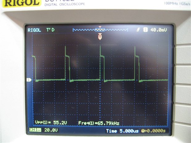

    I added a 10 K load across the output and the voltage became 37 Volts.

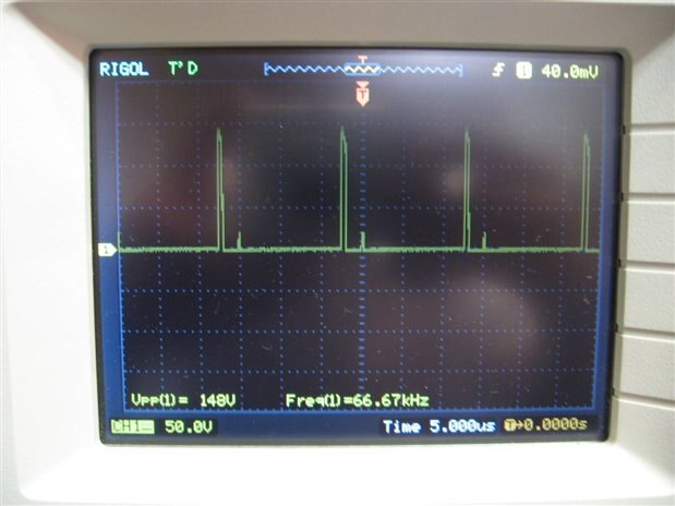

    Another interesting anomaly was that when there was a load on the output (Zener or 10K resistor) the current draw on the 5 volt supply would equal 110 mA but if there was no load on the output the current draw would increase to 250 mA.

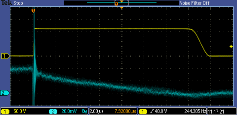

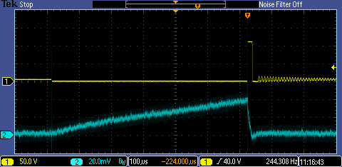

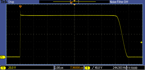

    Here is the signal on the gate of Q9 (I'm using an IRF511)
    Here is the signal on the drain of Q9 with a load on the output.
    Here is the signal on the drain of Q9 with no load on the output
    We are at almost 2X the max Vds rating on the IRF511 at this point. It hasn't seemed to cause any damage to it but I have only run it for short periods of time. The 250 mA draw on the 5.1 Volt supply is however causing the MOSFET to get a little warm.

    Jan Cumps over 10 years ago in reply to jw0752
    Great. Within a certain range of load current znd frequencies, the L and C only have influence on the ripple, not on the DC voltage on the end of the converter. Only duty cycle D is the real factor that plays a role for that.
    the Coursera free (and excellent) online training: 'introduction in Power Electronics' discusses switching converters in detail.
    ... and as you have experienced, there needs to be a path (in this schema: a load resistance connected) for the coil current to escape. Otherwise the voltage there will be very high (in theory, it goes to infinity, but lucky for us, there are some losses). The FET and /or zener will die a painful dead without an escape path for that current.

    To back up what Jan has explained, the equation V=Vg/(1-D) only applies to continuous operation.
    By continuous and discontinuous we are talking about the current through the inductor. If it never falls to zero it's continuous, if it does fall to zero before the end of the cycle it's discontinuous.
    In discontinuous mode, the regulation is very poor. The output will keep increasing (a small step up each cycle) until there's a reason for it to stop - for this circuit, normally the zener and resistor combination [and OLED] apply an increasing load once it gets above the zener voltage.
    In their absense, it could be various things, worst of which would be the capacitor breaking down. In this case though, from what you've said, I'd guess it's the body diode of the MOSFET that you're using providing an alternative path to ground for the current. (The body diode avalanches at a voltage above the maximum Vds, and that would be a reason for the FET getting hot. You probably aren't hurting the MOSFET much - the datasheet shows a graph where they test at 5A, so your 250mA is quite modest by comparison.)
