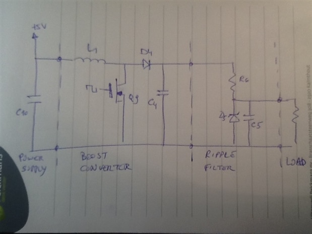

    The 40 volt part has a classic boost converter in it.
    I've redrawn your schema a little bit to make that more apparent.
    Here's the classic drawing (taken from Analysis of Four DC-DC Converters in Equilibrium )
    Jan Cumps over 10 years ago in reply to Jan Cumps
    In theory, the output voltage (before R6) should be:
    V = Vg / (1-D)
    Where V = the output voltage
    Vg the supply voltage (5V)
    D the duty cycle (you could check the duty cycle of the NE555 output with your Rigol's Measure functions, let's say it's 90% here)
    -> V =5V / (1 - 0.9) = 50V
    It would be cool if you could check that duty cycle going into Q9's gate, and the voltage before R6 to see if the equation holds.

    I'll throw in a warning here that you are going to end up with a large capacitor charged to 130V with no real load to discharge it quickly afterwards. I know that you don't need the warning because you used to work with vacuum tubes, but others might not be so aware.
    An alternative to doing the experiment slowly, would be to do it quickly using your scope. If you put a low value resistor (less than an ohm - perhaps start with 0.1) between the source of the FET and ground, the voltage across the resistor would be proportional to the current (and one end is ground so it makes for an easy measurement with the scope). During the time that the FET was on you'd see the current ramp up as the coil established its magnetic field and poured energy into it. Normally, when the FET turned off the current would fall to zero because the coil's energy passes to the output capacitor through the diode, but if the FET diode breaks down you'd see the current ramp down again because the path would now be through the FET.

    For a Zener, the temperature coefficient is something like 0.1% per degree, so if this behaves the same and you cool the part with a freezer spray (which I assume is what you mean you did), the change would be several volts downwards in the Zener voltage which would tie in with the current increasing. But it's not quite proof that my guess is right - just suggestive that it might be. What happens above 129V? Does the voltage keep rising?
    So far it's not too stressful for the FET. The power is involved is 1.25W, which the package can manage to deal with without a heatsink, and the current at 129V is less than 10mA average so we aren't into the realms where bond wires are going to melt or anything like that. The energy is limited to what goes into the coil's magnetic field each cycle, so it's not like connecting the device to a PSU that will just blast it to pieces. If you're worried, you could reduce the size of the inductor to reduce the energy further.
    As you say, we're certainly way beyond the design parameters. I hope we're not encouraginging anyone to design outside the datasheet - a cardinal rule of professional design is that you always work within the parameters set by the manufacturer.
