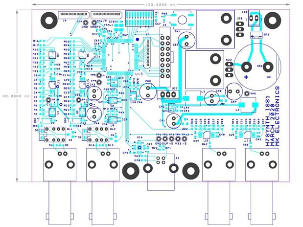

PCB Design is complete, I'm using the 100 pin TQFP STM32H743VI processor which no one in the uK has in stock. I've ordered some from the US but with the Covid situation I'll wait until the processor actually arrive before I order the boards.
I'm going to give www.quick-teck.co.uk a go - prices nearly as keen as direct China buying but with the advantage of local currency and shipping, so no mystery about eventual price.
The board has the following features:
2 DC coupled input channels with relay switched 10:1 attenuator, buffer amp and 4th order anti-alias filter.
2 DC coupled output channels with 4th order anti-alias filter.
512 byte EEPROM for calibration info
Full debug connector on processor supporting serial or parallel trace (you'll need Keil Ulink PRO or ULINKplus) to get trace.
Power supply on board (almost - it doesn't have a transformer  - needs about 6V AC).
Connector for Bridgetek display (SPI to intelligent display controller).
USB COM port type FTDI chip with USB connector.
120mm x 80mm
Board top side:
The schematics are in .pdf files, when I work out how to add those I will.
