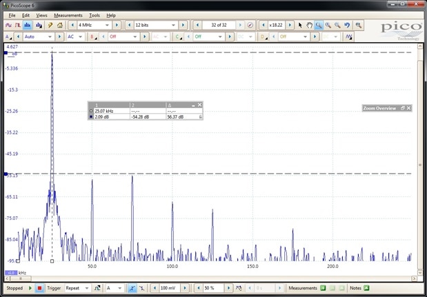

Here a some spectra measured using a Picoscope, sine wave frequencies 2k, 25k, 37k5, 99k, 100k:
This is about as bad as the spectrum gets, harmonic distortion is low at about -60dB (0.1%) but there are some nasty spuriae close to the fundamental and only about 50dB down.
