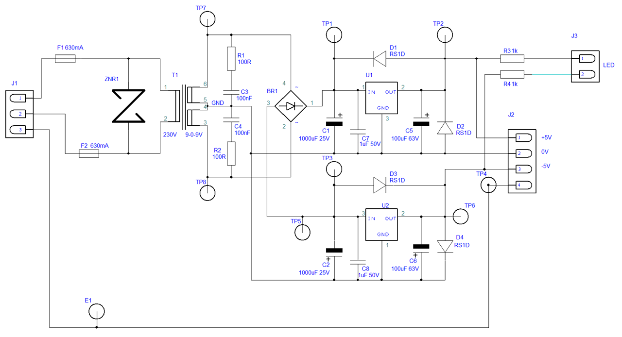

The complete circuit looks like this:
The mains supply (230V AC, no provision for other voltages) comes in via an IEC filter socket and a single pole switch in the live side. These connect in to J1.
Pin 3 of J1 is connected to the case of the filter socket and via screws to the aluminium enclosure.
Live and neutral are fused on the PCB by 630mA soldered in fuses. ZNR1 is a surge suppressor (Panansonic ERZE11A391, 250V max working voltage, 320V breakdown).
The transformer is a Block 2.3VA part with 9-0-9 secondary and rated as a safety isolating part. I really don’t want these supplies failing and damaging me or the test gear they are connected to.
The rest of the design is very straightforward using good quality capacitors. The caps across the unregulated supply are Wurth 10000 hours rated parts and would, at first sight, appear to be generously rated for voltage. (More on this later.)
Diodes D1 to D4 are referenced on the 7805 and 7905 data sheet but are usually omitted. They cost pennies and make the supply much more resistant to common fault conditions – so should be used for a general purpose supply.
R1,R2, C3 and C4 are there to reduce the noise from the bridge rectifier – I confess to not having measured the noise without them !
The bridge rectifier is a Diodes ABS10A-13 with a forward voltage drop at 1A of 1.1V.
The output is not connected to mains earth but mains earth may be accessed via connector J2 if required. My current design uses 3 pole output connectors so the mains earht is not available to them.

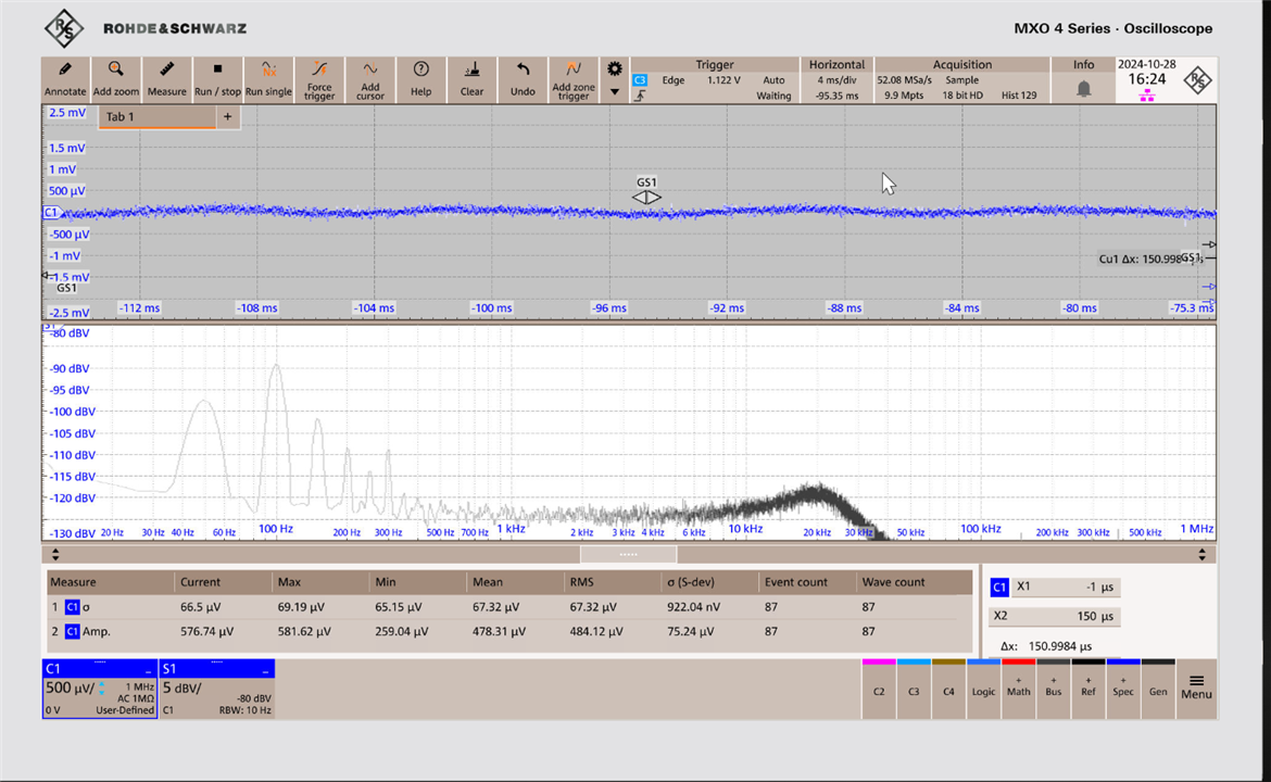

Noise on the positive rail

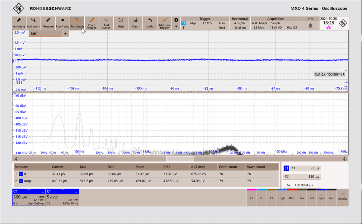

Noise on the negative rail
All 5 powers supplies had very similar noise results.
The 100Hz noise on the negative output is worse than that on the positive output (by about 6dB) and this shows in the measurement statistics window at the bottom of the screenshots.
The averages for the 5 PSUs were:
Pos pp-pk noise 425uV
Pos RMS noise 38.6uV
Neg pk-pk noise 495uV
Neg RMS noise 67uV

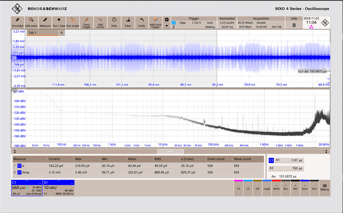

This is what I see with the power supply connected up to mains and scope but switched OFF:
All that horrible HF fur (shown very clearly in the top scope trace) is making the measurements look horrible. But it can't come form the power supply because its not even turned on !

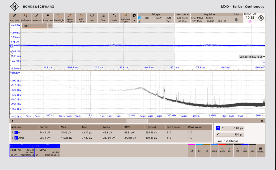

I added a big fat earth wire from the PSU case to the signal ground:
And the noise (supply off) is satisfactorily reduced:
Although it could be influenced by moving the power supply about on the bench, the few inches of unscreened act as a reasonable aerial at 20MHz.
And with the supply switched on:
 Even over the 20MHz bandwidth the dominant noise is the mains ripple.
The RMS noise over a 20MHz bandwidth is 45uV - way better than the bench supplies. With a bit more work it could be improved further because most of it is mains ripple and an improved PCB layout and/or bigger caps could solve that.
