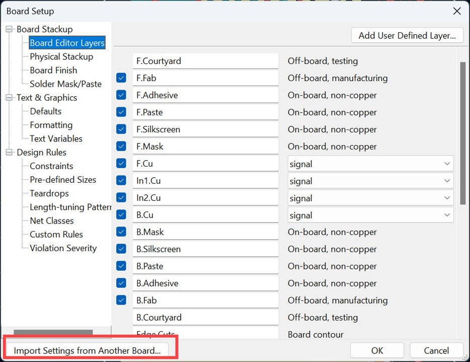

In PCB Editor click the Board Setup button.
Click Solder Mask/Paste under Board Stackup
Enter things for solder mask expansion and solder paste relative clearance.
So of course KiCad lets you set these things globally and its actually in a sensible enough place !

    Regarding the Board Setup, a neat thing is that now for all future projects, you can import the settings; there is a place to click that at the bottom of the Board Setup window.

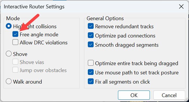

    Now that that is sorted, when laying down copper using the X button, you can set the copper to snap to the grid at any angle, by going to Route->Interactive Router Settings and enabling Highlight collisions->Free angle mode.
    It's a bit tedious, but if say you want the initial leg of copper to be at precisely 90 degrees (e.g. so it comes off an IC pad squarely) for a short distance, and then have the complete free angle, then the only method I know is to start off with the Free angle mode box unchecked in the Interactive Router Settings, and draw the first part of the trace, which will inevitably have the 90 degree line followed by a 45-degree line often. Once the mouse left-button has been clicked to place those two lines, then hit ESC twice to exit the trace drawing mode, and then click on the unwanted 45-degree like, press DEL to delete it, then, hover over the end of the 90-degree trace, press X again and hopefully it will connect to the end, and then right-click the mouse and in the pop-up menu, select Interactive Router Settings, and then enable Free angle mode. Now you can continue the trace, drawing at any angle.
    The 45-degree mode does have an advantage in that the 'Shove' mode can be selected in the Interactive Router Settings, which might be useful when trying to route wires close to each other. Personally I don't use the Shove mode often, but it's interesting to try it out in case the need arises.
