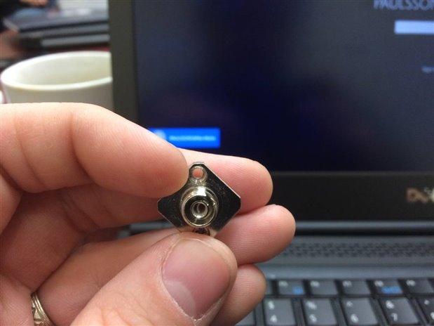

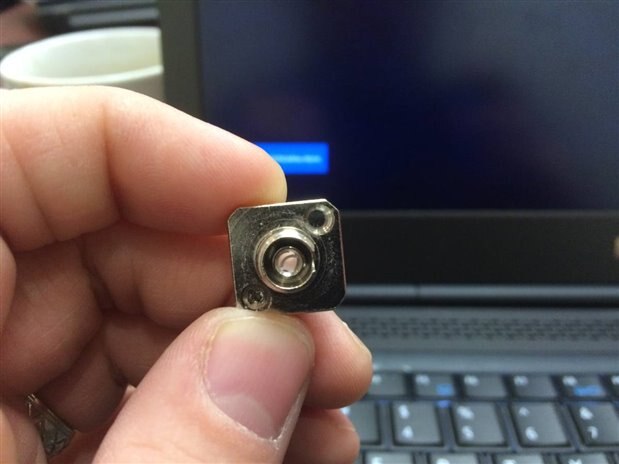

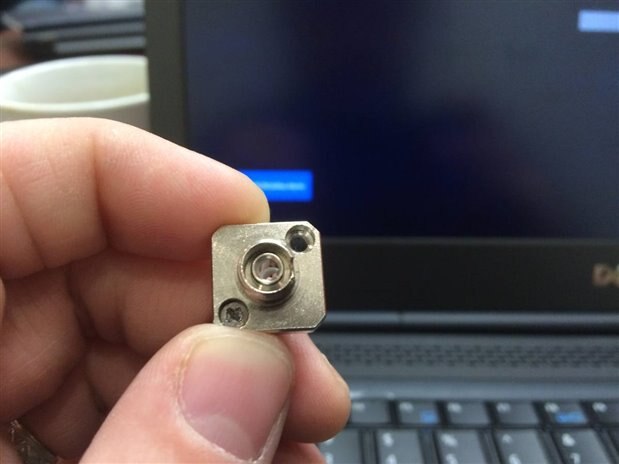

I work with Fiber Optics these days (fiber sensing to be precise). I'd just come back from a survey and I was hooking up the field systems for testing back at the office when I found this bulkhead adapter on the front of a circulator box. Look closely and you'll see a piece of the Zirconia sleeve has broken off and is blocking the insertion path for the fiber cable. If I hadn't noticed this, I probably would have ruined whatever cable I would have tried to insert. Sometimes you just get lucky ...

    jw0752 over 10 years ago +1
    Good catch, Always good to keep ones eyes open and don't assume things are as they should be. John

    DAB over 10 years ago
    Yes, with optics you must always verify that your path is free of obstructions and that your surfaces are clean.

    michaelwylie over 10 years ago in reply to jw0752
    It was really interesting, because I had never seen one fail like this before. I found out later, they were cheaply made adapters (I'll give you one guess where it was made). Apparently the good ones have metallic sleeves.
