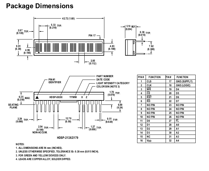

imageThis picture on the left is just to remind you all of what I am trying to get working.  Each HDSP-2131 display has 24 pins that give you 48 pins to deal with. Now let us complicate the issue the pins come out on a 30-pin connector of which 4 are for power and ground. So now I have 28 pins for the interface.image
Other people have used similar displays ie  Wise Time with Arduino and others. Most implementations I have seen use a Flip-Flop to load the characters, but why go to that solution? The Arduino Mega 256  has only 54 digital GPIO pins. My pin count is higher as  I needed 20 pins +  8 Data  = 28 pins + 5 pins for my switches (reduced to 3-bit BCD and one interrupt pin), CAN module on pins 53, 52, 51, 50,  and the USB driver and interrupts.  This makes my head hurt! image
So I freed up my 8-bit Data-Ports pins by using an 8-bit I2C port expander which is mounted on the same  PCB that holds the 30-pin header that the display plugs into.
My biggest problem is that the CAN libraries (Arduino) are Master-Slave.
But CANbus is democratic which means any node can become the Master.
  And this is where the problem lies.
I still don't have a clue where to mount my Arduino Mega. image  My CAN bus modules output will be routed to a USB-A  or an RJ45F connector.
So to speed up testing before  I use my jumpers.  The only pins I will be Wire-Wrap will be the Data Port to the display header.

    It's a lot of hardware and a lot of pins to deal with. Is your goal to stick with the original technology? I see you lower the count by using the expander. Maybe we can work together here to create a design…

    phoenixcomm over 5 years ago in reply to DAB +1
    DAB Nope I pan on using CANaerospace which is built on top of CAN specification itself, which is also "democratic". So there is more work than I can do in 10 days. ~~ Cris

    michaelkellett over 5 years ago in reply to michaelkellett +1
    Actually you don't need that many pins, I think you can common all the pins on the display chips except /CE, so for two displays you need only 15 pins on the processor. An ATmega168 in a 28 pin DIL package…

    phoenixcomm over 5 years ago in reply to ajcc
    or ajcc  The arduino will not run CANaerospace! but a Nucleo will. about 14 bucks. what I can do is To use 485 edlin Lib or  CAN itself. I can implement a subset of CANaerospae.

  • phoenixcomm
    phoenixcomm over 5 years ago in reply to michaelkellett
    michaelkellett Well you will suffer the transit times of the i2c bus for sure. I would have preferred a different CPU  that has a real address/data bus. The problem is that the Arduino as most other embedded CPUs really don't have the resources that I would like to have.  Now a 68008 would be cool, as all of its I/O is in the address space, but I don't have one laying around.
    ~~Cris
  • michaelkellett
    michaelkellett over 5 years ago in reply to phoenixcomm
    Ah, I see - it'll be a bit slow but I'm sure you know that and that you don't need to update the display fast.
    MK
  • phoenixcomm
    michaelkellett What I want to do is to use the original Display board and I made a control board out of vector board. The only thing that board will hold is the female header with long tails and an MCP23017 in a Wire-Wrap connected on the bottom this is protruding on top as well as the header pins. The expander has two 8 bit ports, which can be used separately. So I can use port -A for the addresses bus A0 - A4 and I can use port-B for the databus D0  -D7.
    I was going to use the TI  PCF8575 but I can not configure this as two (2)  separate ports.
    ~~Cris
    PS I will connect this to an Arduino Mega.
