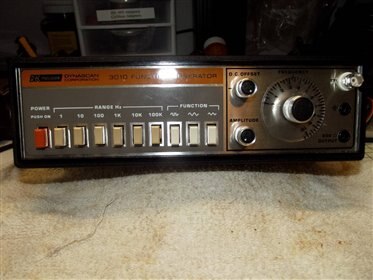

THENimage

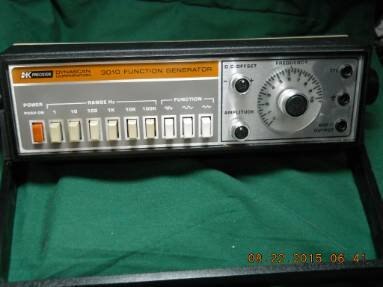

NOWimage
  • Black (Hot) and White (Neutral) ended up switched so 110 VAC ended up on my ground-plane! Push on connectors are a must! image
  • I replaced the bridge with 4 100vdc 5 amp monsters.  imageIt took quite a bit of heat to solder the big leads so I sub in an IR bridge  12DB6A
  • I have a lot of harmonics to fix.
  • The function generator parts still work. imagethat is to say triangle, sine and square wave are ok just with harmonics. Most likely killed some caps!
PROBLEMimage
DEAD DIODESimage
FIXEDimage
NEW BIG DIODESimage

  • phoenixcomm
    phoenixcomm over 6 years ago in reply to cstanton +2
    cstanton not sure, but there is only AC on the 600-ohm outputs. So I had do get some stiffer diodes(4) for the bridge!

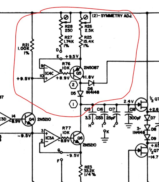

  • skan743
    skan743 over 5 years ago
    Currently he tried to repair the same generator for my studies, I have replaced capacitors and potentiometers in bad condition and at the moment I have managed to obtain all types of signals, however I have not been able to see them in the 600ohm output. Until Q9 everything works great (test point 11), however at the 600ohm output there is only a static -14.XX VDC and no AC signals.
    The TTL output works great.
    Any idea what might be failing? image
    As for the harmonics I recommend checking the symmetry in test point 1 ^^image

  • phoenixcomm
    cstanton when I put it back together by putting 115 on White and Neutral on black! ie I shot myself in the foot! image and the "harmonics" looks like an ungrounded scope probe!  image
