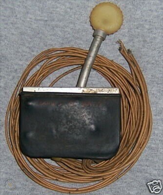

  • Landing Gear Control Lever (CANid: 1175)
  • 3 Red Indicators (CANid: 1400, 1, 2 )
  • 3 Green Indicators (CANid: 1403, 4, 5)
  • WOW, Weight on Wheels, (CANid: 1176)  this sensor, prevents Landing Gear retraction while on the ground. See the movie "No Highway in the Sky" about 1hr in. imageFor WOW to be TRUE all the sensors have to agree. WOW  on the main wheels is responsible for moving the front canard down, until there is weight on the nose wheel at which time the canard goes to 90 degrees to act as a speed brake. as well as enabling nose wheel steering.
  • Gear Down and Locked sensor (CANid: 1406, 07, 08)
  • Gear Up and Locked sensor. (CANid: 1409, 9810, 11 )
Aircraft have 3 wheels Left, Nose, Right. Each pair of Red/Green Indicator  shows the status of each  wheel:
  • RED SOLID, Gear UP, and Locked.
  • RED BLINKING:
    • Landing Gear Lever  UP  selected and gear not up and locked (gear retraction)
    • Landing Gear Lever DOWN selected disagrees with landing gear not down and locked (gear extension)
  • GREEN SOLID, Gear Down, and Locked
Landing Gear Lever
So to recap that's wires, 13 wires plus grounds. Since I only have two contacts, (UP & DOWN) on the Landing Gear Lever which is not used very much, I can catch them with an interrupt by putting a 2-input Or Gate followed by Schmitt Trigger connected to the Arduino Mega pins 20, 21. using the rising mode. You have to keep in mind that the switch once in the UP or Down position does not move, except in takeoff and landing, therefore the interrupt is detected on the rising edges.
