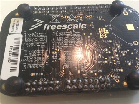

And this is the soldered side:
Like I said, I'm no expert. But I think I got some nice connections - the little pyramids are not looking too bad. I double checked with a magnifying lens to make sure I didn't short anything out. On a side note, that magnifying lens is part of the soldering "helping hands" I bought recently - highly recommended! I don't know how I ever soldered little bits without them. Probably because I used to have better eyes, steadier hands, and much more patience image
However, my soldered bits never look as nice and shiny as the ones you see on commercially produced boards, and I always end up with the flux sorta coating the area. I usually wipe around as best as possible using a kleenex and q-tips.
Can any soldering experts give me some advice on what I can do to change that?

    Hi Nico,
    I think it may rather be the type of solder. Some traditional solders have rosin flux, which works very well but does leave a mess (which can be cleaned with isopropanol - and a firm brush as you say, but you may wish to have an antistatic brush - I use this one, it has lasted years so it's worth the cost. (After the IPA, I believe deionized water can be used, but currently I'm using some MG chemicals mix of IPA and deionized water because that's all I had, and it gets the board spotless).
    You still need a flux-cored solder, but maybe a non-rosin based one; it will likely leave a clean joint (but will require a clean board and clean component wires).
    You may need a recommendation based on the country you're in. I use a UK-based manufacturer.
    Since most components are clean and untarnished, a non-rosin solder is good enough (bare copper PCBs need some cleaning however).
    This is just personal findings based on prototyping stuff - I'm no expert on commercial production methods.

    ntewinkel over 13 years ago in reply to shabaz
    Thanks Shabaz!
    I'll try the rubbing alcohol. I noticed in one of the tutorial videos that alcohol swabs can be handy too so I might get some of those.
    And I have a few other types of thin solder I can try out. I don't recall what type I have now, as the box is long gone, but I bet it's rosin-core like you said.
