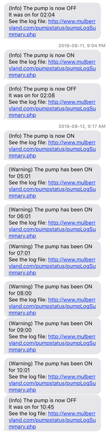

I quickly noticed that the pump is always on for about 2:07 (minutes:seconds), give or take 5 seconds. So I added some code for the WeMos to send warning updates to the server if the pump stays on for longer than 5 minutes (I will be reducing that down to 3 minutes soon).
So I've been happily receiving comforting text messages for the last handful of months since that first incident, until this weekend - of course while I was away on a mini-vacation.
This is what I usually see. Very comforting:
And here is when I knew the pump controller needed attention, not comforting at all! but good to know it works:
You'll noticed the top few are 02:04 and 02:08, which is very much along the lines of what I've been getting since I set that up... but then uh-oh!
The pump stayed on for over 10 minutes! EEEP! Luckily it turned off by itself or I would have needed to drive home to deal with it (we were staying overnight on the mountain - about 40 minutes away).

So today we dug it out again (luckily the lid is only a few inches under dirt) - and this time I pulled the sensor out of the tank completely and cleaned it up to where the panel reported it properly as 0.0 inches again. And I raised it up a few more inches just in case the tank gets too much sediment and gums it up again.
Turns out the sensor was reporting the level as 12" when in reality it was down to about 3 or 4".
