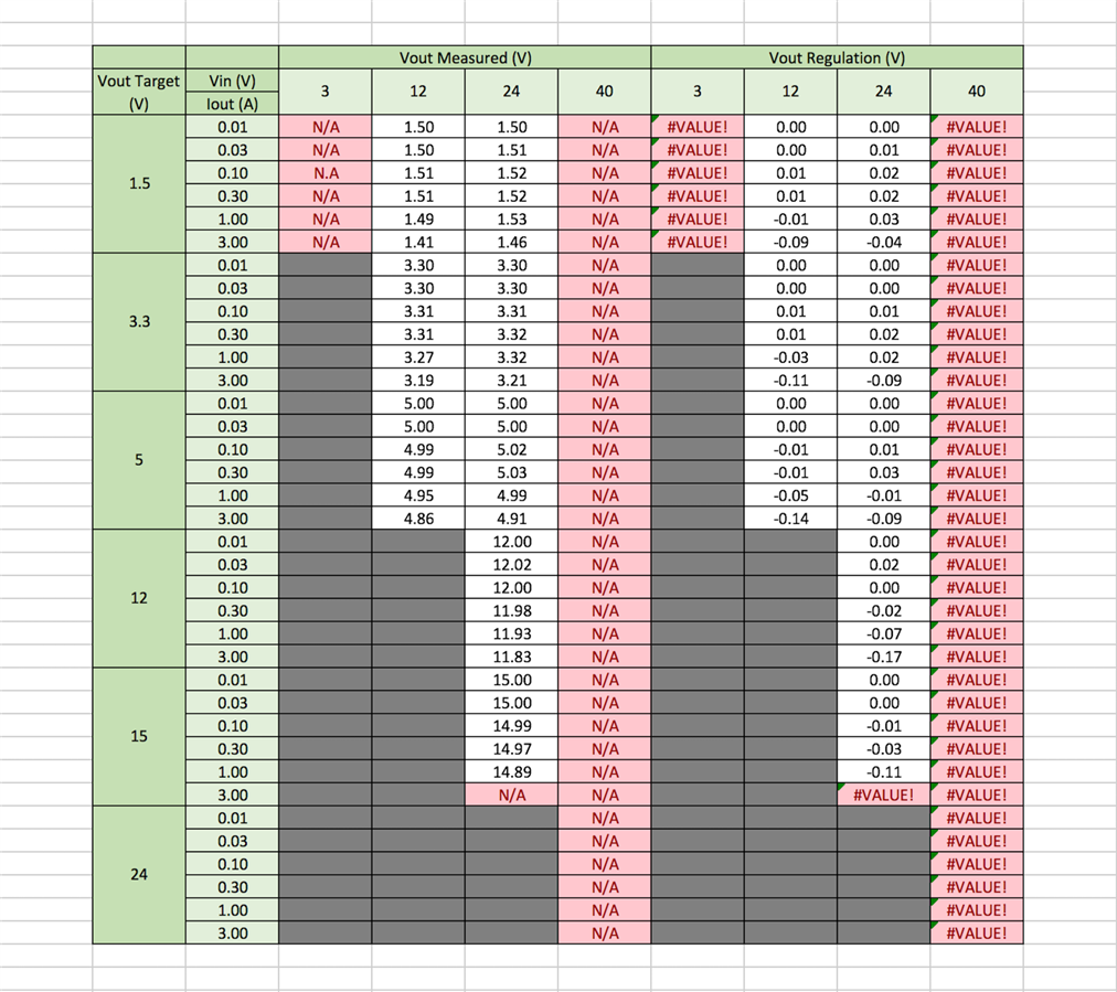

Measurements
The following table shows the measured input current for each setting of input voltage, (unloaded) output voltage and output current.
There are a few things to note in this measurement data.
Firstly I could get no meaningful output at 3V input even though the spec says it should work. I believe this is down to stability and could be fixed by changing the capacitors and inductors to values and types selected specifically for the lower voltage range.
I was also unable to get the output to hold up with 24V input and 15V output at 3A load. As I increased the load current to about 2.4A it would immediately collapse. It would also collapse at a much lower output current of a little over 1A if I tried to increase the load too quickly. This is a stability issue again.
Finally you will see the 40V input column is blank. As I set up for the measurements and applied the 10mA load the converter board failed an emitted the magic smoke. I believe it came from either the inductor or the voltage setting POT but it's now totally dead. I will take the components off and test them to determine which has failed for this to happen at such a low load.

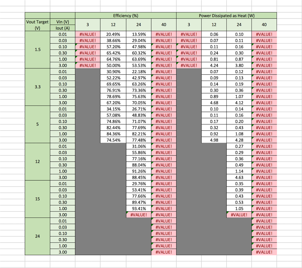

Efficiency
The following table shows the calculated efficiencies across the range of measurements taken above.
It can be seen from this that the board can have some very good performance with certain setup conditions. It peaks at 93.4% efficient at 24V input and 15V output with a load of 1A. I expect this was roughly where the initial design targeted the initial design parameters. The highest efficiency for a 5V output was again at 1A output but this time with a 12V input but it was much lower peaking at 84.4% which is still reasonable. The efficiency tails off some more at 3.3V output peaking at 78.7% at 1A load, with a 12V input.
Output Regulation - Constant Load
The following table shows the regulation in terms of voltage droop in volts across the range of measurements taken above.
For the most part, just looking at the voltage measured on the output on a multimeter the droop on the output under load is very slight. The worst case is 140mV at 3A load on a 5V output. What this doesn't show is how much ripple there is on the output and this will be measured on the oscilloscope once I have switched out for a new board.
