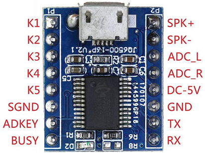

That inspired me to try out a similar module - the JQ6500 https://www.amazon.com/gp/product/B01N47M1V2/ref=ppx_yo_dt_b_asin_title_o00_s00?ie=UTF8&psc=1 .  I'll have to admit that I chose this one because it was available on Amazon Prime and I could get it in a couple of days.  These are much cheaper if you source them from China, but I don't have the patience to save a few dollars image.  And there is also a contributed Arduino library for the module.
These modules have their sound files loaded into flash over USB and they are configured and controlled via serial UART.  There is a built in power amplifier that can drive a speaker directly.  The other feature of this particular module is that there are 5 dedicated pins that can be used to select 1 of 5 sound files just by pulling the pin low.  Seems like something that would be useful to add sound to projects.
Pin Type
Pin Description
K1
Playback of Audio 1
K2
Playback of Audio 2
K3
Playback of Audio 3
K4
Playback of Audio 4
K5
Playback of Audio 5
SGND
Ground
ADKEY
AD port
BUSY
Play Indicator
RX
UART serial Data input
TX
UART serial data output
GND
Ground
VCC
5V power supply
ADC_R
Headphones/Amplifier(Right Channel)
ADC_L
Headphones/Amplifier(Left Channel)
SPK-
Speaker -
SPK+
Speaker +

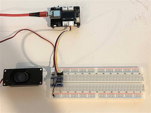

I just received my modules from Amazon today.  I've decided that since they are controlled via UART that I would use a Xiao with and expansion board to make the hookup easy.  I'll also probably use the display sometime in the future.
Here's a picture of my setup - the JQ6500 is on the breadboard at the bottom:

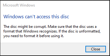

Electronics from China frequently have issues and these modules were no exception.  I connected a module to the USB port and discovered that it was not flashed.
Of course, no mention of this possibility or how to fix it in the documentation.  Luckily, this is apparently a common issue and I found a tutorial on how to flash the unit: JQ6500, recover a broken / unreadable module .  A little time and a small amount of pain later, I had flashed both of my modules and had access to the file loader over USB.
My first attempt to load MP3 files failed because the module only has 4 MB of flash for storage and most of the MP3 files I have around are larger than that.  I downloaded a free "Ukulele" music file from bensound.com and loaded that (about 2 minutes duration - 2 MB).
The module has 5 dedicated pins that allow you to play the first 5 stored tracks just by pulling the pin low or to Ground.  I tried grounding the K1 pin and was rewarded with music image.
To use the UART control, I'm using an Arduino library by James Sleeman: https://github.com/sleemanj/JQ6500_Serial .  I modified the Full Demo example to run on the Xiao.  I am using the hardware Serial1 port as the UART to the module.

Here's a demo playing the "Ukulele" song:
When I have time later, I'll add a keypad (or pushbuttons) and display functions.  I think for some of my projects I'll just use it preconfigured and standalone, just using the pins to play individual files.
Sean was trying to use his modules by issuing control sequences directly over the UART without the benefit of a library.  I think that might be a fun thing to try with a serial terminal...

    Glad that you got it working.  The file must have gotten corrupted when you moved it.  I hadn’t moved it out of laziness I suppose...  I imagine I should get better organized in case I buy more of these.  Of course, if I wait too long they won’t be available anymore image.
    Ralph

    fmilburn over 5 years ago in reply to ralphjy
    Thanks Ralph,
    Got it working.  I downloaded a new copy of the ISO and left it in my download folder (before I moved it to a new more permanent folder) when using VMware.  Everything worked fine after that.  I noticed you left it in your download folder as well. It seems like I've moved ISO files around before on my hard drive without issue, but maybe not.  Always best to follow the directions exactly when you don't know what you are doing :-)
    Frank

  • ralphjy
    ralphjy over 5 years ago in reply to fmilburn
    Hi Frank,
    Yes, I am using the file jq6500-rescue-linux.iso (the older file was called jq6500-rescue-tool.iso).  I believe either file should work, but the newer one does not ask you to select the flash memory size.
    I followed the directions in this blog - http://www.lucadentella.it/en/2018/04/11/recuperiamo-un-modulo-jq6500/ .   I think I may have linked the YouTube video that was in Italian instead of English (sorry, but I think you figured it out).
    The blog was a bit dated so he used the old filename and was using VMware Workstation 14, but the rest of the instructions applied in terms of getting the iso to run.  The toolkit menu he used was for the old file.
    It seems that you may have set up your VM incorrectly, so you should check that you used the steps in the blog.
    Here are my VM settings.  You can see that the CD/DVD uses the ISO image.
    And the menu when the VM powers on.
    I didn't do anything extra that I can recall.  Maybe you should try downloading your ISO again.  Your VM seems to be complaining about no OS.
    Here are the two files that I downloaded.
    I did not try using Rufus or a live CD.
    Ralph
