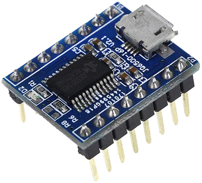

I recently saw a discussion by Sean Conway about an MP3 Player that he was attempting to control: Looking for member insight into the JR6001 Serial MP3 Custom Programmable Sound Recorder Module .
That inspired me to try out a similar module - the JQ6500 https://www.amazon.com/gp/product/B01N47M1V2/ref=ppx_yo_dt_b_asin_title_o00_s00?ie=UTF8&psc=1 .  I'll have to admit that I chose this one because it was available on Amazon Prime and I could get it in a couple of days.  These are much cheaper if you source them from China, but I don't have the patience to save a few dollars image.  And there is also a contributed Arduino library for the module.
These modules have their sound files loaded into flash over USB and they are configured and controlled via serial UART.  There is a built in power amplifier that can drive a speaker directly.  The other feature of this particular module is that there are 5 dedicated pins that can be used to select 1 of 5 sound files just by pulling the pin low.  Seems like something that would be useful to add sound to projects.

I just received my modules from Amazon today.  I've decided that since they are controlled via UART that I would use a Xiao with and expansion board to make the hookup easy.  I'll also probably use the display sometime in the future.
Here's a picture of my setup - the JQ6500 is on the breadboard at the bottom:
Electronics from China frequently have issues and these modules were no exception.  I connected a module to the USB port and discovered that it was not flashed.
Of course, no mention of this possibility or how to fix it in the documentation.  Luckily, this is apparently a common issue and I found a tutorial on how to flash the unit: JQ6500, recover a broken / unreadable module .  A little time and a small amount of pain later, I had flashed both of my modules and had access to the file loader over USB.
My first attempt to load MP3 files failed because the module only has 4 MB of flash for storage and most of the MP3 files I have around are larger than that.  I downloaded a free "Ukulele" music file from bensound.com and loaded that (about 2 minutes duration - 2 MB).
The module has 5 dedicated pins that allow you to play the first 5 stored tracks just by pulling the pin low or to Ground.  I tried grounding the K1 pin and was rewarded with music image.
To use the UART control, I'm using an Arduino library by James Sleeman: https://github.com/sleemanj/JQ6500_Serial .  I modified the Full Demo example to run on the Xiao.  I am using the hardware Serial1 port as the UART to the module.
