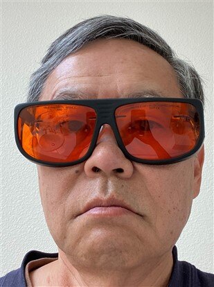

I had an exchange of messages with shabaz and Fred27  about laser safety and decided that before I get my laser module that I should get some safety equipment.  Here's what I decided to get.
Safety Equipment
  1. Protective eyewear
  2. Fire extinguisher
  3. Remote monitor
Protective eyewear
I took Shabaz's recommendation and got the LS02 Safety Glasses from Edmund Optical.  I am going to get a laser in the 450 - 500nm range and these glasses are rated with an Optical Density >7 @ 180 - 532nm.
This particular model fits over my prescription glasses.  I like that the working range is marked on the front of the lens.

    Very nice. This is really safety first, buying the safety equipment before Santa deliveries your gift.
    dubbie over 6 years ago +4
    It is good to see safety being seriously considered with lasers as it only takes one mistake. Eyes don't heal well after a lasering. An alternative approach would be to put the laser cutter inside a box…
    shabaz over 6 years ago +3
    Hi Ralph, Nice reminder about the extingusher, I need to get one too. The camera set-up is very cool! That style of glasses fits really well, I could not tell that there are prescription glasses behind…

    Nice post Ralph - it will be interesting to see how this progresses.  Sweet pair of glasses too.
