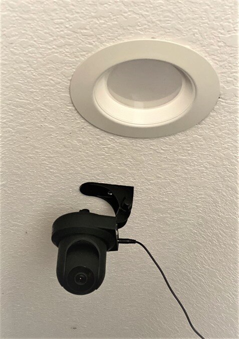

Remote monitor
I decided to mount a Pan/Tilt IP camera on the ceiling so that I could monitor the laser from the adjacent room on a computer or mobile device.  The pan and tilt capability also lets me monitor other activity in the workroom like when I am using the 3D printer.  I put presets in the camera for a wide view and also zoomed in views of the CNC router and the 3D printer.
A short video showing the preset views:
Warning light?
The other feature that I've considered is a warning light outside the door of the workroom to indicate that the laser is in operation.  That may be overkill for a home setup
