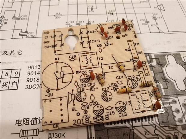

PCB Layout and Notes
The scan here shows the copper side PCB layout, with some of the important bits highlighted in red.
From what I can tell using Google Lens to do the translation, the quadruple tuning/variable capacitor needs the end with the two wires to be inserted in the red highlighted hole, because one side of it contains the FM capacitors (lower capacitance) but the side with the two wires that insert in one hole, is the AM side (higher capacitance).
Also, T2 is highlighted with a red square. T2 is the metal can with the core that is painted red.
For the electrolytic capacitors, the hatched/shaded side of the circles in the diagram above is the negative end.

    Hi genebren and jw0752 , We managed to solder all the resistors, and some of the ceramics today : ) The 8-year old was trained by showing him how to solder one resistor to scrap PCB, and then he tried…
    The 8-year old was trained by showing him how to solder one resistor to scrap PCB, and then he tried one resistor on the scrap board too.
    Then, he did the soldering and wire-clipping by himself, with me and his younger brother (6-year-old) assisting by searching for the component references. I did the resistor identification, and the 6-year-old did the number reading off the tiny through-hole ceramics. The 8-year-old is now confident pushing in the parts, using blu-tack to hold things down, and cleaning the iron and soldering : )
    The safety specs are too big, we need to find kid-sized ones. He's also now aware what a resistor looks like ("long stick with plastic in the middle") and capacitors too ("round with two sticks") and eventually figured out for himself that R and C referred to them : )
    The 6-year-old too was trained on a single resistor, but he's not had a chance to do any more yet.
    This will be a multi-week project I think! since they only have a few hours to spend each week. So we're predicting it will be finished in week 3 or 4.

    genebren over 7 years ago in reply to shabaz
    shabaz,
    That is some pretty good lead forming and soldering.  Looks like you have some fast learners there.

    balearicdynamics over 7 years ago in reply to shabaz
    Shabaz it sounds a very nice project. Just a question the resistor that crosses the IC does not need to be higher to place the IC under it?

    balearicdynamics over 7 years ago in reply to balearicdynamics
    It is impossible to edit the previous comment so I add this here. Is the IC SMD so it will be soldered on the opposite side?
    shabaz over 7 years ago in reply to balearicdynamics
    Hi Enrico!
    Yes, it's a rear-side soldered SMD part, not through-hole part (it's a large SMD, so I may get the 8-year-old to attempt that, to see what happens!).
    It is going to be guesswork for some of the parts, because I can't see how it fits the enclosure yet (there is one hole that could be for a screw, but it doesn't align with anything! so now I'm thinking it is held in place somehow maybe with some speaker clip.. not sure). Also a few through-hole parts may need to be soldered from the other side (and there is no silkscreen on that side) so I'm going to need to watch out for that. The AM/FM switch needs to be soldered from the other side, the only cutout for that is on the back of the enclosure.
