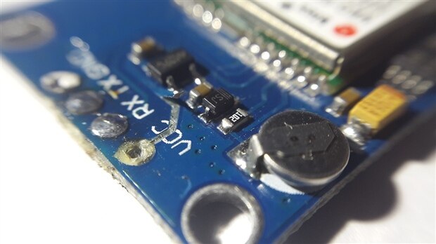

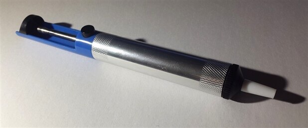

    Although they are meant to be used with electronics, these solder pumps never really works:
    I always end with up pealed off copper traces and molten plastic when trying to remove pin from a PCB:
    Or maybe, I'm using this tool wrongly...image

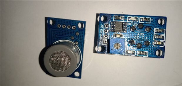

    And also avoid placing it exactly perpendicular to the PCB when de-soldering. Always place it slight angle and then you can save traces.
    Another suggestion is use higher wattage soldering iron (So you can melt it quickly and also avoid over heating the entire PCB) then add some solder on that pad. After melting the soldering first remove the component if its possible then clean up the pad.
    Yesterday I de-soldered these two modules with similar connectors and using only 12W image soldering Iron.

    Oh, I actually end up lifting traces with the soldering iron, not with the pump image. What happens is that, when I try to remove a component (ex. pins) or clean up holes to install a new component, my solder pump does not sucks up enough / all the solder. Often I need to repeat the pumping process again and again, so the PCB get overheated and the trace lifts up.

    phoenixcomm, I'm using a TS100 soldering iron at around 300-320°C. The problem comes when I'm insisting too much, like for 1+ minutes image, with iron and the pump. Then the PCB heats up very much and the PCB traces sometimes get affected this.
    I think, I should try out TCPMeta's method of using solder wick with flux. I sometimes use solder wick, but never tried it in combination with flux image.

    The solder gets melted as it should image. Is just the soldering pump that does not sucks up all the solder, so I keep trying to suck the remaining solder up again and again (while keeping the solder molten). This is how I end up with the PCB overheated. (Yeah, I know I should not do this way, but sometimes I'm a little bit impatient image).

    dougw over 6 years ago in reply to Attila Tőkés
    The solder sucker should cleanly suck all the solder in one try. To get this to happen, the suction tip needs to be very close to the molten solder - essentially touching, and almost no air gaps around the suction tip.
    The iron tip generally gets in the way of getting the suction tip to an optimal distance, so you need to remove the iron and quickly position the suction tip properly before triggering the suction and this needs to happen while the solder is still molten.
    Often you will need to add solder to the area before trying the suction process - this is to add thermal mass so the solder stays molten long enough to get the suction tip in place.
    It takes some practice to get a feel for how much solder is needed to stay molten and how hot your iron should be, and exactly how close the suction tip needs to be, and how fast you need to be to get a clean shot.
    It will help if your work-piece is securely held while you work the tools.

    shabaz over 6 years ago in reply to Attila Tőkés
    It is possibly the solder sucking tool itself. With the tool I'm using, if I push down the plunger, I can feel the air draft caused by it from more than 30 cm away. With that, solder has little chance of not being sucked up, provided it is positioned ok, and the solder is fully melted. On the other hand, with a different manufacturer solder sucking tool, it is a lot more hit-and-miss.
