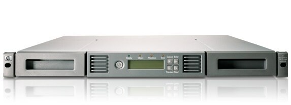

    Since I was a child I have always tried to repair broken electrical or electronic objects, from tube televisions to amplifiers or car radios. The results were almost always disappointing but this way I always had recycled electronics for my lab!
    The most important repair I think I did in a company where I worked years ago.
    The tape backup drive where we did the daily website and email backups had failed. It was an HP tape library worth several thousand euros.
    While the purchasing department was looking for a new one to replace it with the utmost urgency, crying for the expense to be incurred, my curiosity prompted me to "see" the fault. In reality I was very curious to see this splendid machine that I had always seen inside a rack and had never taken apart (taking things apart is one of my fixations ...)
    Opening the top panel was great, it was a really gorgeous, beautiful device!
    A mix of top-level electronics and precision mechanics. Seeing the tapes and sleds used to move them up to the heads was a dream.
    I went back to being a child and I thought about the opening theme of a Japanese cartoon in which the robot pilot arrived at the cockpit after a journey made of shifts, rotations and other movements.
    It must have been my admiring glances or the cleaning I did to the slides and gears but, as soon as the panel was closed, the tape library started working again and even today, after years, it still does its job.
