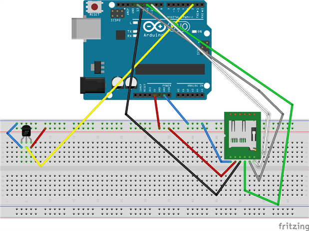

Hello,
Today I would like to share with you my second little project. Its an Arduino temperature logger which saves data on micro SD card and thanks to a short Python script it can also send data to Ubidots IOT application. The circuit itself is very simple, in order to complete it all you need is:
11 - jumper wires
1 - 4.7K ohm resistor
1 - DS18B20 temperature sensor
1 - SD card reader
1 - Arduino UNO
Here's the circuit's schematic:
