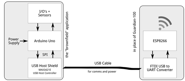

This time I had the time available and I had a problem to solve, i.e. I wanted to replicate a “brownfield” use-case scenario that could be used with the USB port on the Guardian 100. So, I crafted up the following top-level design:

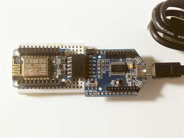

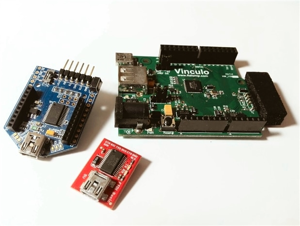

Thankfully, the Guardian-100 uses an FTDI USB to UART controller and the Arduino USB Host library provides an example for the FTDI USB driver. A big tick then for the choice of component used on the Guardian-100 as there are many other USB chips out there that do not have ready made open source libraries, or it's more difficult to find the right information.
I happened to have two versions of the FTDI USB to UART controller as a breakout board and I even had an old FTDI Vinculo development board, which has since been discontinued. Either of the two breakout boards were ideal for my purposes as I could then attach either of these of my ESP8266 Huzzah breakout (from Adafruit), which does not include a USB to UART controller.

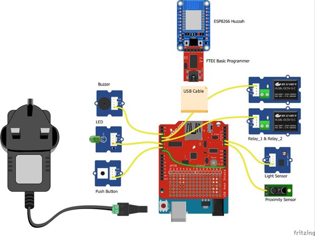

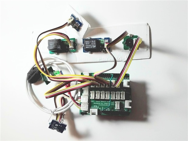

The “Brownfield” USB Host Application

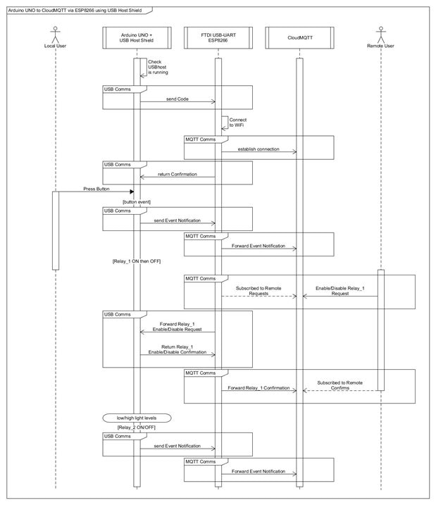

My “brownfield” USB Host application is based off an Arduino UNO microcontroller. The application's functionality is as follows:
  • a momentary push button is used to monetarily trigger relay_1. This is used to simulate a gate or a door and anything that could be actuated when the button is pushed.
  • The light level, as measured from a light sensor, determines whether relay_2 is triggered. If the light level is below a threshold the relay remains on until the light level rises above the light threshold level. This could be used to turn on a light, for example.
  • A proximity sensor is used to trigger the buzzer. A change in proximity state triggers the alarm. This could be used to monitor if an enclosure housing the electronics is open or closed.
  • A green LED is used to inform the user of connectivity status. If the USB host shield is “running”, i.e. it detects that an FTDI USB driver is connected on the other end of the USB cable then the LED flashes, otherwise it is just stays on. If the USB peripheral (as in the ESP8266) confirms it has connected to the MQTT broker then the LED turns off. There is already a power LED that tells us the Arduino UNO is powered on.
  • All event notifications are sent via the USB host to another USB controller device, which then forwards the data to the cloud via an ESP8266.
  • A remote user can communicate via the cloud to enable or disable the relays and the buzzer.

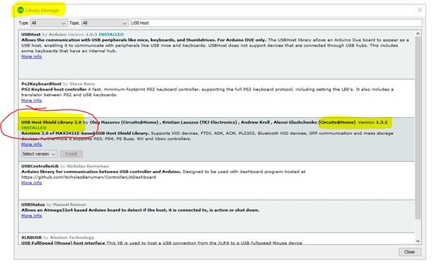

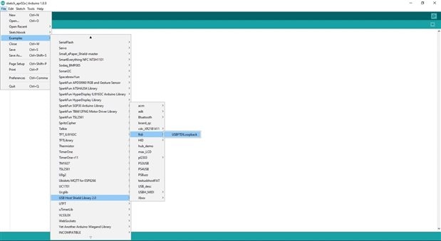

I found that with developing USB Host application, it is quite straightforward when you know how. The big "gotcha" with using the USB Host shield is that you need to use an external power supply with the Arduino UNO and you need to connect D7 to the Arduino Reset pin for the USB Host library to function properly. I wasted a good few days struggling to get the USB Host shield to work when my Arduino UNO was just powered by the USB cable attached to my computer. The requirement to use a separate power supply is buried in the detail - I found this tip in one of the comments on the Sparkfun website product page and then subsequently on blog somewhere.
The USB Host library I used can be found on GitHub: https://github.com/felis/USB_Host_Shield_2.0
Another convenient way to install this library on your Arduino IDE is to use Library Manager:

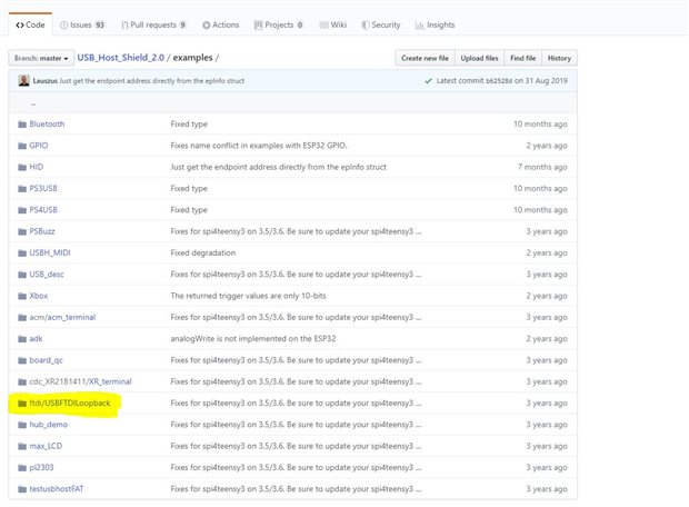

Once the library is downloaded you are presented with quite a few examples. The examples provided can be split into a number of categories, namely:
  • Game Controller (PlayStation/PS & Xbox)
  • MIDI control;
  • HID control;
  • Bluetooth 2.0 SPP (Wii game controller examples found here too);
  • CDC (Communications Device Class) Serial Terminal;
  • USB Hub; and then
  • Test & Utility functions.
I found that debugging / fault finding is quite tricky, especially when you have not powered your Arduino UNO with a separate power source. There is one utility example called “board_qc.ino”, which I found quite useful and it is well worth starting out with this example. This example runs through a number of “quality checks” and provides feedback on the serial monitor.
When the USB host shield is confirmed to be working, what we're then after is a CDC Terminal example that talks to a FTDI USB to UART driver and the example that is compatible is called “USBFTDILoopback.ino”. Note that there are three other CDC terminal driver examples available too, namely “acm_terminal.ino”, “XR_terminal.ino” and then some examples for “pl2303”.
{gallery:autoplay=false} USB CDC Terminal Examples Available
To make sense of this example and to help visualise the different run states I modified the code a bit to include some logic for a blinking LED. I used a fast blink LED when the USB Host fails to initialise and a slow blinking LED when the runtime “getUsbTaskState” check shows that the USB State is not shown to be running (i.e. not equal to USB_STATE_RUNNING).

Using ESP8266 to connect with CloudMQTT

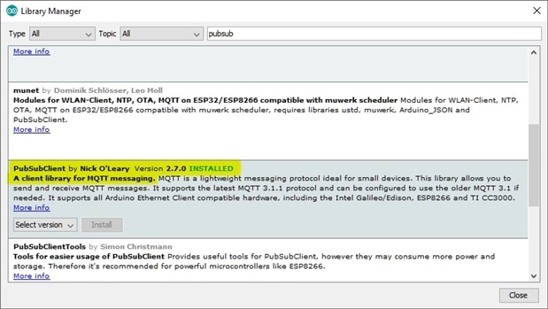

As indicated above, I'm using an ESP8266 to connect to my WiFi router in order to establish a connection with and transmit data to cloudmqtt.com using MQTT as my publish and subscribe Internet transport protocol. Cloudmqtt is a hosted message broker for the Internet of Things and it has a free option for testing, although I believe the free instance option is sold out (so if you have a free account then great, if not you'll have to pay $5 per month for the “Humble Hedgehog” plan).
To get my ESP8266 to use MQTT I used an example found in the “PubSubClient” library, called “mqtt_esp8266.ino”. This library can be downloaded using the Arduino Library Manager:
I had to make a few minor tweaks to include the authorisation details and once this was added, I could then send and receive data from cloudmqtt. It was as simple as that.

    BigG over 6 years ago in reply to neilk
    I see the Wemos d1 Mini uses the CH340G USB chipset and the ESP8266 Feather uses the CP2104 chipset. I don't believe these are covered by the USB Host shield library. I did come across another USB Host module from hobbytronics in the UK which does handle these two chipsets and loads more. I'm sure once you've dissected the datasheets it will become apparent what parameters need changing.
    https://www.hobbytronics.co.uk/usb-host-serial
