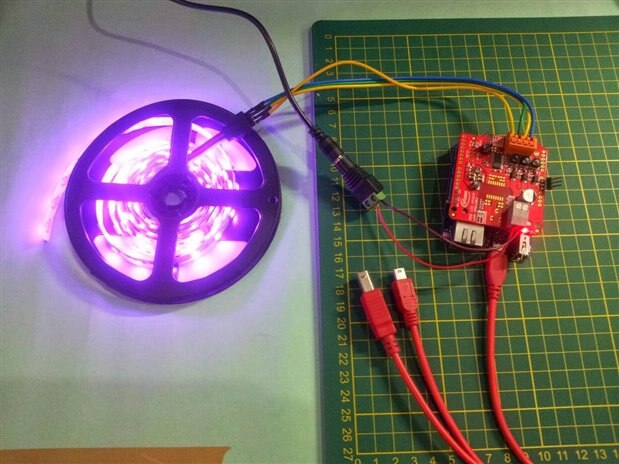

Connecting the Shield - Infineon RGB Shield -The Static Element
In order to control the LED Strip, we use the [Infineon RGB LED Shield] 2452190 and the Arduino YUN. The shield does not come with headers and I don't have any  handy either so I had to improvise. I added a limited number of burg strips which I had in longer lengths and made a temporary mount. The image below shows the same.
I made a library and it is available on GitHub for you to use and it is available at https://github.com/inderpreet/infineonrgb_shield . Getting started is easy as using the LAMPTEST Example. I tested it out and the control works pretty nicely.
In Order to control these lights to produce a specific color, I used MQTT to send across the color. This can be done via the demo by kartben or via OpenHAB.
I did a post on this at [Dynamic Living-room Lights] The YUN talks to OpenHAB . You can select the color but thats not enough. We need to make the lights dynamic light the title of my project. Hence I need to add a dynamic element.

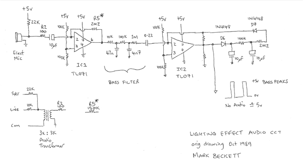

The area where the Infineon RGB LED Shield Shines is 'flicker free' dynamic control. Hence the idea is to use an Audio Signal to control the color at a fast rate. I searched online and came across a tutorial by @sciguy14 for the arduino. I don't need two channels but just a single channel. And the circuit is simple and is shown below.
This circuit is a modified version of the one by @sciguy but works well for me. @mcb1 gave me another circuit and might be useful for a lot of people.
The final circuit is shown in the image below.
I have an Audio IN and Audio Out so I can chain devices if needed. The input buffer makes sure the devices are not loaded much and audio quality is not tampered with. The filtered signal is fed to the Arduino where I use a modified code to generate 12bit data for LED Control. @sciguy14 uses code for 8bit color control which is good for NeoPixel type of stuff. I did a small video clip to explain the circuit and code which I will include in the next post because it has two parts of the system explained in one. I did a teaser video which show how the circuit works according to music being played.

    mcb1 over 11 years ago +2
    It is getting there. I'm sure if you keep hinting about 3D printers someone might listen ... but in the meantime you need to do the same as we do and use something else. Mark
