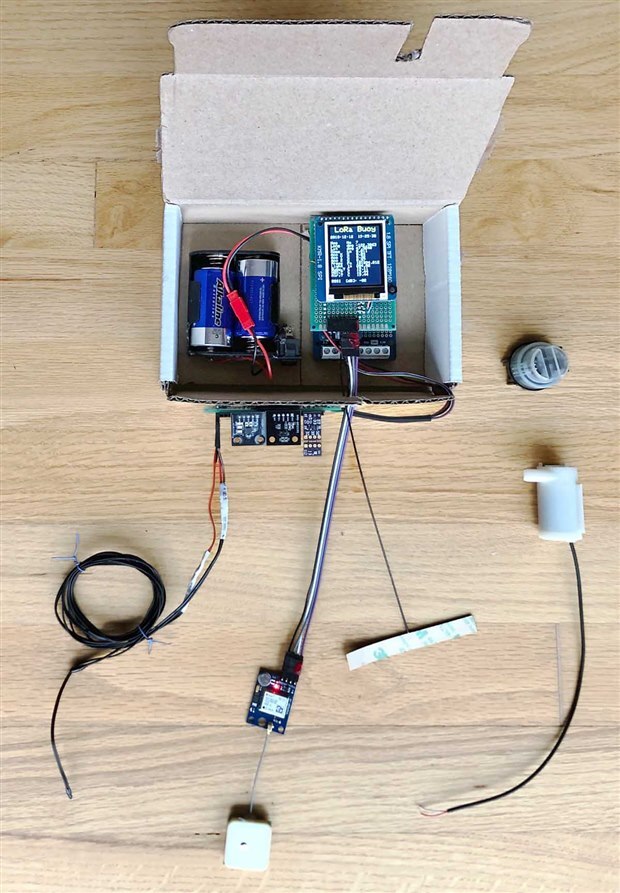

I am prototyping an intelligent buoy (that evolved into a boat) that uses LoRa to communicate with a base station using the Arduino MKR WAN 1300 as part of the Build A Smarter World promotion by element14 and Arduino.  This post is the third in a series, and an extension of last week where the project began the movement from a breadboard onto something more robust and suitable for field use.  This week additional sensors were added and a small board to hold sensor modules was constructed.

A new hand wired board was constructed to hold the I2C modules and thermistors.  All other modules are mounted on or connect by ribbon cable to the daughter board that was described last week.  Power can be supplied from either USB or two "C" batteries.  The modules and parts have been attached to a cardboard box with Velcro and will be more permanently attached after the buoy is constructed.
This is the minimum implementation.  Also shown unconnected in the photo above are a turbidity sensor upper right and a small pump.  Both require 5V which is not currently available but may be implemented in the first floating prototype if time permits.

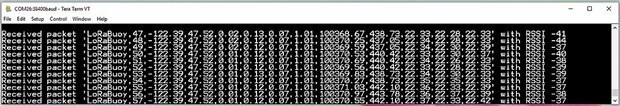

Sensor Output
The sensors all seem to be working well and giving accurate results.  Results are sent to the base station as comma separated values and displayed for now on a terminal window.
The sensor readings can also be viewed on the TFT screen at the buoy or if the buoy is connected to a computer on the serial monitor.
Distance Tests
With the addition of the GPS it is now possible to get a more accurate estimate of distance between the base and the buoy.  My guesstimates of the distance were off last week and the distance from my home to the test site is closer to 700m than a kilometer.  During the week I was able to move the test out over the water where there is more unobstructed line of sight between antennas. Reception improved from -122 dB to -115dB.
