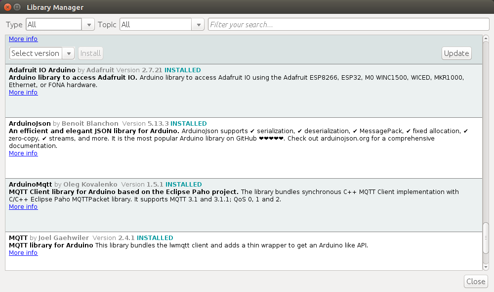

   To run this example, I started with the Examples->WiFiNINA->WiFiWebClient to get the remote connection to the router set.  Once the communication was proven out, the ArduinoMqtt, Arduinojson, and MQTT Libraries were added to the Arduino IDE via  Sketch-Include Library->Manage Libraries menu option to get to the Library Manger window.
From the Library Manger window, install ArduinoMqtt, Arduinojson (version 5.13.3), and MQTT. Once these are installed, they can be included in the Arduino IDE Project.

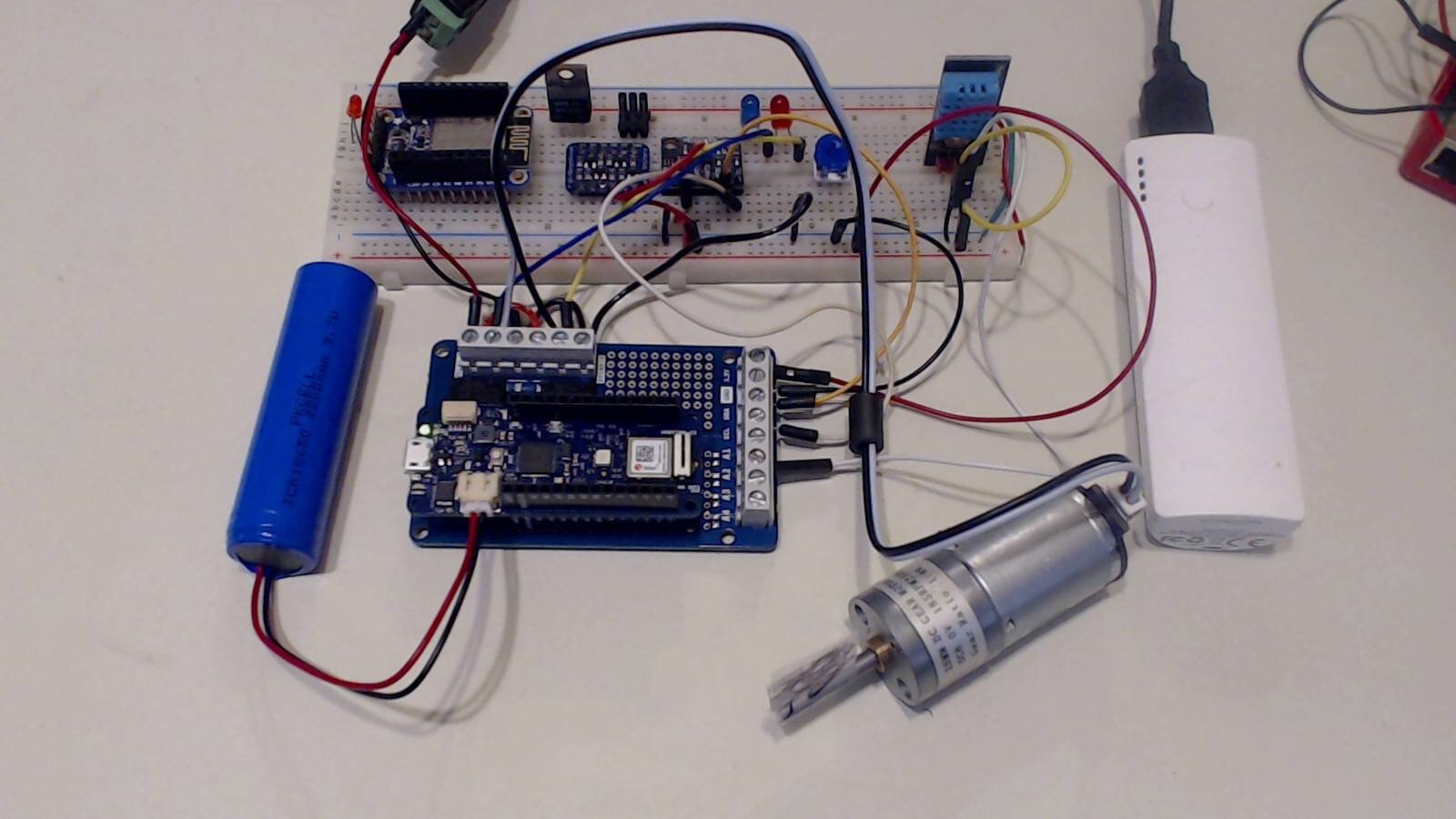

To control the Relays from the Relay board, both relays can be controlled in one Publish command.
$ mosquitto_pub -h 192.168.2.130 -p 1883 -t '/hello' -m "{"cmd1" : "on" , "cmd2" : "on"}"
To control the direction of the motor, one command (relay setting) has to be off, while the other is 'on'.
$ mosquitto_pub -h 192.168.2.130 -p 1883 -t '/hello' -m "{"cmd1" : "off" , "cmd2" : "on"}"
If both commands are the same value, the motor stops.
When this is run, the MKR1010 processes the MQTT commands quite quickly with very little latency.  This would work nicely for applications needing a low power remote solution.
MKR1010 and MKR Relay Shield in action.
