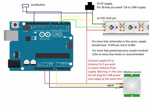

Wiring pointers:
To place the PIR sensor in a place that was optimal, I had to extend its leads. I used several 12” jumper wire extensions on each lead. Several end-to-end. It isn’t the best way to go about it, but it worked.
You can power the whole thing off of USB power, or a single power supply. However, you will overdrive the onboard regulator. It’ll get pretty hot. I recommend having a separate power supply for the LEDs, beyond the one on the Arduino.
Schematic and design:

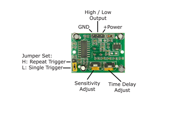

Here is the pin-out for the PIR sensor I used. There was no stencil indicating what was what. So, here it is.
