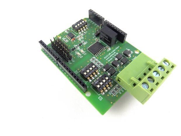

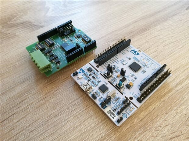

I'm working currently on a professional RS422/RS485 shield for the Arduino UNO (and compatible boards) and other SBC with Arduino style headers (like STM Nucleo) . I wasn't satisfied with the shields on the market. They are very simple and have some disadvantages. My shield comes with the following features:
  - RS485 mode (half duplex)
  - RS422 mode (full duplex)
  - galvanic isolation between Arduino and connected RS485 bus
  - free choice of TX-pin between pins 0-5
  - free choice of RX-pin between pins 0-5
  - enhanced ESD protection
  - adjustable automatic transceiver switching for RS485 mode
  - adjustable control of transceiver/receiver via pin 6 or 7
  - adjustable Pull-Up, Pull-Down und terminating resistors
  - indicator LEDs for RX and TX
  - removable block terminal for bus connection
  - many options adjustable via DIP switches
  - stackable headers
  - can be configured for 3.3V and 5V logic

    We got the first batch of Arduino RS485 shields - fresh from the factory:

    Test run of a RS485 connection of a Raspberry Pi (left position), Arduino 101 and Arduino UNO (right).... This setting can be extended to up to 255 devices and a distance over 1km https://www.hwhardsoft…
