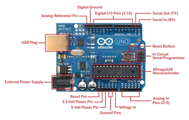

The Arduino I showed in the video was a revision 3 board, there have been a few versions so far, in the image (from zenbike.co.uk) you can see an earlier version, but it nicely maps out the connectors on the board. I think in the recent version the reset button has moved, but that makes little difference overall. What it doesn't note on the image is that any socket with the ~ (tilde) symbol next to it can be used as a Pulse Width Modulation output. This is a way of having a digital signal pretend that it's analogue but typically you don't need to worry about this until you've got some hardware that you need to output to which needs it.
The first instruction we can make the Arduino perform is to flash an LED, which is often considered the "Hello, World!" of getting started. The example code 'Blink' will do this for you, it flashes the LED marked 'L' on the board. This LED is also linked up with the breakout pin '13' like many connections on the board, some go through components and others do not, but they ultimately connect to the ATMega328 micro-controller processor on the board, which is the brains of it all.
