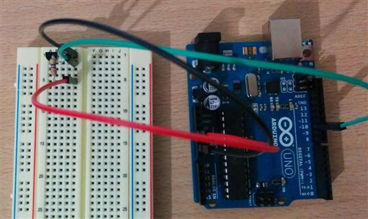

Along with the Arduino IDE installed onto your computer. When you have your parts, you will want to plug them into your breadboard and there is a specific way to plug them in to complete the circuit. Here is an example of a completed setup:
So at the moment, this looks like a mess of wiring in a dimly lit photograph (I guess that's partly what it is). However, there are some directions that can be taken to supplement this photograph. On a typical breadboard there is a grid referencing system. As you can partly see in the photograph it is labelled A to J along the columns across the top and numbered from 1 downwards for the rows. So simply we can wire it up thus:
  • Insert the DS18B20 to the breadboard. Push the outer pins into row 1 and the centre pin into row 2.
  • Insert the 4.7k resistor into row 2 and into row 5. Orientation does not matter.
  • Connect a wire:
    • From Pin 10 on the Arduino onto row 2.
    • From row 1 to GND on the Arduino, it does not matter which GND this is.
    • From row 5 to 5v on the Arduino
You should now have something that looks like the diagram! Only, possibly a lot neater.
